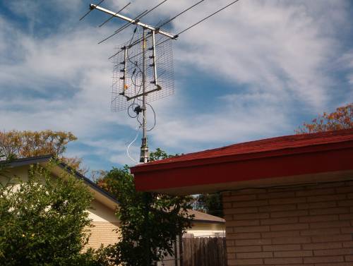

I live in Corpus Christi,TX am not far from my towers:) but they are all running low power.:mad: I use a CM 4228 for my UHF and a Antennacraft CS600 for my VHF with rotator and CM 7777 pre-amp, works like a charm. :)
