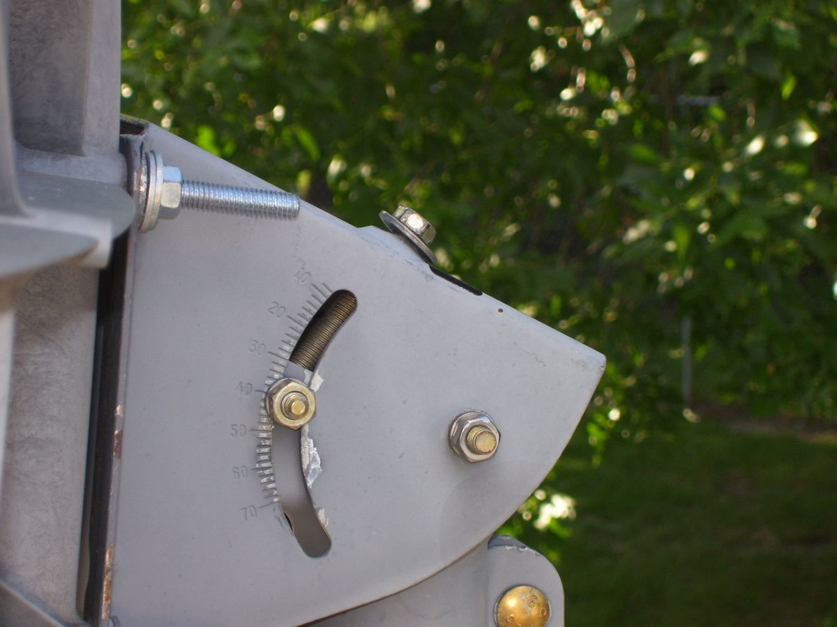

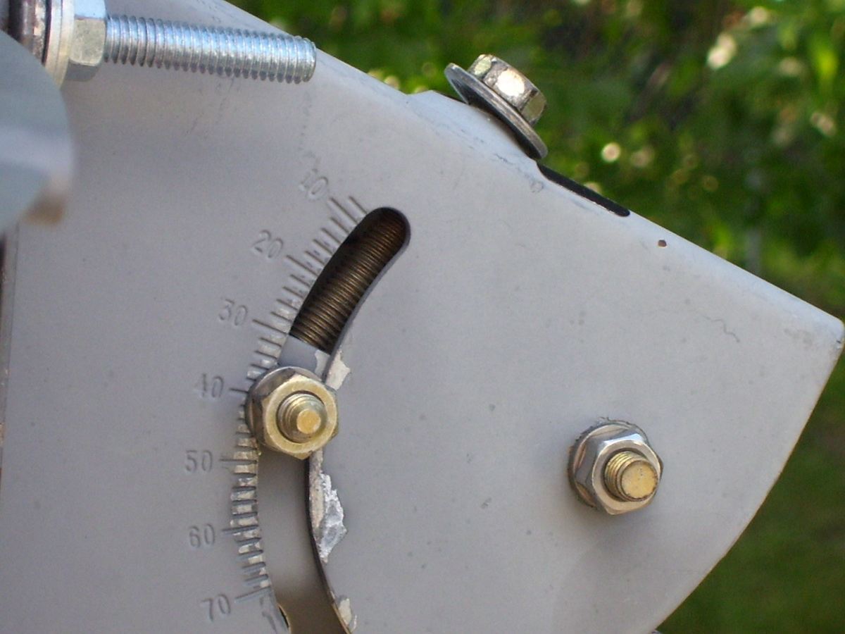

Could someone post a picture of the elevation scale and pointer of a Primestar
85E. I tried for two hours to get a signal on this thing. I may have the wrong
bracket for this dish. pointer is missing and elevation just doesnt seem right.
Thanks
Allen

I'll try to get you a picture of an 84E tomorrow if it's not raining by the time I get up!! I've got 2 of them , the standard mount/with elevation markings.
here is the one from my 84e...the edge is what you use
Aimed at G10 which is 30 for Minneapolis...looks pretty good :D

Oh man..No wonder I couldnt get a signal. I was thinking there was a pointer that went straight accross from the bolt like my .75 Channel Master. When I was at 34, I was only at about 25. Which also explains why the elevation looked wrong. Good Grief.
Iceberg.... Thanks for the pics. That explains a lot.
Thanks all
Allen
THanks for the pics Iceberg, it rained all day on me and I didn't go out in it. Never knew that about the 'edge' either lol, just thought they were waaaaaaaaaay off!
The mount on my 1 meter Channel Master has a pointer washer under the bolt, so it looks like some mounts use the edge and other mounts use a pointer...
The pointer washer is dead-on accurate, like the edge on Iceberg's mount :)
As we all know, Iceberg was correct. I hit the satellite in about 10 seconds using the edge of the bracket.

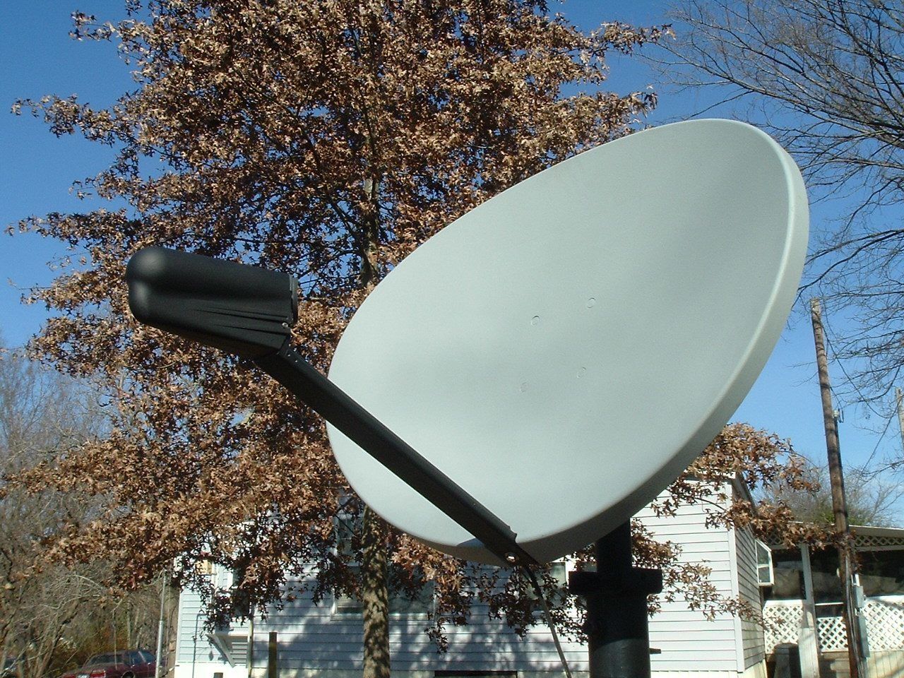

I really like the way the dish turned out. I wish I would have taken a pic before I started on it. It was really a mess. A guy at work had brought this Primestar to throw away in our dumpster. I caught him before he could accomplish that dastardly deed. Signals strengths are a little stronger on this dish that the .75m Channel Master. I would guess its because its a little larger.
I always like to look at other peoples finished products so heres a pic if anyone
is interested.
Thanks to all and especially ACradio for again comming to my rescue with an
LNB.
Just take your time. I think thats the most important. I started with "Simple Green". It does a marvelous job getting the crud and mold off the dish. Paint for dish came Home Depot. Dont use cheap paint you will regret it later. You get what you pay for. I matched the paint with a Channel Master dish. Its not Primestar colors, but I dont really care. I used a mini-roller to paint the dish. I've painted several dishes this way, and the mini-rollers work great. The rest is just Krylon flat black from Wal-Mart. Gave the arm and LNB cover a couple of sprays.
