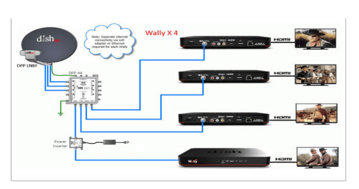

We had dish installed only ONE week ago. Last night we were all watching tv and they all lost signal at the same time. No bad weather or anything since getting it installed. We have tried doing the switch test and it’s giving us a reception error. Says switch None. Please help. Dish says they can’t come out until the 15!!!
That certainly points to an LNB issue or the dish aim changed. You need that tech to fix it. If you have 4 Wallys you also have a switch in the mix. Did the plug from the power inserter become unplugged? That could well be your problem.

we put in for a tech to come out but they can’t get to us until the 15th!! We are thinking it’s the power inverter or the switch that went bad. Satellite never moved and all the connections are tight and in the right spots. Just wish there was something I could do in the mean time. No Tv with 3 boys Is going to be horrible here comes the longest week of my life.
Check the power inserter. That would explain the issue.

He didn’t check them on the satellite. We have 4 wally’s. They all went out at the same exact time.
They all went out at the same time because somebody unplugged the power inserter. It’s going to be behind one of the TVs or maybe if the switch is in the basement it could be down by the switch but that’s what happened, I’m willing to bet

Our switch is outside I don’t think it has power to it. Just has the wires from the dish then wires coming into our house.
