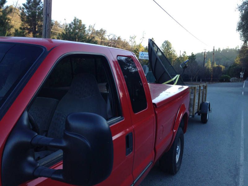

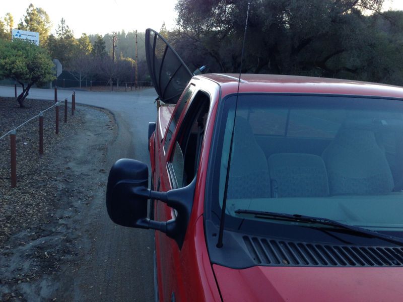

Here is a 10' in the back of my 10' trailer. Used the trailer side rails to support to not to tweek the reflector. Many members have also hauled flat with a bit of overhang...
If the seller still has everything connected, park the satellite on a specific satellite before disconnecting and take note of what satellite was selected. Since the dish will be hauled a short distance, the elevation/declination angle settings should not need to be changed. Just in case bolts are loosened, mark the elevation and declination angles on the mount with chalk or a Sharpe. If the motor needs to be removed for transport, mark where the actuator tube is clamped. These simple steps will help get the dish installed, aimed and simplify the transplant. :)

Thank you for the pics and info, i do know that he has cut the cables and has no knowledge of how it worked so what the heck. It just adds to the fun.
i'll take a ride out there sat and see what i can do.
