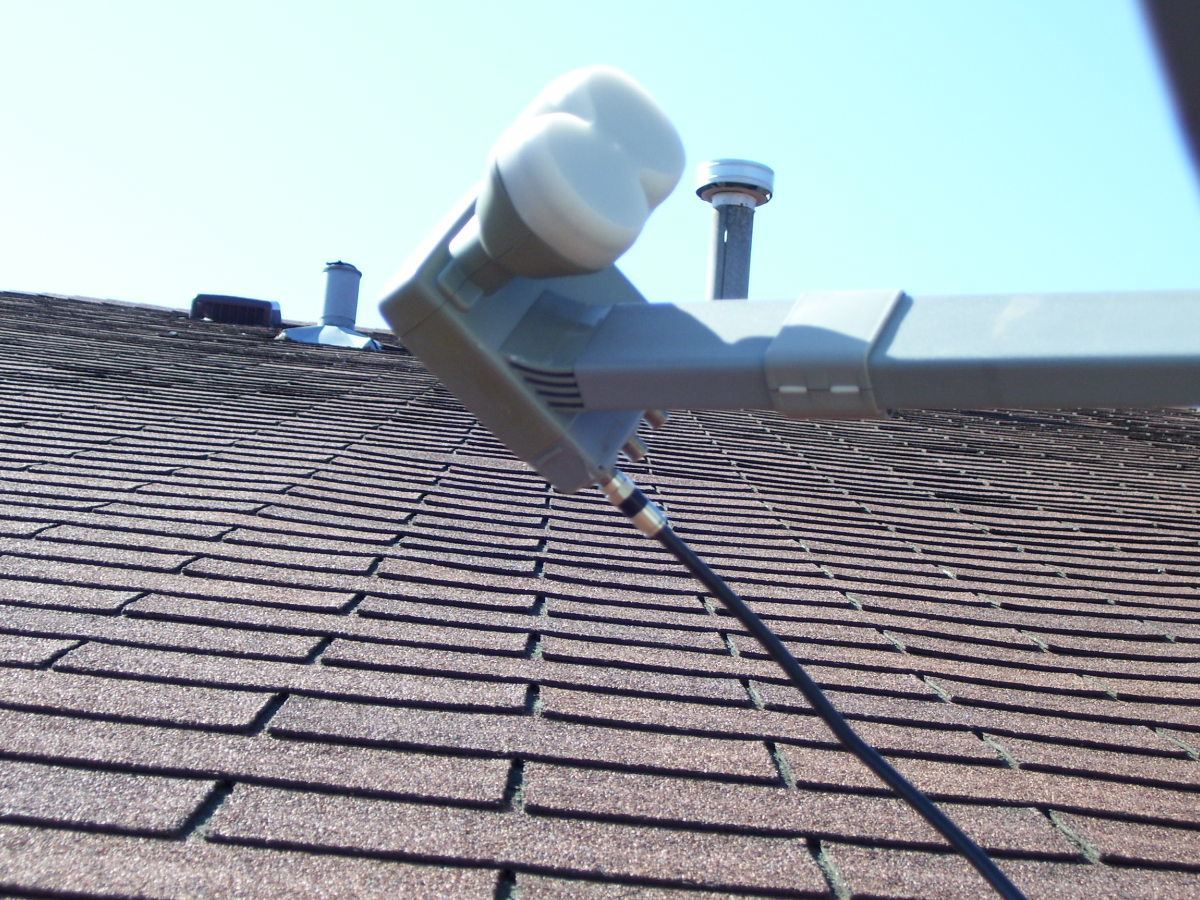

IF you are in front of the dish facing it, LNB skew needs to be CLOCKWISE
see my pics below how the LNB is... (I'm using a StarChoice dish but thats a moot point. See the LNB skew)

thanks Iceberg for the pix. thats the way my lnb is skewed.
