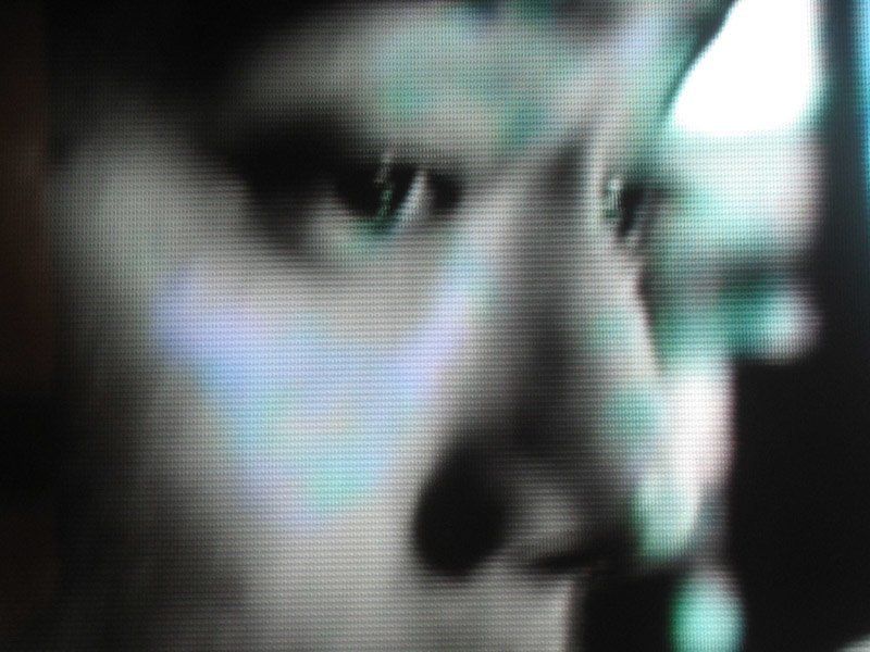

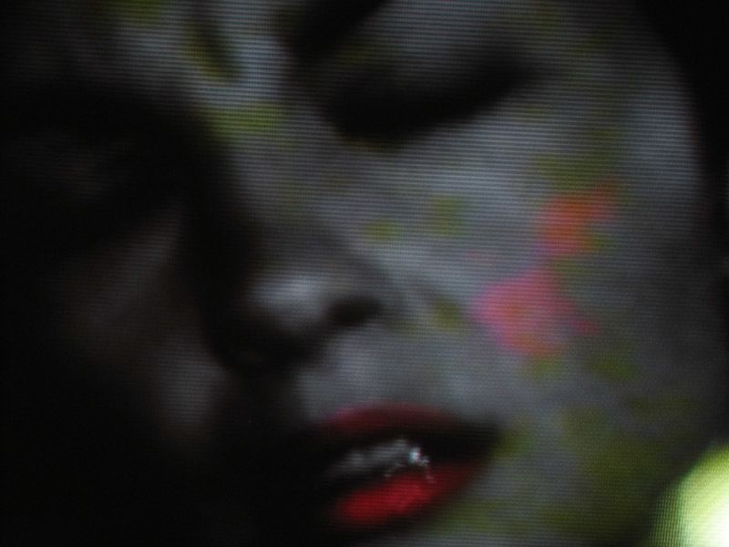

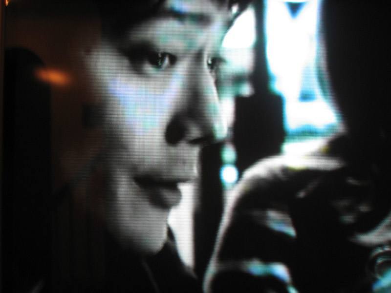

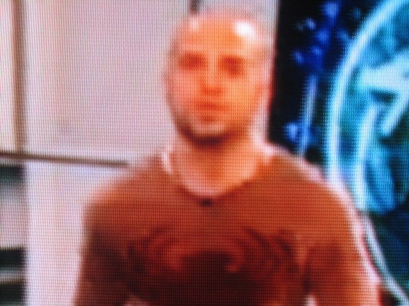

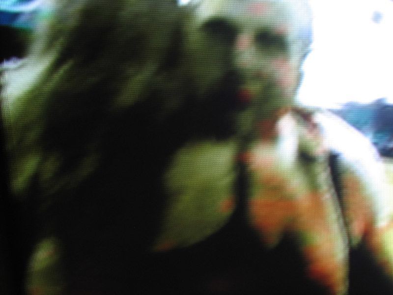

then if it isn't the dish or the wires or install then why did this not happen until they put the second dish up and Why is it happening on a brand new r-10 dvr and on both types of tv's? this is why i am questioning this? I want to get to the bottom of things guys, I want to fix this issue. I would have anyone who wants to come over and look at this come. I want it to be fixed. It cannot be the receiver..or the wires and if it is that would be great cause I could just switched those up and have this fixed....but i have tried everything..av cables, s-video, new dvr, old dvr, new hughes receiver downstairs, everything. I have to buy these r-6 cables and put them from the dish right through the front door and into the dvr and see what that does.......question is guys do i have to have 2 wires? cause I will go down to radio shack today and try that....

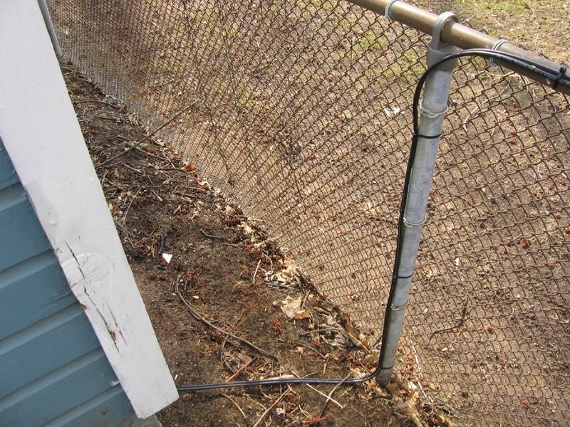

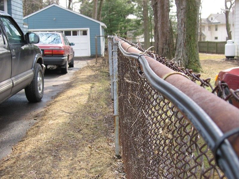

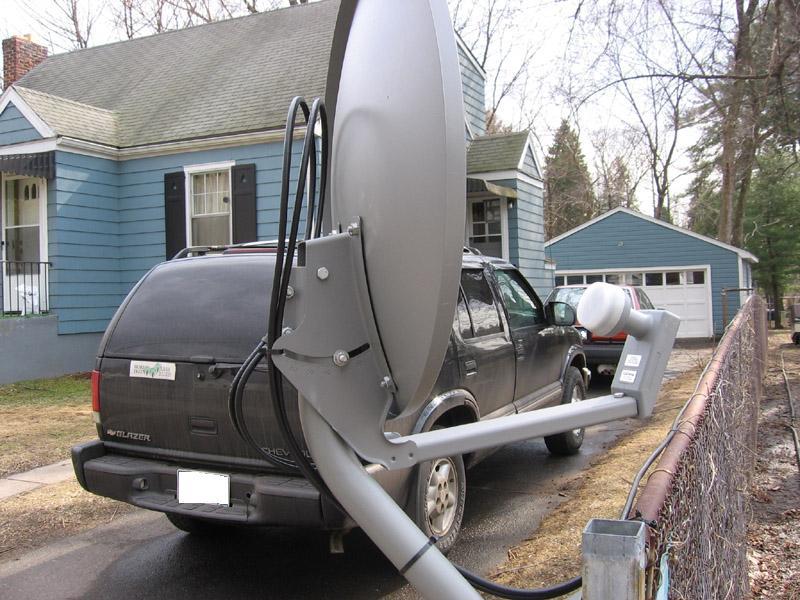

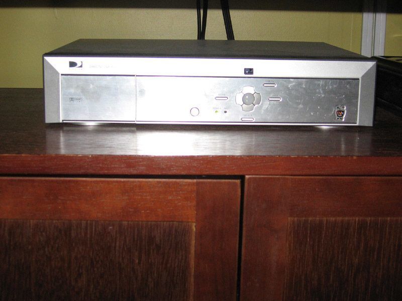

Phil, Dead link above me. Send it to me (or anyone else) if you want us to post it for you. I also resized those previous photos to 800x600 for those that might now have a viewer that will do it automatically or will just view them in their browser window. Seeing these I am still leaning to replacing that receiver.

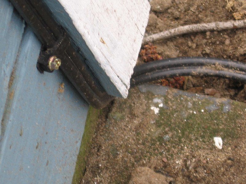

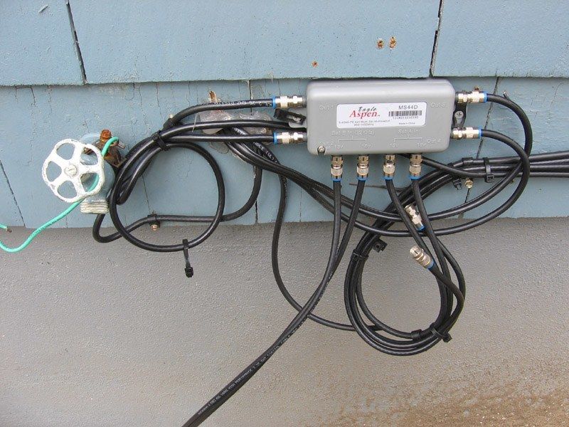

looks like the ground is not connected
an hsp did this????
BBBBWWWAHAHAHAHAHAHAHAH
you guys have no right saying anything about the MSP
HALSTEAD, APEX, B&A yeah they are REAL pros!!!
Yes that is a jacked up install, but just like the boss said no matter how sloppy the install is, the problems he is having has nothing to do with the installation just like he has been told on all his other posts. This problem is starting after the reciever.
I've had to go clean up installs like this before and they are usually the product of tons of techs going out and getting frustrated and just leaving it.
This problem should have never went this far. We are all looking at this as jpegs but a tech onsite should have identified this instantly and never had a need for all the different techs going out there.
Well my guess would say the problem is the receiver or beyond. After the receiver leaves a connection cable and the TV.
I had a picture like this one time- I freaked out and checked my wiring- I was using a S cable on a Sony T-60/Tivo- one of the prongs were bent in and missed the connection. I straightened the prong and reinserted the connection. No problem- Also, it looks like the ground is not attached or secure. Try securing to a hose bib?:confused:
