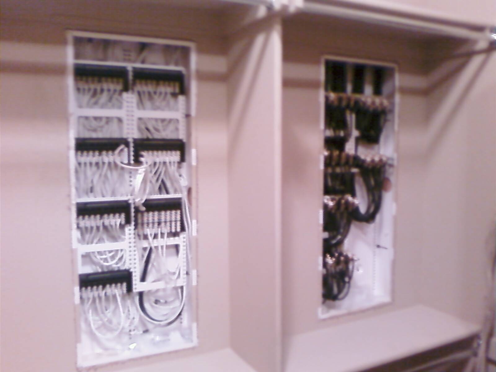

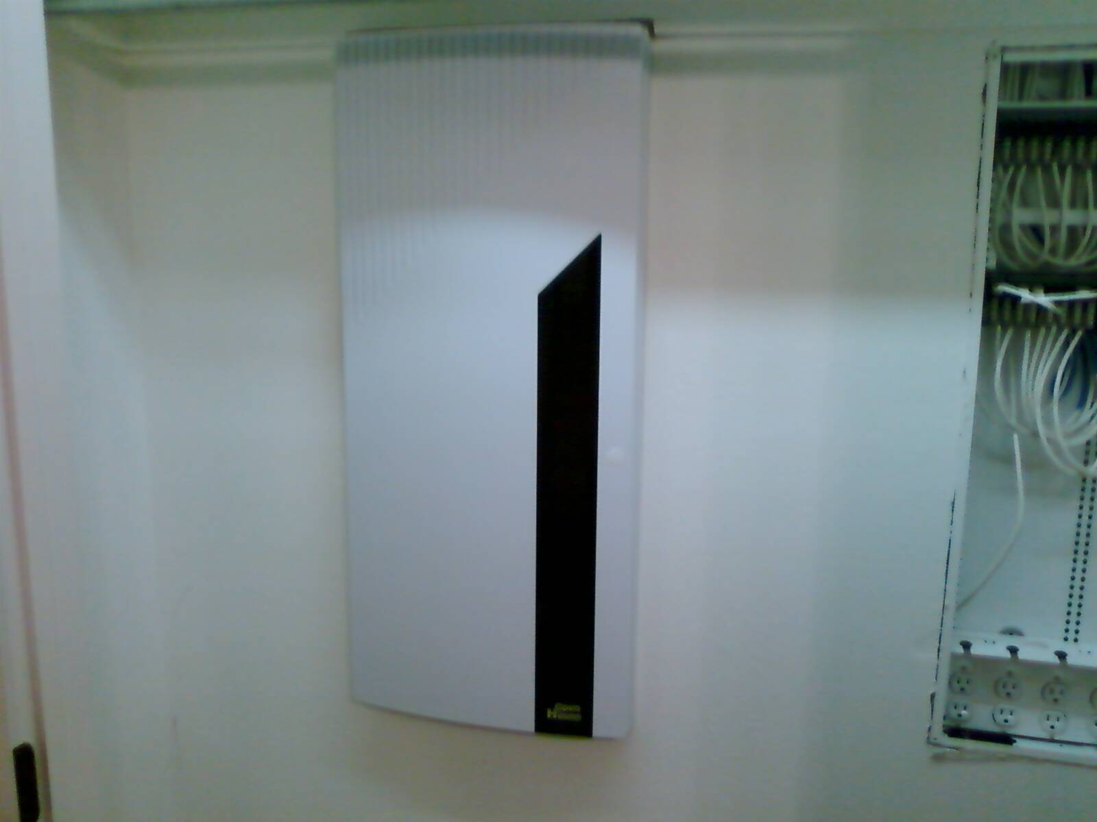

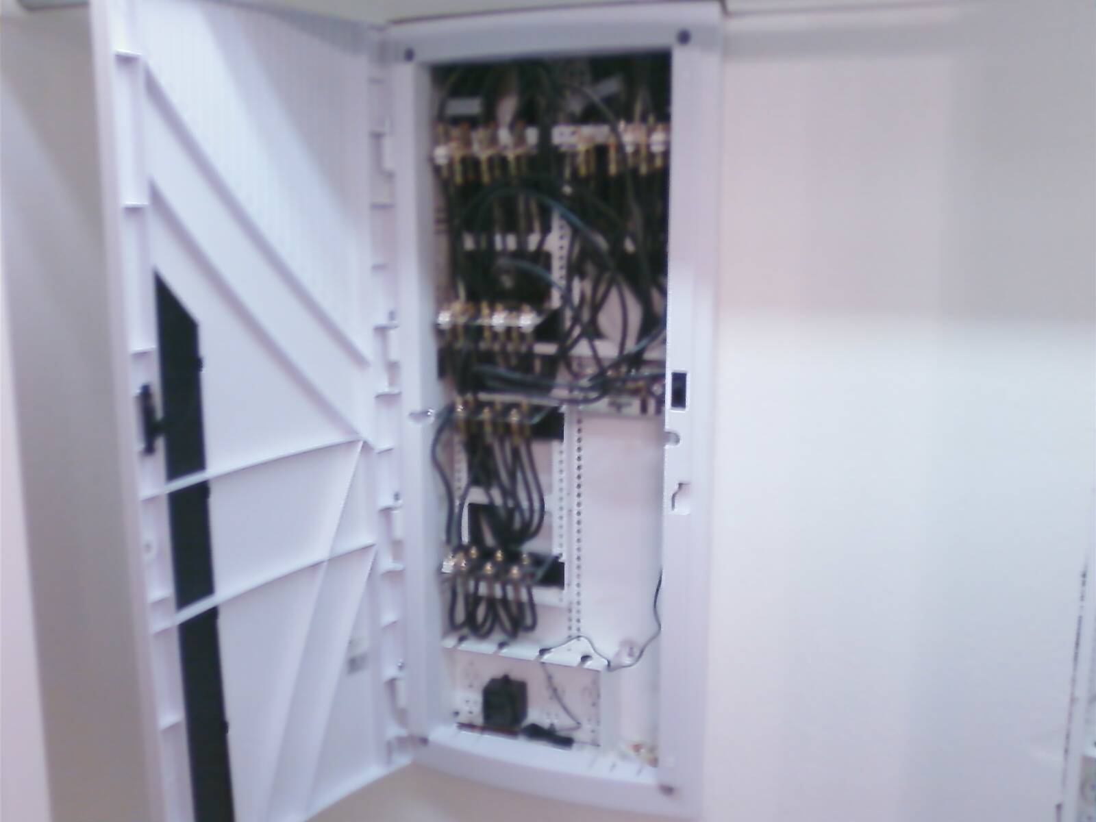

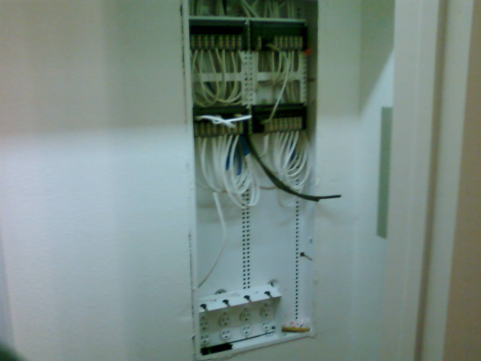

Minimum of 2 RG 6 and 2 Cat5/6 to each room from a central location are the minimum that I do. I also run 2 RG6 cables from the central location to a mounting point outside for a satellite dish and 2 RG6 and 2 Cat5/6 outside for cable/internet/phone. I would prewire speaker wire for rooms where surround sound is wanted to. I tend to overwire because I have a lot of equipment and its easier to do before the sheetrock goes up
I also had electric wired to the central locations too for power for amps, routers, modems or whatever may go there.
I normally use Open House products for enclosures, wall inserts, mounting hubs etc..
http://www.parts-express.com/brand/open-house/316
http://www.parts-express.com/open-house-h336-enclosure-14-x-36--182-704
These are the ones I did a few years ago for my sister and dads new homes
