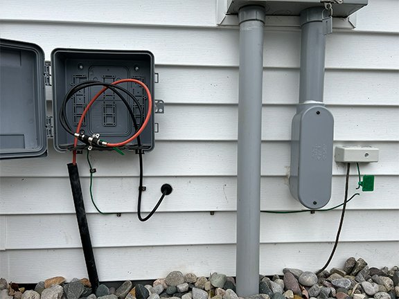

I checked inside the Spectrum install box on the outdoor side of the house. All the cables are normal and the ground wire, which is green, is still connected. The cut is outside the install box between it and the connection points for the house ground.
I looked in the basement anyway, since there's no way whoever did the cut, was in the house. In the basement the two-way splitter is right there with both cables normal.

The "right" thing to do would be to disconnect the red cable from the grounding block and walk away.
What does the green plastic tag read?
One side is blank, the print side reads line-for-line and is all caps....
WARNING
DO NOT REMOVE
THIS GROUND WIRE
SHOULD IT BECOME LOOSE
OR NEED TO BE REMOVED
CONTACT LOCAL CABLE TV

Im assuming its detached at the pedestal? But agree why didnt they keep the coax attached at the home? None of it adds up completely.
I also assume that is the standard procedure to prevent signal leakage from a cable that may or may not be terminated at the residence. This doesn't remove the Spectrum coax as a possible source of stray incoming current, and that's where this boggles.
They did. See the photograph.
