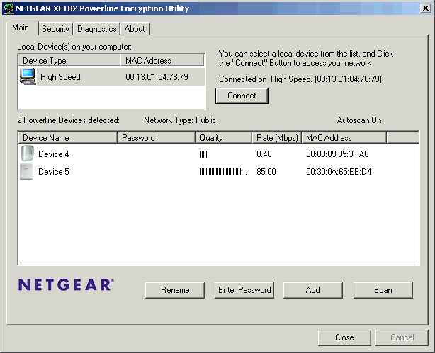

Sure, Take your PC and install that utility software on it. Then plug your PC directly into the ethernet jack of the PLID. Run the utility and see if it can see both 622s. If your PC is a laptop, you may be able to move the PLID around to other outlets in your house to see if is possible to see both 622s from any single convenient location. Also if you don't ever see the 622 #4, try taking your PC and PLID to the same room as that missing 622 at see if you can at least see it when the PLID and the 622 are right up next to each other.
Use the IP screen from the working 622 to determine its MAC address for its homeplug chip. That way you can tell it from the other one in the utility.

I did hook it up to the laptop, and could see various different HP stuff depending on what outlet I'm in.
I'll try to diagram it up, and post over the weekend with MAC addresses, etc.
