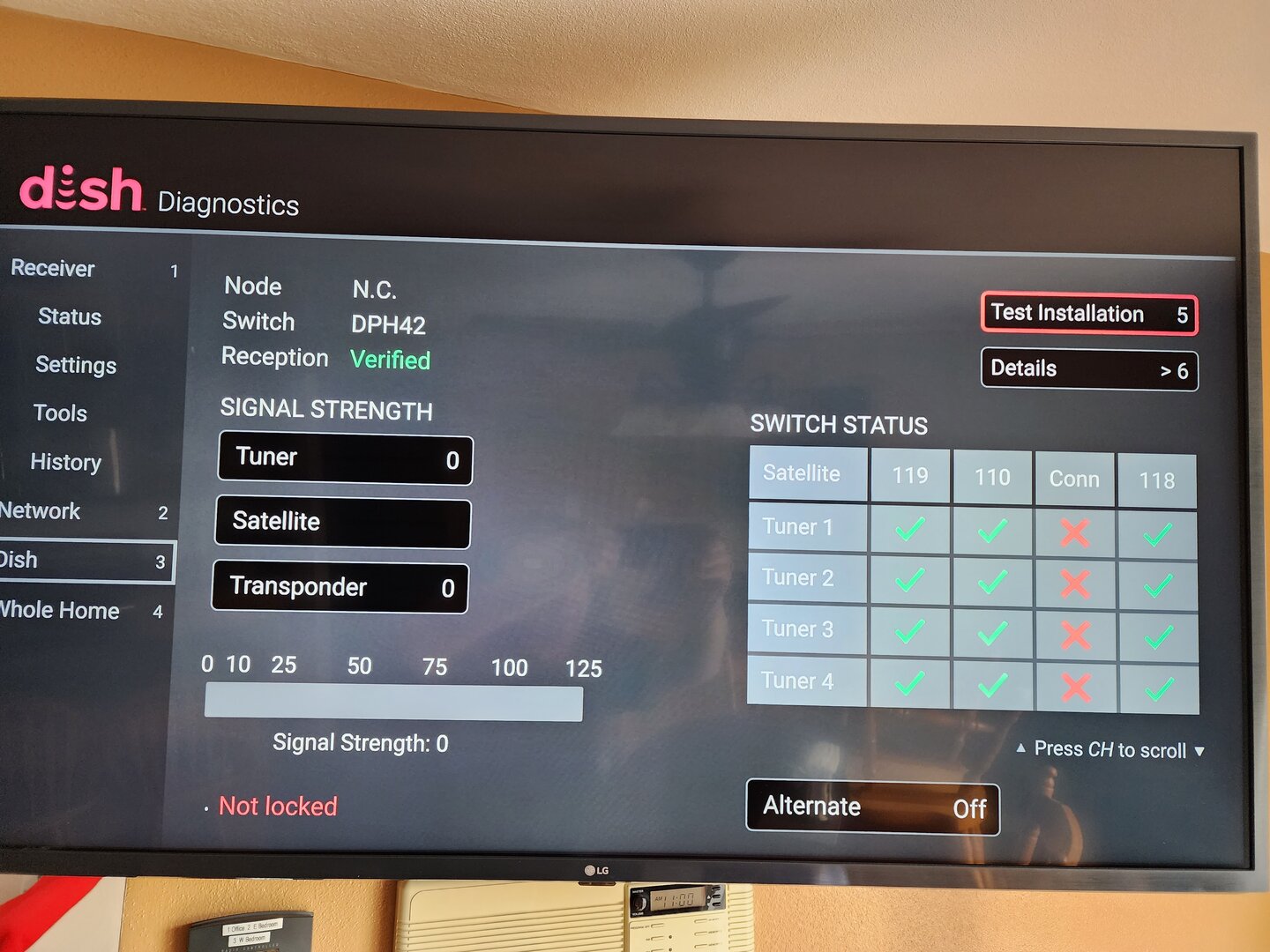

In my Hopper Plus check switch menu I cannot see the satellite and transponder info & there is a red not locked displayed. Tried everything in post #2 and get it to work. But, when I back out try to check the transponder again I get the red not locked again. See pic. The channels all work OK. My Hopper 3 does not have this issue.
If your channels are working then nothing to worry about. Occasionally hoppers will stop displaying info properly in the diagnostic screens. Usually a reset will fix that though. Also the hopper plus itself doesn't receive satellite signal or perform the check switch, it's still done by the actual hopper it's attached to.
