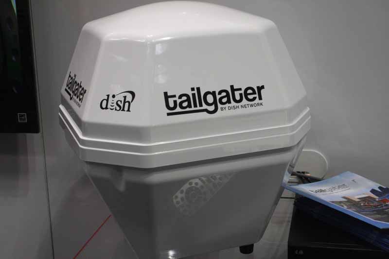

Is the wally easily compatable with new installs? my grandpa is getting dish in 2-3 weeks and he is getting a hopper 2 and a joey and i would like to get a wally for myself and would like it to be as easy as plugging it in(i dont want to have to change the install up like i would with a vip). also is a wally compatable with the origonal tailgator made from around 2010-2012? i have an image attached so you know which one im talking about. the reason im asking if its compatable with the tailgator is cause the wally has 2 tuners and the sat has 1, another reason im asking is because the portable sat is from 2010 and the wally is from 2018. if it will work with the tailgator, how would i make it connect and setup, or is it as easy as plug and play and changeing some settings?

And yes wally is compatible with all tailgater models.
