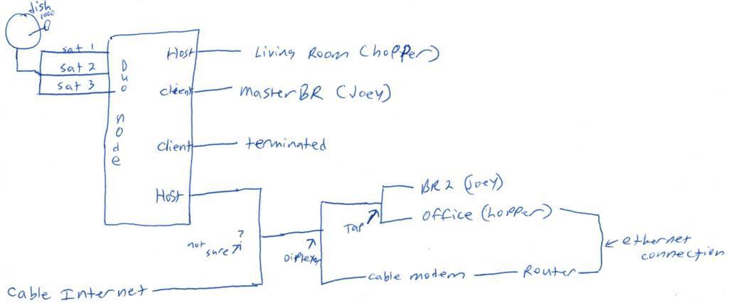

Well, after 5 hours with a tech this morning trying to resolve the lack of the drop down menu, nothing has changed, tomorrow they are sending out a more qualified person and hopefully will get resolved. Status: All Joesy's and Hoppers are working but no ability to watch DVR events from one hopper to another.
I was having that problem as well but 216 fixed that. Sorry to hear its still not working for you
Did they check to see if Bridging was enable??
Bridging has been set to off, been set to on, been set-up as one ethernet connectionsto one Hopper, two ethernet connections(both Hoppers have ethernet). So far nothing has worked. My set-up is as follows...
I am not 100% sure what is inside the box outside(where the question mark is) Part of the problem is we only have 3 lines coming into the apartment from the outside and no option for a 4th. So somehow we need to figure out how to get it to work. Tomorrow I think we will be rafter climbing making sure there is no isolators or anything that is not compatable.
is your cable internet sharing the host line coax with the hopper/joey system? If it is shared, that sounds like it could be an issue as it should generally have separate coax. I would try it without that splicing in between to see if everything works correctly.
They disconnected the internet today and put a barrel in and still no luck with the DVR sharing, even after restarts. There is also no other alternative for running a 4th or 5th line into the house to keep everything seperate. I was told that they should be able to share the line as far as frequencies goes the Dish set-up is differant then the Charter set-up. Or so I was told by the initial installer. To date everything else has worked just fine other then the DVR sharing. Minor connection issues with joeys, but mainly when we first hooked it all up and then when we started playing with the ethernet/moca settings. They came back, just took a little while some of the times. Mostly when trying to run the moca on everything. I tried having the installer try the HIC but he wouldn't He had it inside but said since everything else is showing up as connected that we wouldn't need it. Also the only way for me to have internet and have the Joeys see both Hoppers seems to be by having bridging enabled and two hoppers connected via ethernet. When the Bridging is disabled and only one hopper has ethernet, the Joeys can only see one hopper, and the hoppers cannot see each other. As a side note, when I go to the whole home, I can see the Hopper in Living room from the hopper in the office and I can switch between hoppers from each joeys (with 2 ethernets connected)
The cable modem and diplexer are the problem. Cable/OTA/Internet can NOT be shared with the Hoppers/Joeys after the node. I have also seen that diplexing before the node is not always successful either.
so would putting the Hopper in the BR be more effective? And then just having the two Joeys on the same line as the cable internet? or how else can it be wired without adding anymore lines? (3 max into the house)
Neither the Hopper nor the Joey can be diplexed. Looks to me like your only option is sacrificing a Joey line for the cable modem.
OR maybe diplexing one of the lines from the dish, bringing all 3 lines to the room with the cable modem, diplex the line again, hook up the lines to the duo node/cable modem, then hooking all the Hs/Js to the duo node. Probably easier said than done. Even at that, no guarantee that it will work. As previously mentioned, I have seen reports that even diplexing before the node kills the MoCA signal.
Is there some reason why you couldn't put that joey directly connected to the node on a splitter after the tap with the other joey? or maybe use two taps to consolidate wiring?
you'll be better off if your config matches something in the wiring diagrams for the long run.... see here for examples on how you might change up the wiring: http://www.satelliteguys.us/hopper-zone/279755-hopper-joey-wiring-diagrams.html
