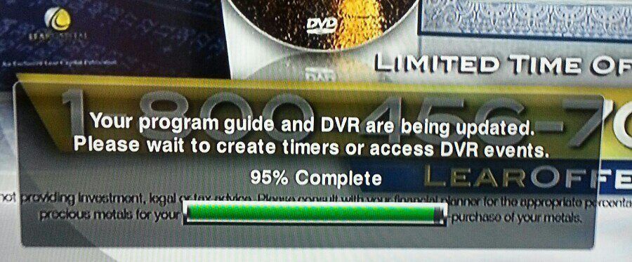

However, we've been sitting here with the following message for 30 minutes: "Your program guide and DVR are being updated. Please wait to create timers are accessed DVR events." It seems stuck at 95%. We're waiting on that before connecting his Sling Adapter & external hard drive. Is it typical to take this long?
Sent from my Samsung GS3
