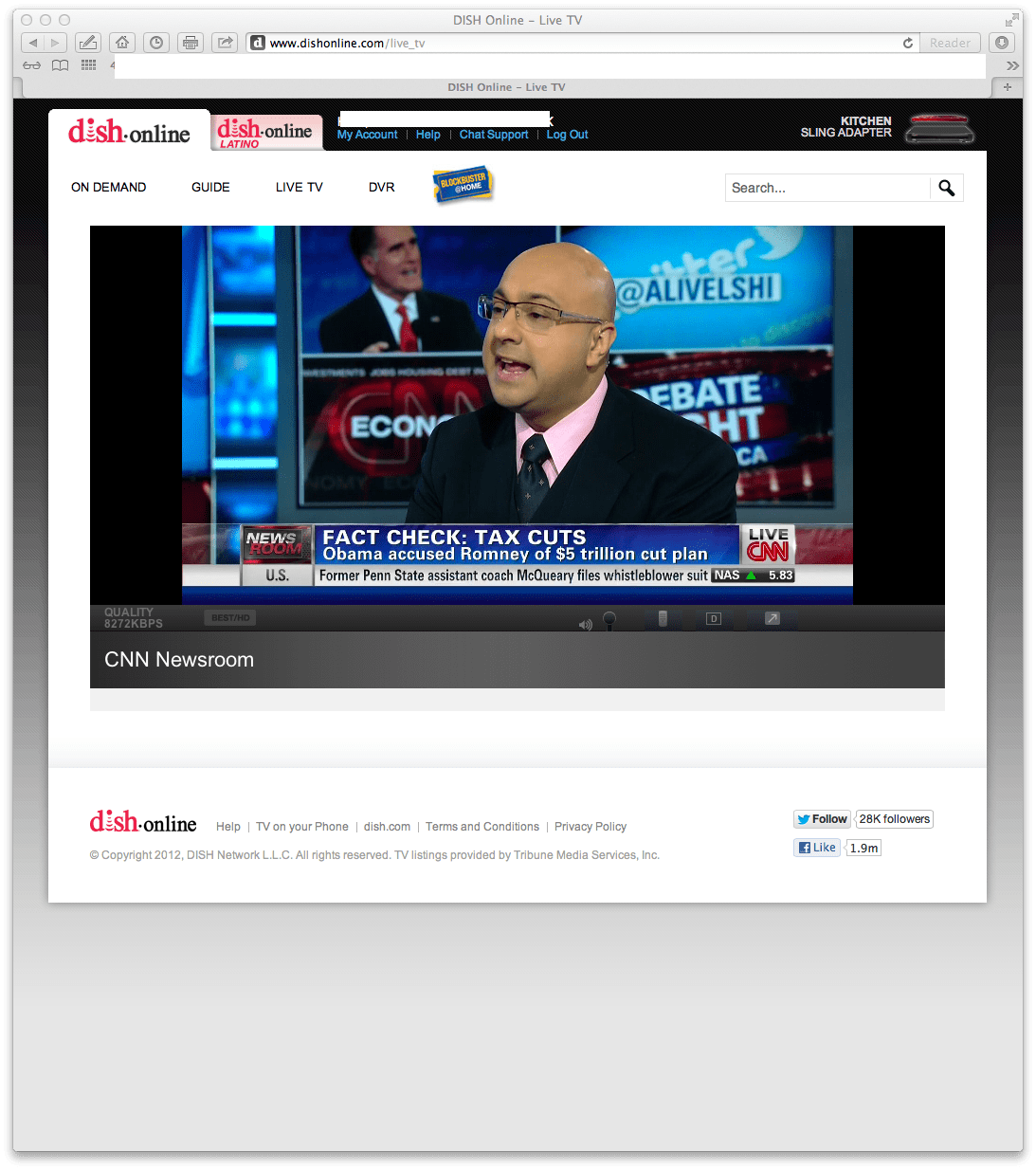

Anybody else notice a different setup on the Dish Online viewing page? On the screen the virtual remote has returned... the KBPS has moved to the left....noticeably less crowded control panel......things seems to be changing, hopefully for the better. :popcorn
Still use Dish RA. Dish Online has never worked right for me. Only problem I have and it's on both systems is getting the timers to show. If you add a timer they will all appear.
The control bar has changed....sometimes, other times the usual bar and controls appear....when clicking on the remote icon the old virtual remote appears in this version....:eek:
