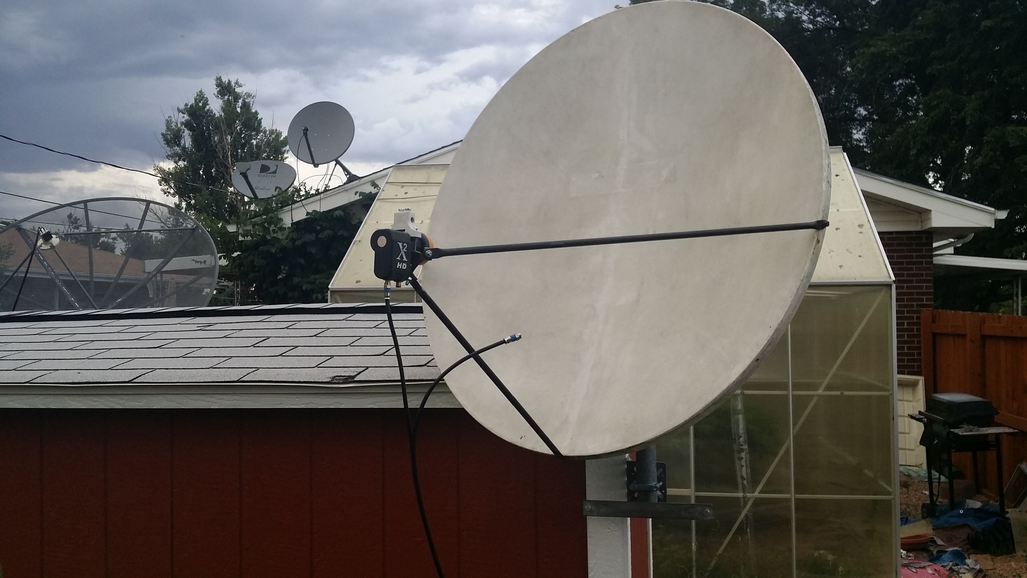

How can I stack LNBs on this?
Its a 1 meter dish as far as I know.

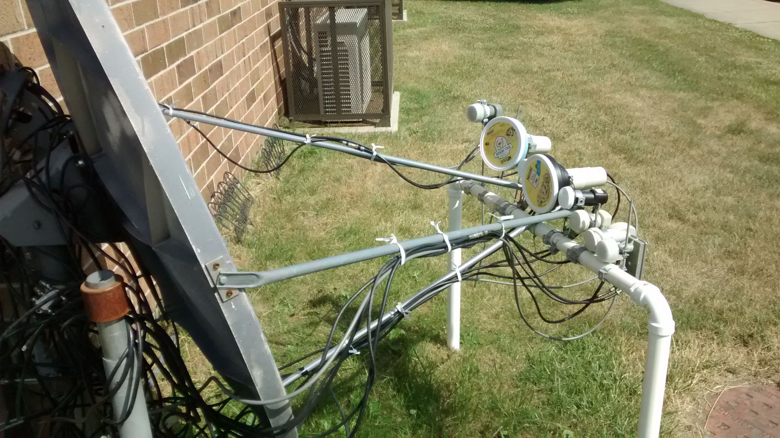

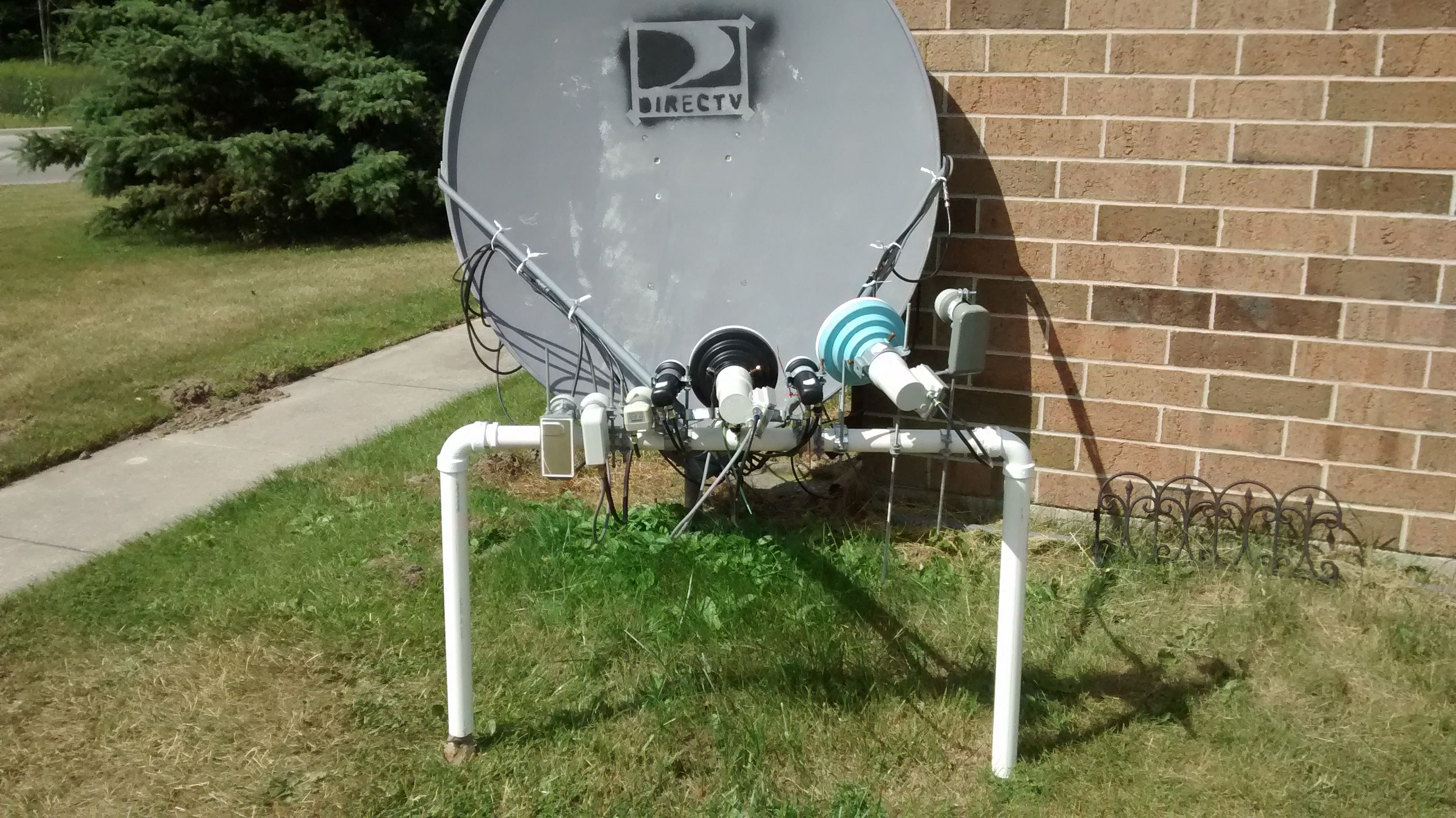

I haven't gone as far as Mike Kohl or Danristheman, but started down that route...
Here's some of my experimentation for multiple LNBFs on one of my 1.2m that many members here provided input upon (the link goes directly to the successful part, you can scroll up or down from there):
http://www.satelliteguys.us/xen/threads/my-first-multiple-lnbf-setup.344711/#post-3582816
There are several photos and additional links in the above thread that you may find handy.
You might be interested in this thread (also linked in above thread):
http://www.satelliteguys.us/xen/thr...-whole-ku-arc-with-fixed-dishes.159936/page-3
