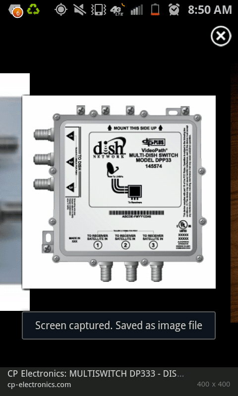

Its a Tad bit hard to cascade DPP 33 switch he's since they don't have passthru ports.......
One 44 into a 33 yes. Not more than 1 33 though.
See picture
No pass thru....
