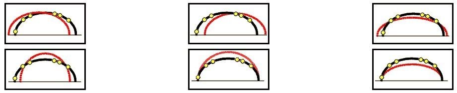

Picture is worth 1000 words. Which one of following applies for your installation?
