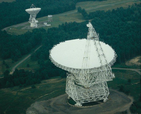

Here you go... one for 110° and another for 119° on Dish.

Regrading the huge dishes pictured here: ummm, you might want to check with your local zoning board. For starters.
