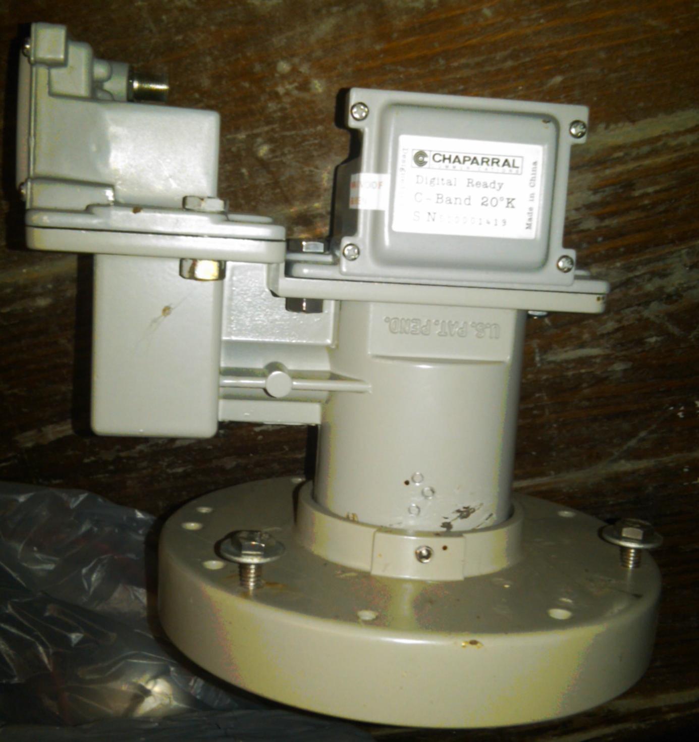

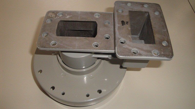

Here are several pictures of the Chaparral C-band only feed, from various angles.
First, a view that the dish sees of the feed, minus LNBs.
Second, a view of the backside, showing where the LNBs bolt on.
Third, a side view of the whole assembly, with LNBs attached.
