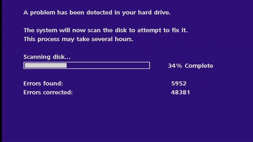

This Can't Be Good...
Noticed my HR20 has been on internal, but haven't had time to check... Found it doing this, this morning on the external...
Yeah going to let it do that for a little while before checking the drive with a utility (probably lose everything on it anyway)
Let it go Don, see what happens, could be that there were some errors and it WILL fix them.

Mine is a Seagate that has worked for fine about 2.5 years ;) this is going to take awhile... its at 44% now... good thing I have Dish also while I see if it survives... I have a WD EHDD that lost all programming with this receiver that has worked fine with my Dish dvr for over a year...
You're in luck then. When the 2 year old seagate 750gb drive started to crap out, I couldnt copy it. So we had to start it up, watch as many shows as we could until it started stuttering and freezing, turn it off for 10 minutes, and try again. We finally watched almost everything off of it after about a week of that, and I put a 1.5tb WD/AV drive into it. Since then we have a hard time getting it under 85% free...
