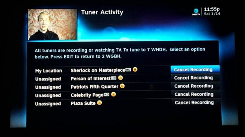

I just tried with the first five channels. When I tried to go to a 6th channel, I got this:
Sent from my SM-G920V using the SatelliteGuys app!
That is what your suppose to get, your recording 5 channels and its telling you, you can watch a recorded show or one that your recording.
There is no 6th tuner so you can't go any further is what its saying.

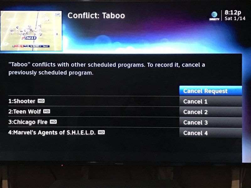

Yes, exactly. Why does the OP only have 4 shows showing up and what is the buffer he's talking about? If there's a buffer, a tuner is being used somewhere...

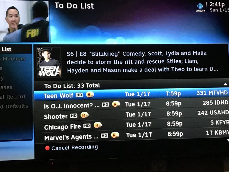

I pad my timers so I don't miss anything at the end by 1 minute. It won't record five scheduled shows at once anymore as it seems to be saving the my location tuner for live tv. It will record five things at once if done manually. It's not that big of a deal with shows that repeat later on. It's network shows that don't repeat that can cause a problem. I've had to move a few over to record on the HR24.
And in your picture none of those shows overlap causing it to use another tuner ?
I would think if there was one that overlapped, it would show that show as well.
Wait a minute, I just looked at the photo he posted, he is recording 5 things at that time and it looks like he's asking to View Channel 7, which he cannot do because all 5 tuners are used. That's why it's asking for him to cancel a recording program.
Looks to me like he is recording four shows, watching football, and wanting to record Taboo. That would be using more tuners than he has.
it was in the "To Do List" for this upcoming Tuesday night. It did however pick up the later airing of Taboo, I don't know why it won't record the fifth show.

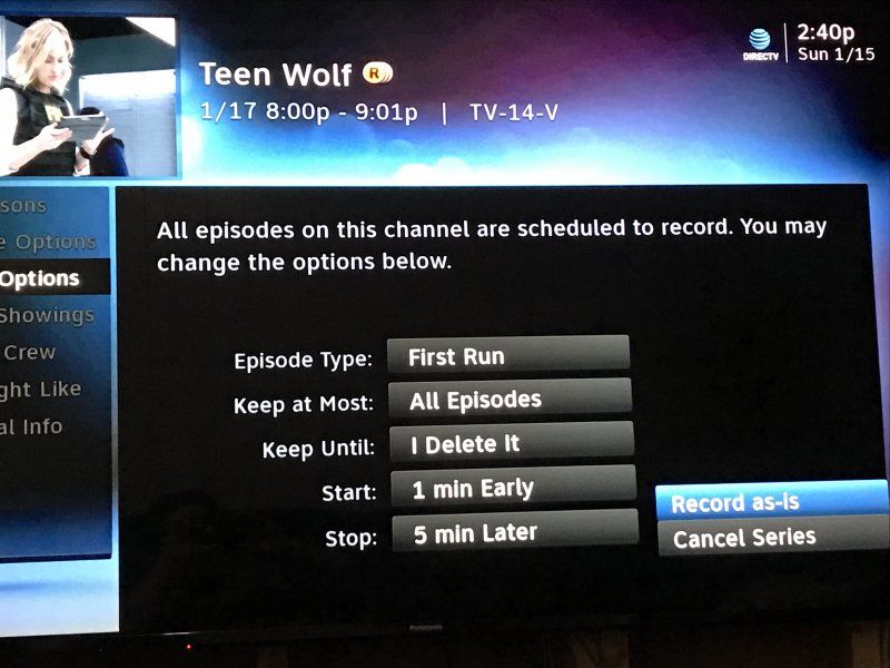

I think I figured it out. Somehow Teen Wolf was set to end 5 minutes later and not 1 like I normally set.
So in this picture you have Teen wolf Starting at 7:59 and ending at 9:05.
So yes, that looks like your issue.
I'm presuming the other shows all start at 9 and your setting them to start a minute early.
