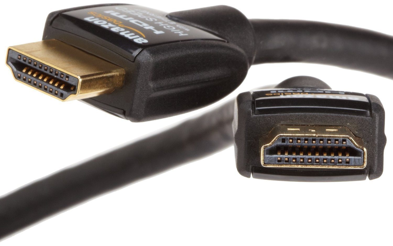

I have not had any jittery video with my Denon AVR-1612 and HR44/700. I am just using this HDMI cable for all of my equipment connected to my AVR, but in the shorter version The longer one that is linked, is the one I am using between the AVR & tv. http://www.amazon.com/gp/product/B003L1ZYYM/ref=oh_details_o04_s00_i01?ie=UTF8&psc=1
I'm using similar cable. Got all new of the latest tech when I got the 3D DLP set.
