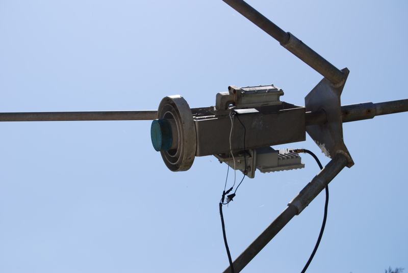

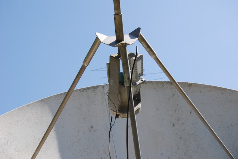

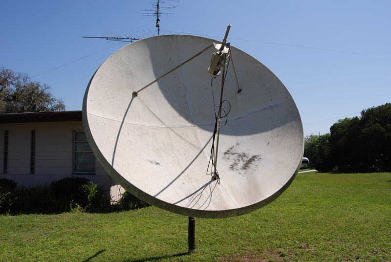

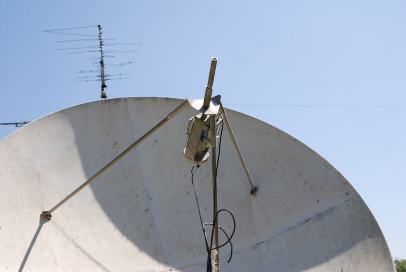

On the other hand I got a very rewarding experience while driving there! Lo and Behold I found a Solid satellite dish that appears to be around 10". Wires are not connected to it any longer. Looking really dirty, abandoned, and neglected. Knocked on the door but no body was home!! L I don't know if that is the way the feedhorn should look like or if its missing a cover?

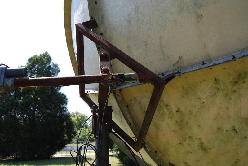

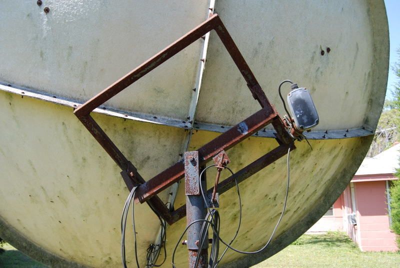

I think this might be a real FIND! I plan on going back there. If they do give it away….. Just how do I take it down so it won't get damaged? It looks like it has a heavy mount. Should I take the dish off with the mount? Or take off the dish the mount and then take off the mount from the support pole? The solid dish is put together with four sections. Do I leave all the sections together for the trip back here? Look at me, I'm getting excited just talking about it and I haven't even spoken to the owner yet! Keeping my fingers crossed!

I would unbolt the Dish from the mount (the big square part) first.
Then gently slide the dish down to the ground.
You will need help, it is HEAVY ! Like 2 people holding the dish while another person unbolts it.
Then you can separate the four sections on the ground.
Lastly, you can remove the mount from the pole. The mount alone is plenty heavy.
Just from a mechanical point of view, I would not disassemble the dish wedges.
If there is some way to transport the dish whole (even with the LNB attached), I'd think that would be a priority.
Of course, take it off the mount (that big square frame) as a first step.
And mark it carefully so you can get it back in the same orientation.
Looks like a beauty.

If it is fiberglass, it could go either way to being used for Ku. There is no way to tell how big the mesh is inside, so proceed with caution.
Edit: I just looked again, and it looks like it has a Co-Rotor on it. If so, it is probably ok for Ku signal.
hey tom. seen ur pictures of the satellite there and i see a corotor II on it. with c and ku band feedhorn snatch it up if you can it looks like a fiberglass one, my grandma had one just like it, if they dont let you get the dish see if they will sale u the feed, i will talk to u on line tonight when u get on more about it, it sure as hell is exciting to find things like this! good luck man am im glad u found one with c/ku feed there rare!!!:hungry:

That dish looks similar to several I see daily in the countryside near me, fiberglass and probably around 8' dia, most showing signs of serious neglect. Good hunting to you, Tom!

Well first I need to find the owner. :hungry: Didn't even know his/her name till I did a Reverse address to see if I could come with a name. Had to go to several sites but finally got the name for the couple. No telephone number, which means I will be there bright and early in the morning asking them about it. :)
If I do get it I hope! I will have help to take it down. It is a fiberglass dish. I will take it off the dish from the mount, leaving the feedhorn intact. Then the Mount. Not sure about the pole. After getting the other poles and seeing the cost that they were going for... I may be digging! I will have help too!:D
Good luck.
Hello Anole,
I'm not going to disassemble the dish wedges at that place. I may do it when I get it home and spray some WD-40 on it. Remove the rusted bolts and replace with stainless steel.
Then the metal frame will need lots of work. May take it to a place and have it sand blasted , Re welded if needed and repainted. Thats a great idea to mark the holes where it comes off to keep it in the same orientation.

Yes it's fiberglass
Is it metal or fiberglass?
From the back pictures, it looks like fiberglass to me.
Hey Fred,
I sure was thinking of you when I found this one! Yes it's fiberglass and from looking at it, I do want to be carefull in taking it down. I have never seen another fiberglass dish around here. This is the first! The wires are cut and just hanging on the pole! It's not being used and it sure is dirty looking. However I remember looking at your thread and the before and after shots of it. It sure did clean up well. I'm hoping that will be the case here too. Just gotta get to the owner and do some talking! :bow
I'm told it has KU band on it too.
Hello Phlatwound,
Not the case down here. See more of the mesh dish unless you're looking at small ones. This one is dirty. Has mildew all over it. I do think it will clean up good. Fiberglass looks good.
