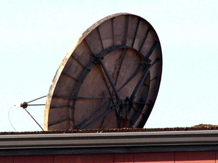

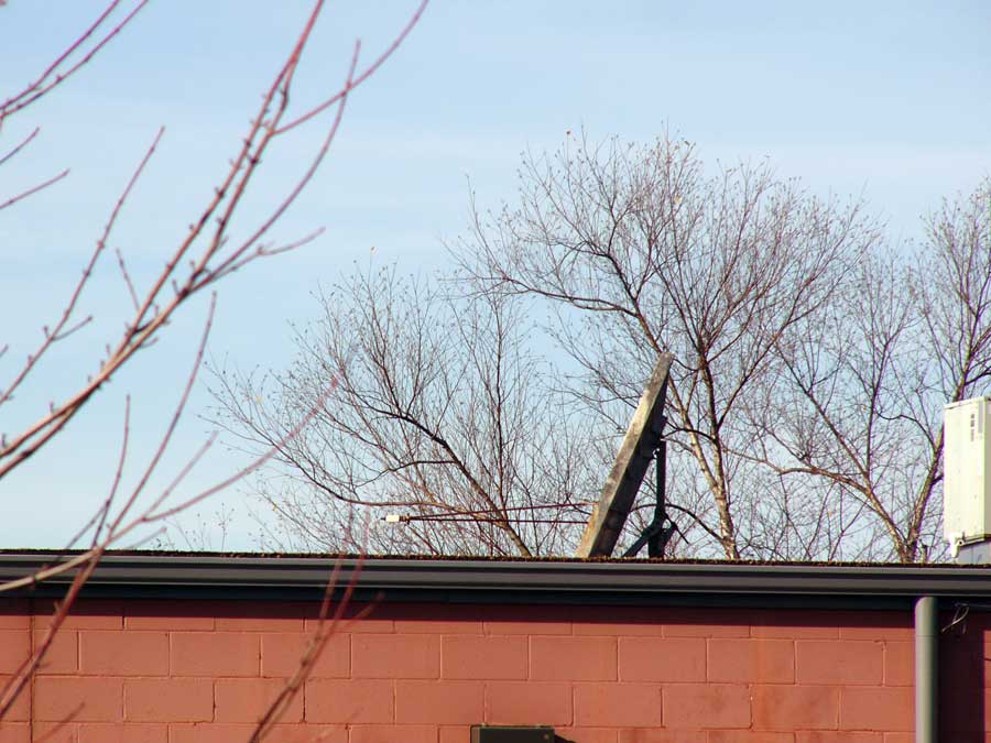

Pics added.
Looks like it does have a LNB. My camera sees better than me.

That sure looks like the classic 6' Prodelin dish.
The LNB support arms are not what you see on the two-way version... at least I haven't.
... and I've seen two types!
This looks more like a receive-only lashup.
The mount is strange, too.
Get us more pictures, closer ones. better lit ones, or just bring the darned thing home! - :up
You might be in for a surprise with the mount... just can't see well enough to know.
But, whatever you got, it's gonna be fine! - :cool:
