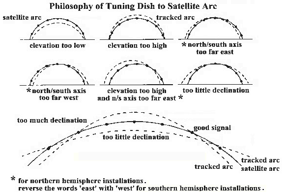

As you might know I have a C Band dish that has been giving me problems since I put it up. Sometimes it would hit part of the arc and not the other...
With some tweeking I could get the entire arc but the signals were low...
And so on...

I bought one of these years ago from Shaun Kenny's Green Sheet and used it on my 10' mesh dish. It worked ok, but it didn't perform miracles.
Lets put it this way, before my DISH was doing great, with high signals on most satellites and transponders of 70 or higher.. now they are all 40 or less. I was picking up 90% of the S2 signals up there now I get none.
I can track the arc and go from 72 to 131 with no issue, but can't get anything past 72, and I know I can see a lot further then that as I was hitting a lot of foreign birds when I was first setting it up. :)
Its off just a hair and I am not sure which way. I really wish I could fly Iceberg here but he don't fly. And I wish some of you guys lived around here but you don't. So I am hoping this will get me where I need to be. :)
Dish twisted on the pole. Easy fix. You didn't need to buy anything.
Have a look at this page, read number SIX on that page. Its your exact problem. you need to fine tune north/south alignment. Anytime your dish tracks part of the arc, usually the top, you have a N/S alignment issue.
