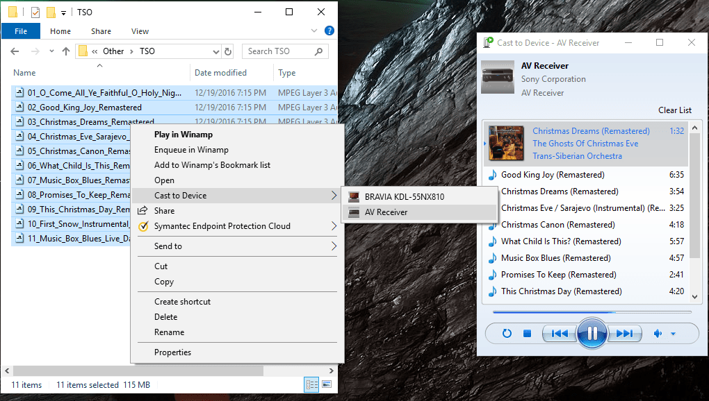

This is probably not as pretty, streamlined or automated as you want it to be, but it requires almost nothing other than a PC and TV.
I know DLNA is dead, but all of my hardware is DLNA compatible. On the rare occasion I want to watch a video file on my TV, I just right click on the media file, select Cast to Device and select my TV. Most of the time I do this with audio, and stream music from my PC to my A/V Receiver.
