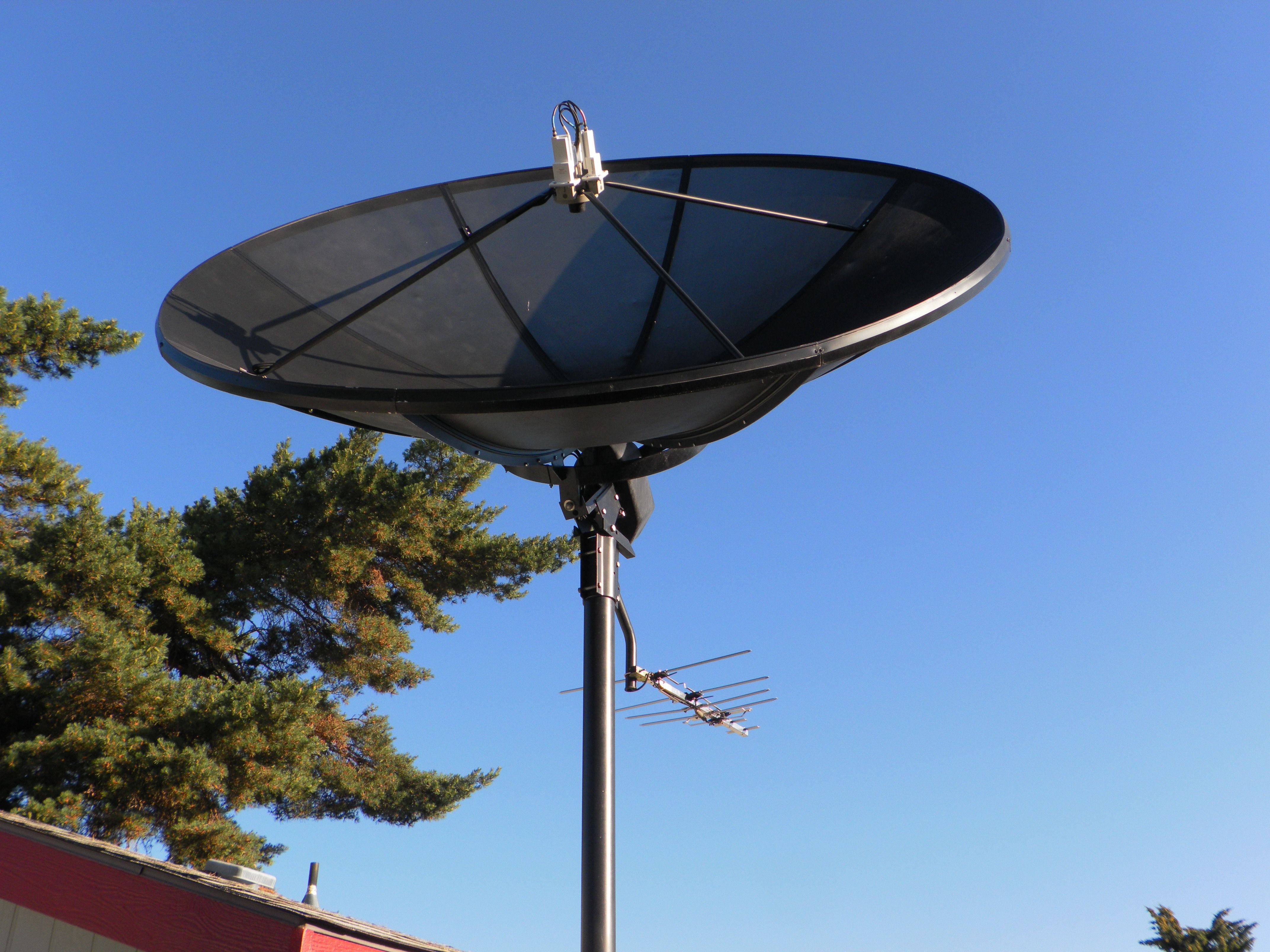

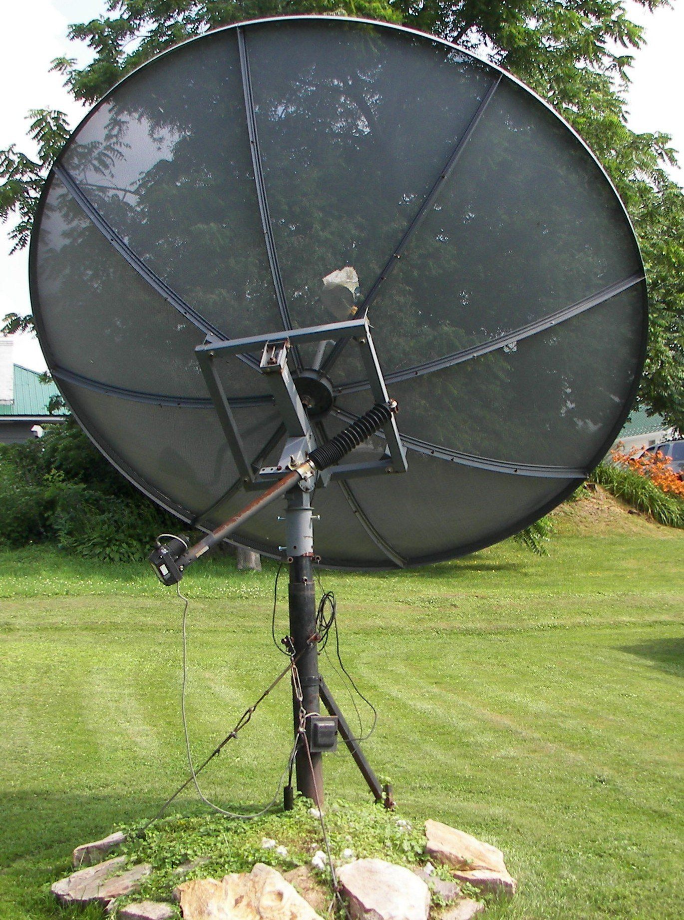

After sitting behind my barn for about 15 years,I finally put up my Pinnacle, to replace a rotted out steel mesh 10',about a year and a half ago.I basically just dusted it off and put it up piece by piece,by myself.Had to knock a few dings out,the original paint was more than good enough for me,a little rust on the mount and a few chips on the aluminum,but it doesn't bother me.
Using a 5? year old BSC621 C/Ku lnbf pretty much peaked for C,works fine, and Ku works at least on stronger transponders,I have other dishes for Ku.
Using a 24" Superjack,I think can't remember,that takes it from 139w to probably at least 30w but I'm not really sure,I don't get anything east of 72w due to trees,buildings and tracking may not be perfect,but 72 to 139 works great.
After just sitting there all those years I couldn't believe how much better the Pinnacle was compared to what it replaced,and I'm considering back to when the steel job was in good shape.Plus I still haven't gotten around to really giving it a fine tune,I'm lazy and you just can't rush into these things. :D

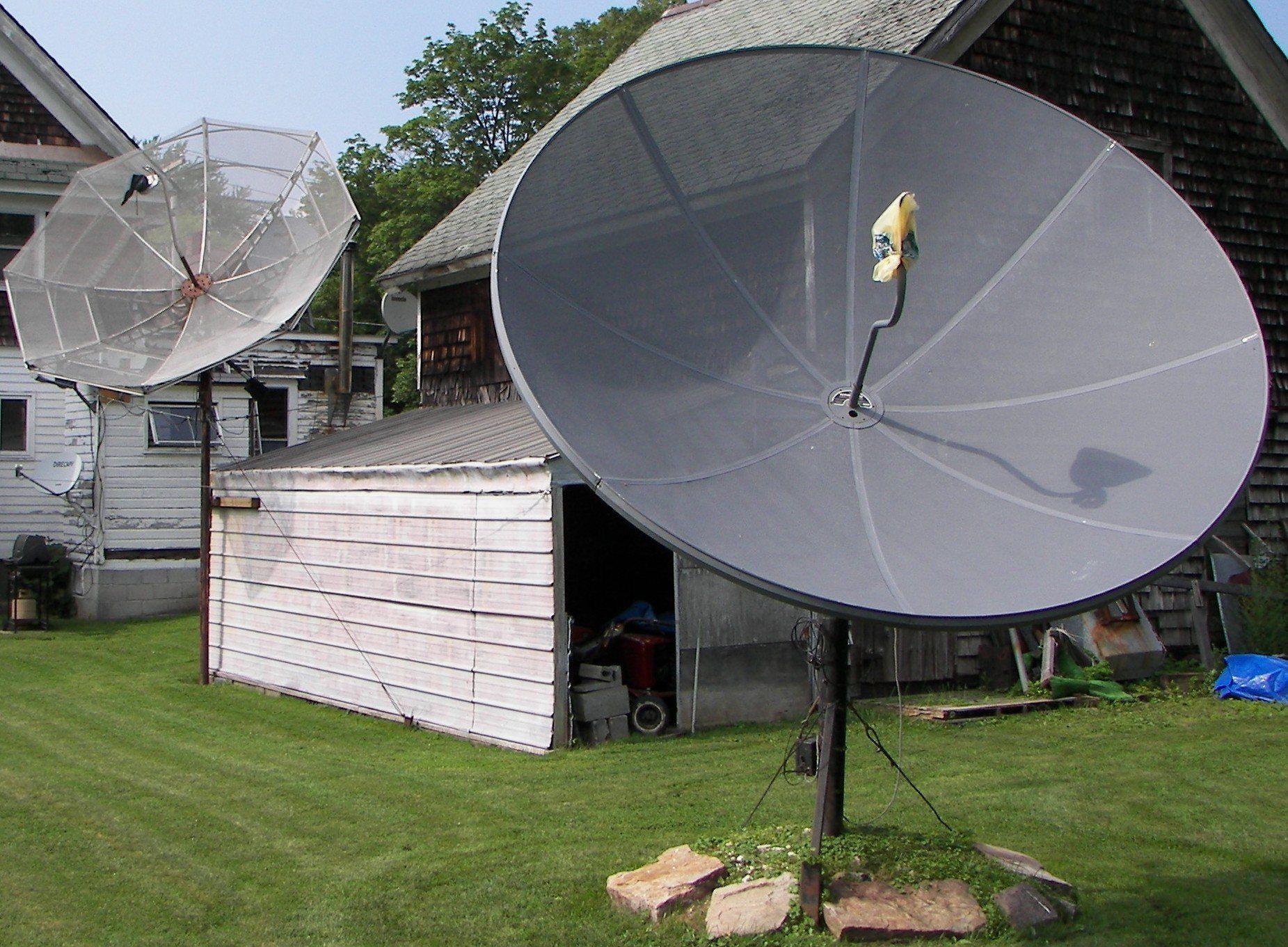

Oh alright pictures;

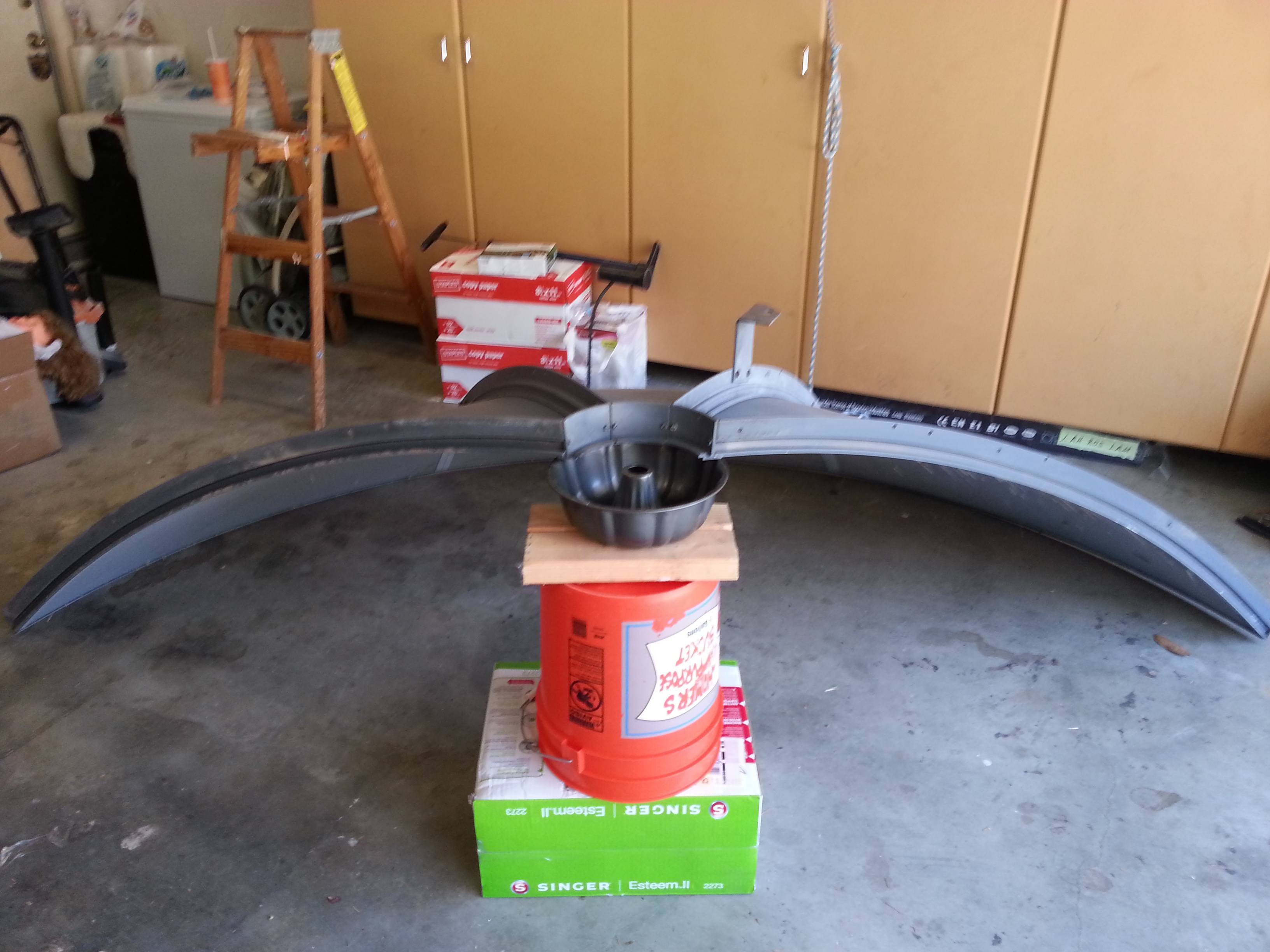

I have the same dish but AJAK mount and quad feed supports. The grey finish was almost totally gone from mine when I picked it up. I washed mine with CLR cleaner and painted it with Rustoleum. Painting perforated surfaces takes a lot of paint because you have to paint the inside of all the holes or it looks like s***. It's very hard to see if you have painted all the holes as well, until the sun hits it just right and it becomes glaringly obvious. Mine was on a 4" OD pole and that didn't fit the AJAK at all. Was kind of morphed onto the pole. I ended up finding some well casing 4 1/2" OD for my pole and remade the AJAK clamp to fit. It should have been on a 3 1/2" pole. Click the link in my signature for the thread on it. I would not consider mounting it to my roof.
View attachment 89164 View attachment 89165
Now that looks very nice :D. Something like that would be perfect for me. I could attach it to the top of my Patio (like you did to your house). It would be well out of the reach of the kids. What kind of base do you have at the bottom of the pole? How long is the pole? Did you disassemble the sections to paint them? (mine are disassembled)

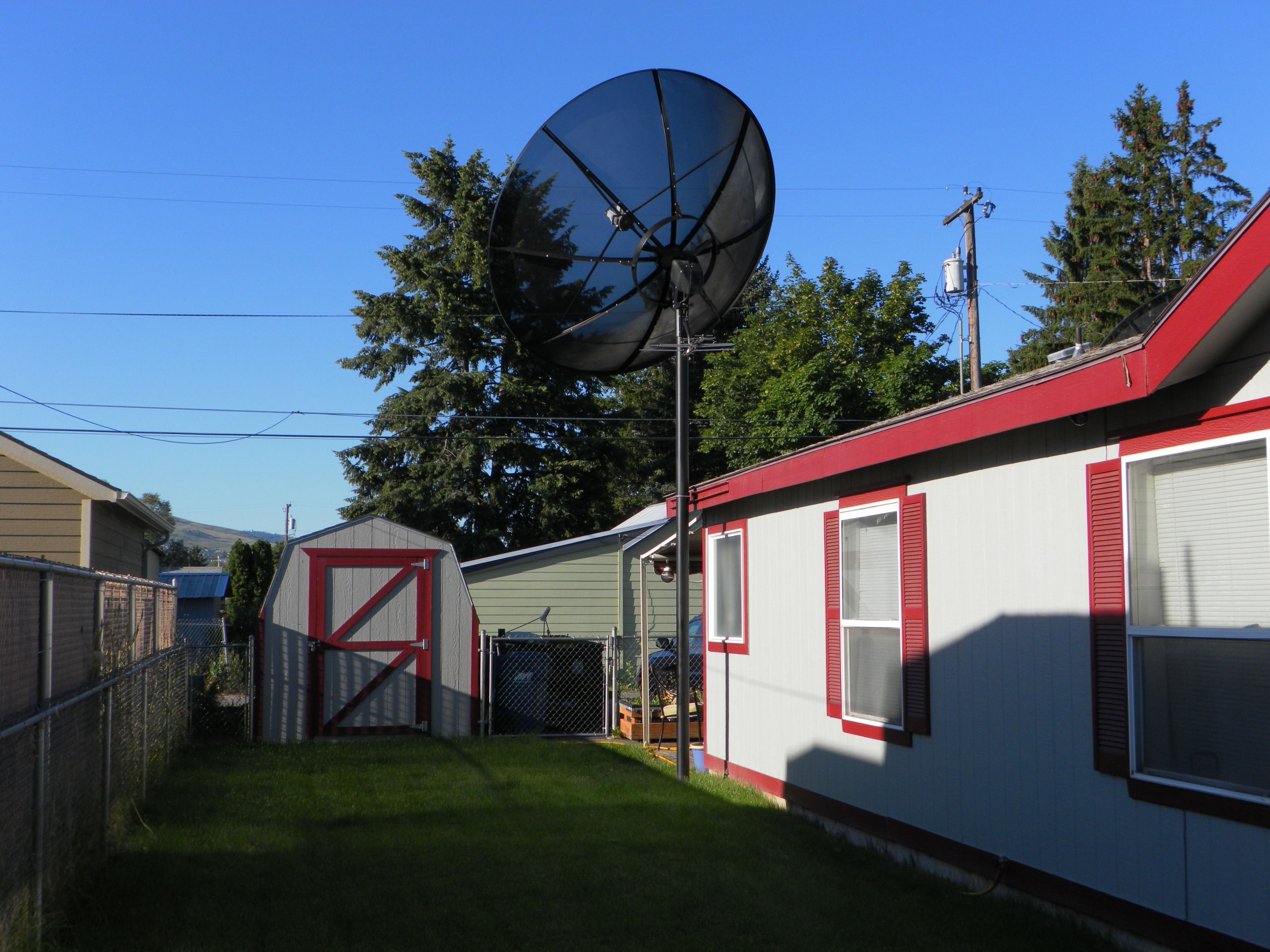

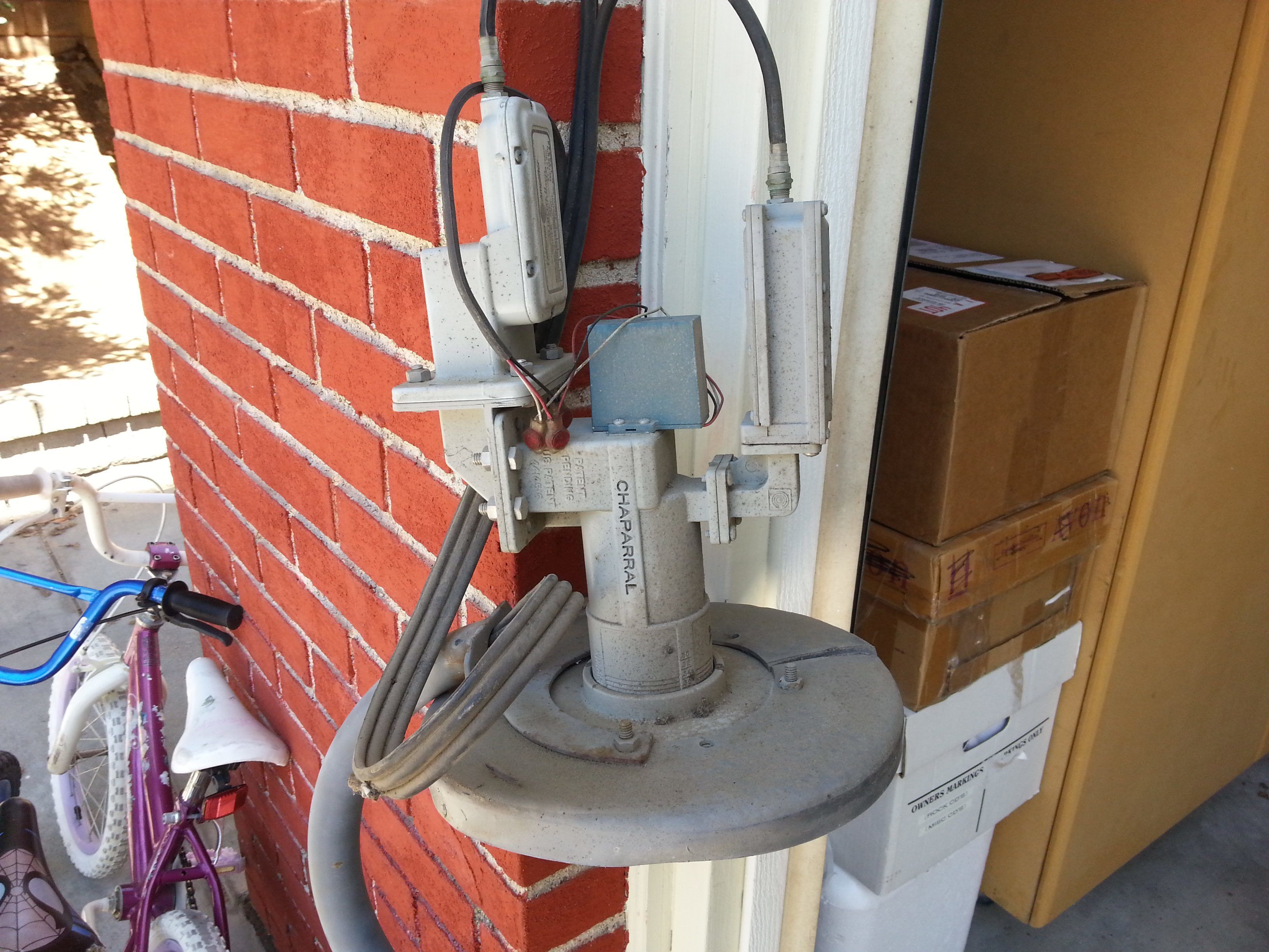

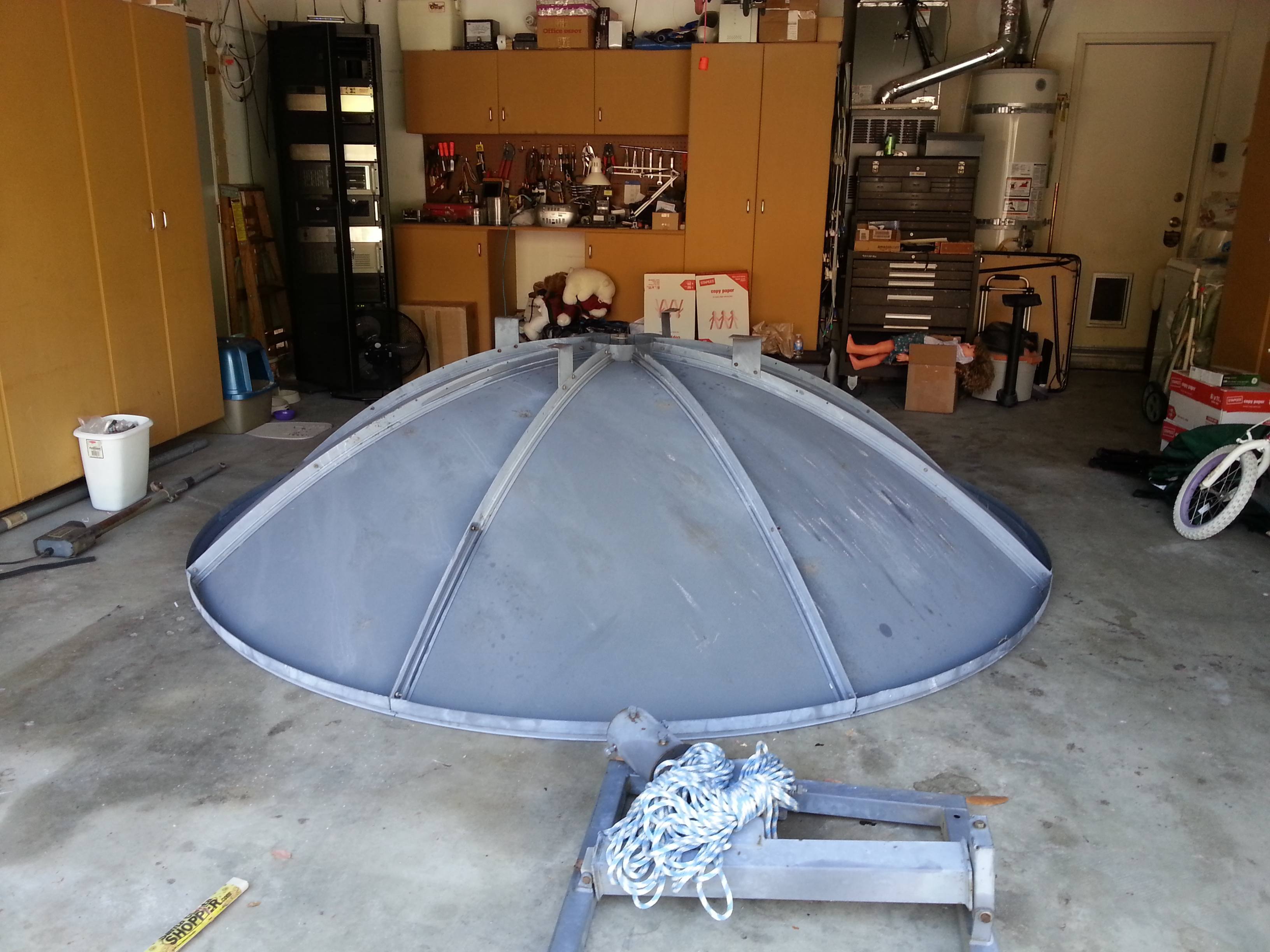

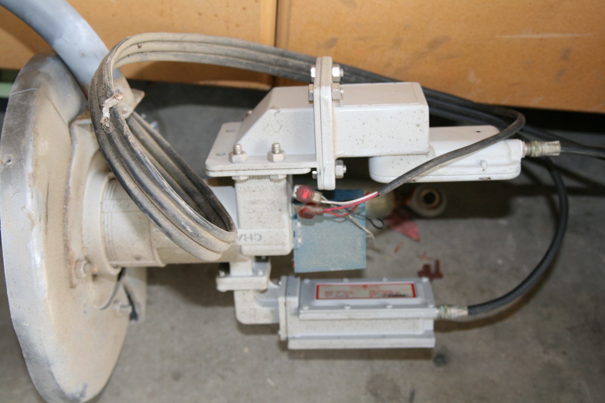

Ok .... upload problem resolved. For whatever reason I couldn't upload them across my network. To resolve, I just copied them to the desktop of this laptop I'm currently using. Anyway ... here are some pictures of my BUD including the Feedhorn, servo, C and Ku LNB's.

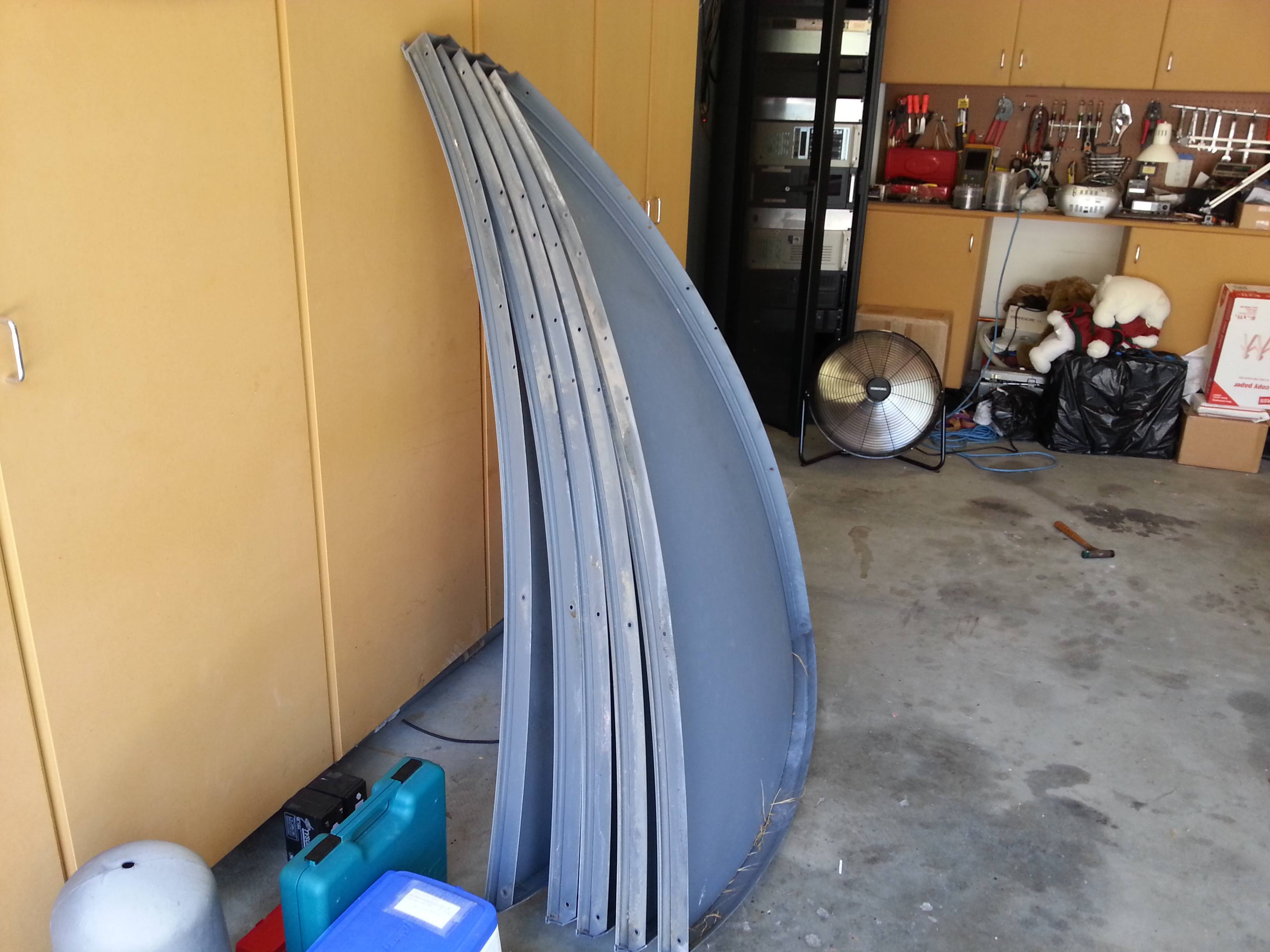

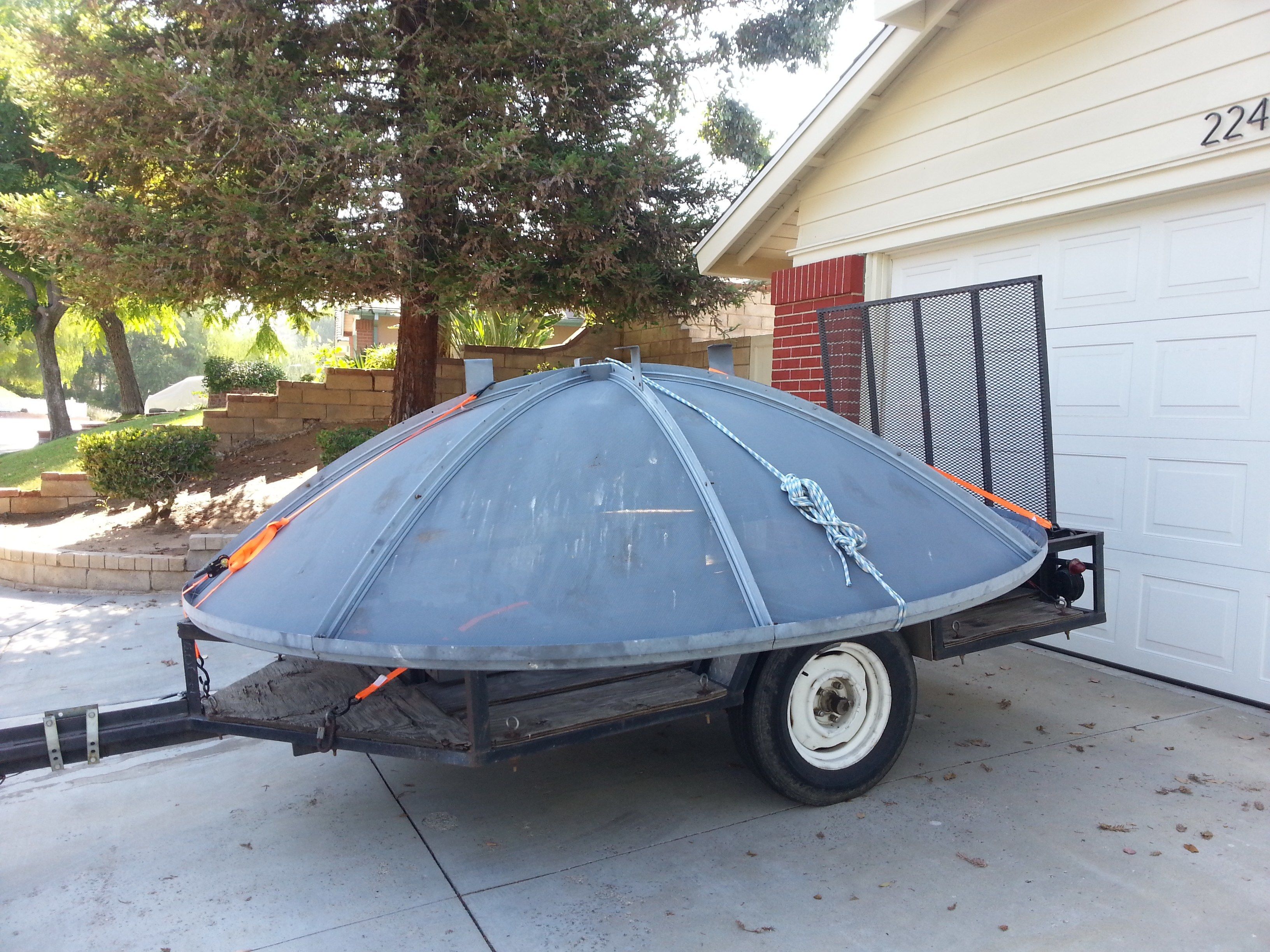

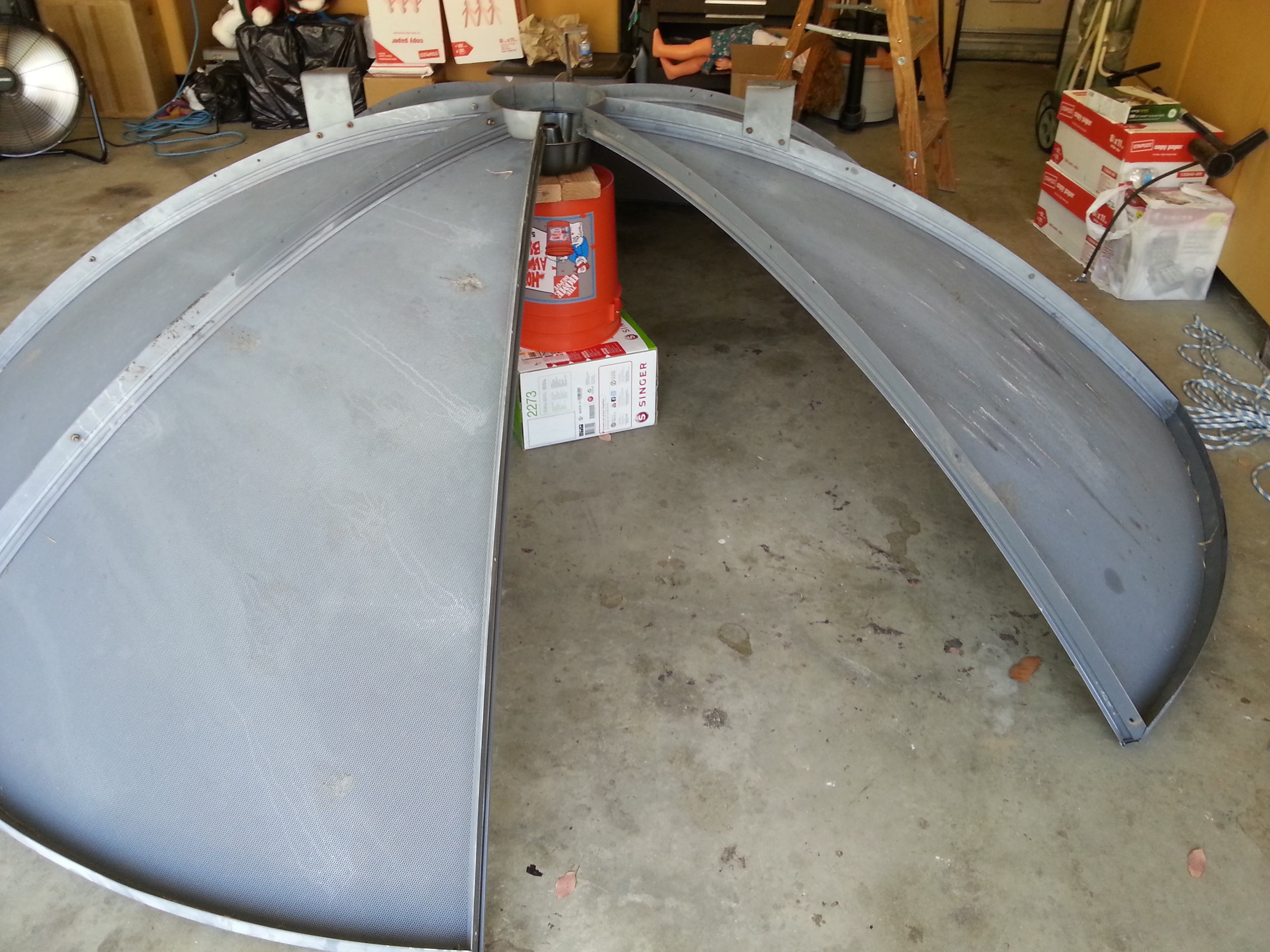

A few more pictures:
Any thoughts regarding the size of my base? (2'x2'x5') to support the BUD on a 15' schedule 40 steel pipe?
I think your cement block is wildly over-engineered.
There are sites suggesting how much concrete to put around the pipe, and how deep to go.
I might also suggest you bring in some plastic pipe through your pad to run coax and control wires.
More than two or three inches for the pad is probably wasteful, too.
It doesn't need rebar in the thin pad.
I tore one out that was 2' x 2' x 2" thick, and it was a monster (been there 25 years).
As for the pipe, you've said 4" OD several times, and that size worries me.
Doesn't sound right, nor standard.
I took down a heavy BUD 9' up a 3.5" pipe.
It was just fine & stable.
Can you see what adjustment range the bottom of the mount has? :up

I wrote a nice long reply to your message but I timed out and the forum dumped me ... I lost it all :rant:. So, here is the condensed "short reply" because I'm too tired to type it all in again :D. The correct pipe size is of course 3 1/2". I just referred to it regarding it's O.D which is 4". Yes, most likely the concrete size I choose is overkill (I just took a guess). Winegard suggests a 18"x18"x48" for an 8' pipe. I could even most likely get away with 18"x18"x36". The only way to know for sure is to ask a local engineer to do a quick size calculation for me (then there will be no overkill). The mounting bracket has a 4 1/8" inside diameter. There are (6) 1/2"-20 bolts to secure it to the pipe. Regarding the City, they really don't get concerned until you exceed their easement which is 25'. There are no HOA's in my tract so I should be ok. Besides the BUD, I've applied for a Non-Commercial FM Radio Station License. So I've got to find a place for those antennas too :D. Your expert advice and guidance are always appreciated :D.
The hole for the dish should be BELL shaped, smaller at the top than the bottom. 20" at top should be enough, but the top should harden raised dome shaped to keep water from sitting there, you want that to drain off. I've done plenty of these, and that's the best way to do it.
At the bottom which should be tamped down, you put a bag or two of river gravel, level it off, then place a flat cement patio paver in the middle. Then, you put the bottom of the pole on top of the paver. That paver keeps it from sinking into the ground before the cement sets up. The gravel helps drain and keep ground water from lifting the pole. Then, you use long 2 x 4's strapped to the pole (and staked to the ground) to keep it up and level as you pour in the cement. The 2 x 4's get removed after a couple days/1 week when you feel your cement has hardened. With a hole the size you are talking about, you are going to need about 1200-1300lbs of cement, perhaps a bit more. Cement is cheap, do it once, and do it right the first time!
Don't forget that before you put the pole in the ground, you should drill a hole through it and place a long bolt/all thread in it sticking out from each side some inches. That gets embedded into the cement, and keeps the pole from finding a way to eventually spin (due to wind load, or whatever)
Make sure you use a good level, and it should be leveled North-South, AND East-West. Make sure it's right BEFORE pouring the cement, and check it several times while pouring the cement. Once all the cement is poured, you aren't going to easily be able to change it if it's wrong. You also pour that cement evenly all around the pole, not just in on one side.
As for wiring, you can go to Lowes or Home Depot and buy some coiled black drainage pipe to run in a trench from house to dish, and have it put so the cement will harden around it, and later strap it to the pole, (don't have it strapped while doing the cement work). That protects from wives with a gardening shovels. Use a large diameter size, so you can pre-pull all the wiring through it, and you might also pull a small/thin nylon rope through with the wires (comes in handy if ever have to pull additional wires). PULL SPARE EXTRA WIRES right away!! Trust me on that, you need extra wires for later, in case some goes bad, or even at least a couple coaxes for easy future changes/additions.
Found some info on the WEB about pole size, length, and base size. It said rule of thumb for the diameter of the hole is 4 times the O.D of the pipe. Depth wise the rule of thumb they suggested was 2/3 up and 1/3 down. If I can get away with a 3 1/2" schedule 40 pipe x 12', the base size would be 16"x16"x48". Gravel in the bottom of the hole, paver, were also suggested. So, that's what I'm going to go with. Out in the yard dreaming looking for a spot to dig now! My neighbor has a mixer he said I could use so that'll help allot. Will come back later with more details
