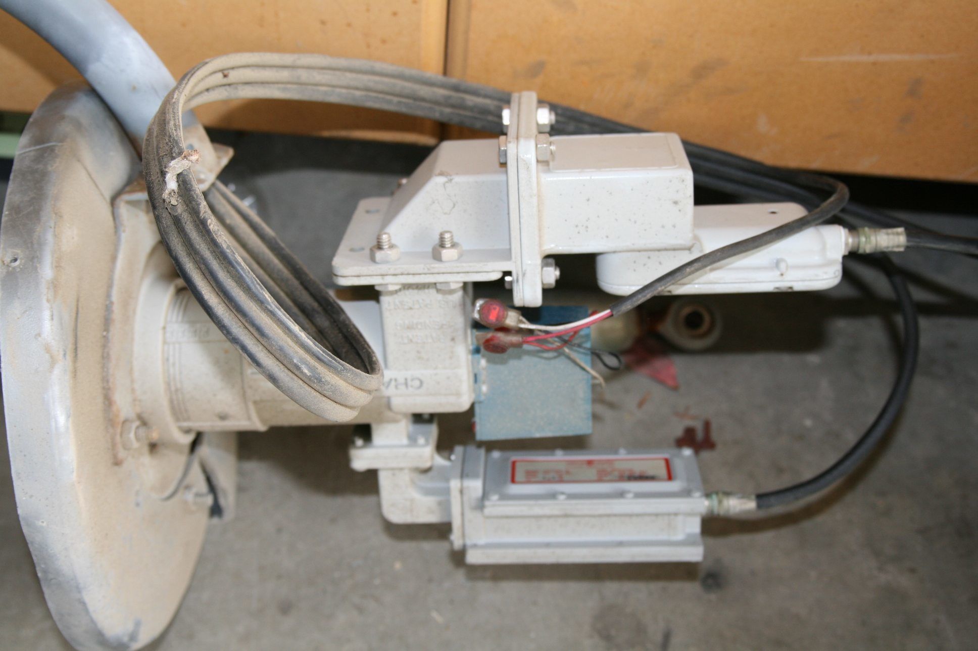

Detailed pictures of what I currently have!

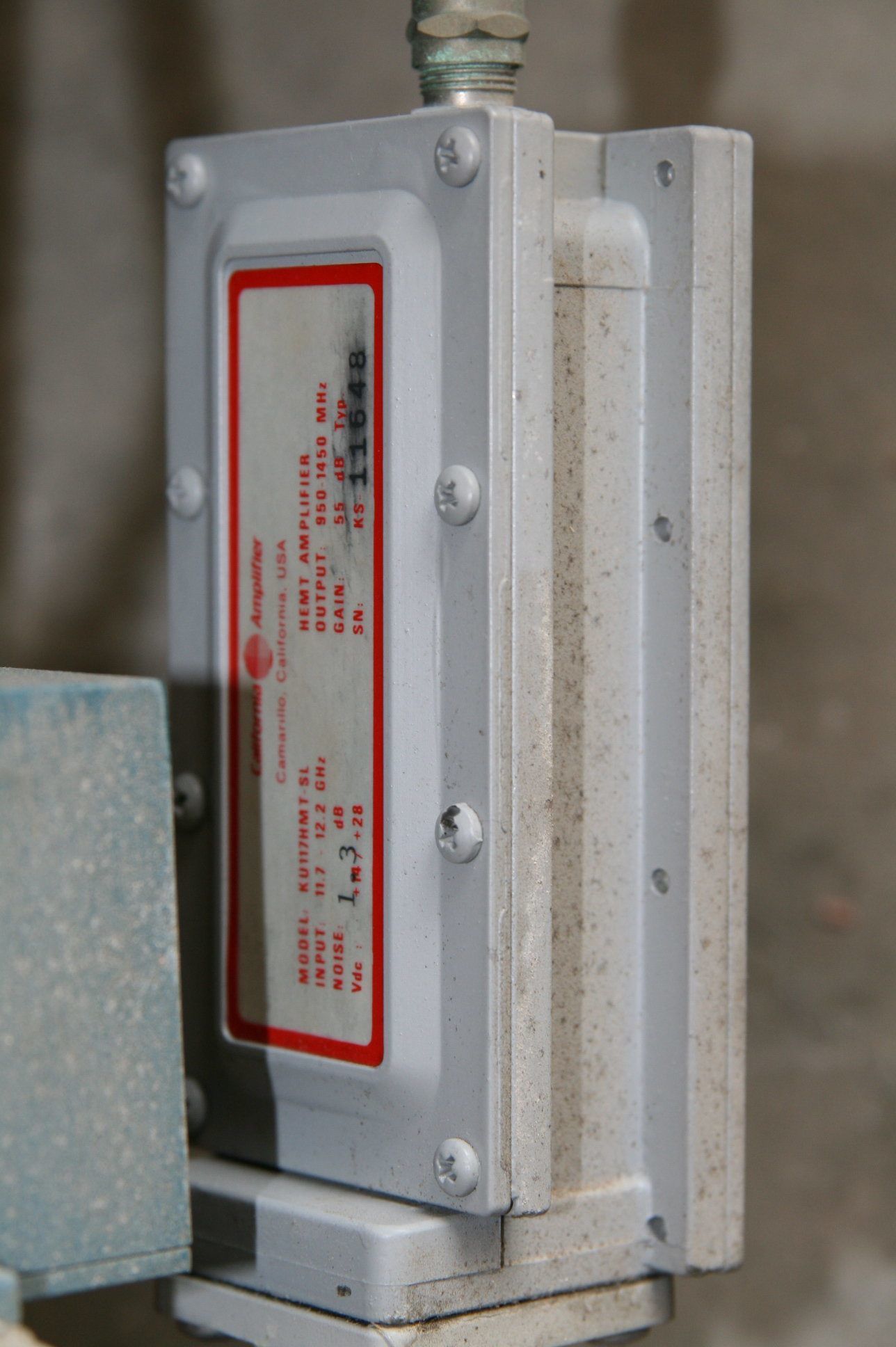

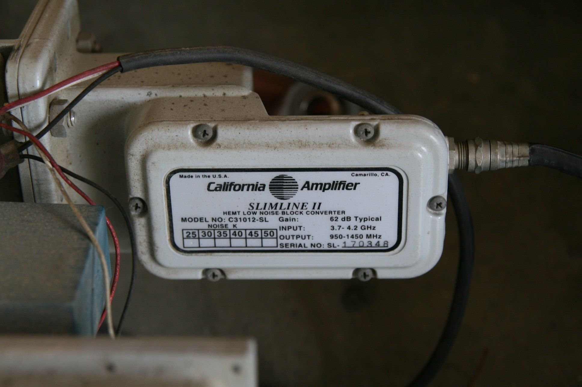

I don't know if you went back and saw the pictures of what I currently have (Feedhorn & LNB's). I have reposted them here. What I currently have is a dual band Chaparral Feed Horn with a Ku LNB, and a C-Band LNB (see pictures) (servo installed). My MicroHD doesn't have polarotator control, so please tell me where I could buy a control for it. I'll also need a new 36v 18" actuator, vbox positioner, and a switch. I don't mind trying what I got as long as the polarotator isn't expensive. Would you have to do two blind scans? One with the polarotator V, then with it H? Then I guess I'd have to be fooling around with it all the time when I'm going from channel to channel? Any suggestions you might have would be appreciated!
Let me refer you to post #16 in this thread where I posted a link for the polarity controllor ;)

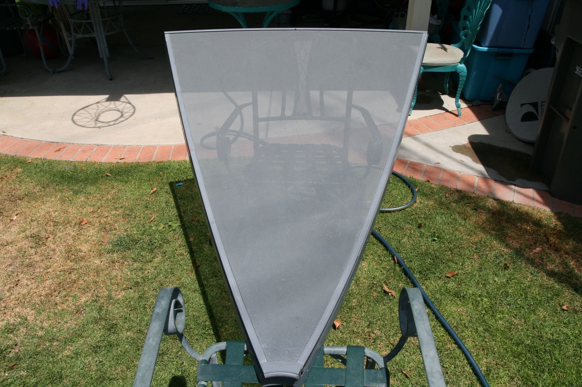

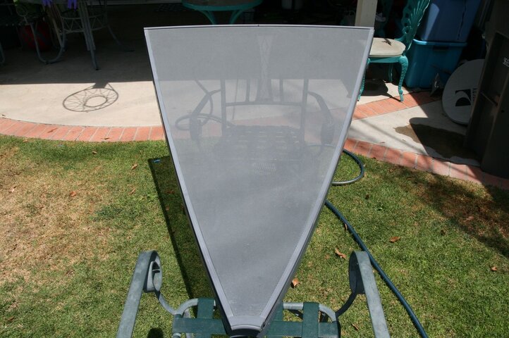

Panel Cleaning!
Well, I cleaned my first panel this morning. First with soap and water, then with CLR. I was very pleased with how it turned out (see picture). The panel looks great, if all the others turn out to be this good I see no reason to paint the reflector. Besides the factory paint is powder coat, I can't improve on that any. The only headache was getting the crow s**t out of the mesh. Had to poke it out hole by hole.

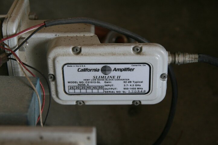

I did see what you have, but you stated that you wanted a cheap lnbf to play with. In my opinion the calamp lnbs will do just fine for now, you can always upgrade later to PLL (not cheap). No matter which way you go, I would still peak the dish using the ku band. Most Cband dvb signals are pretty forgiving your dish can be a degree off in some cases and still give you good quality. The ku signals are not nearly as forgiving, and will help you to get the accuracy you need for dvb s2.
