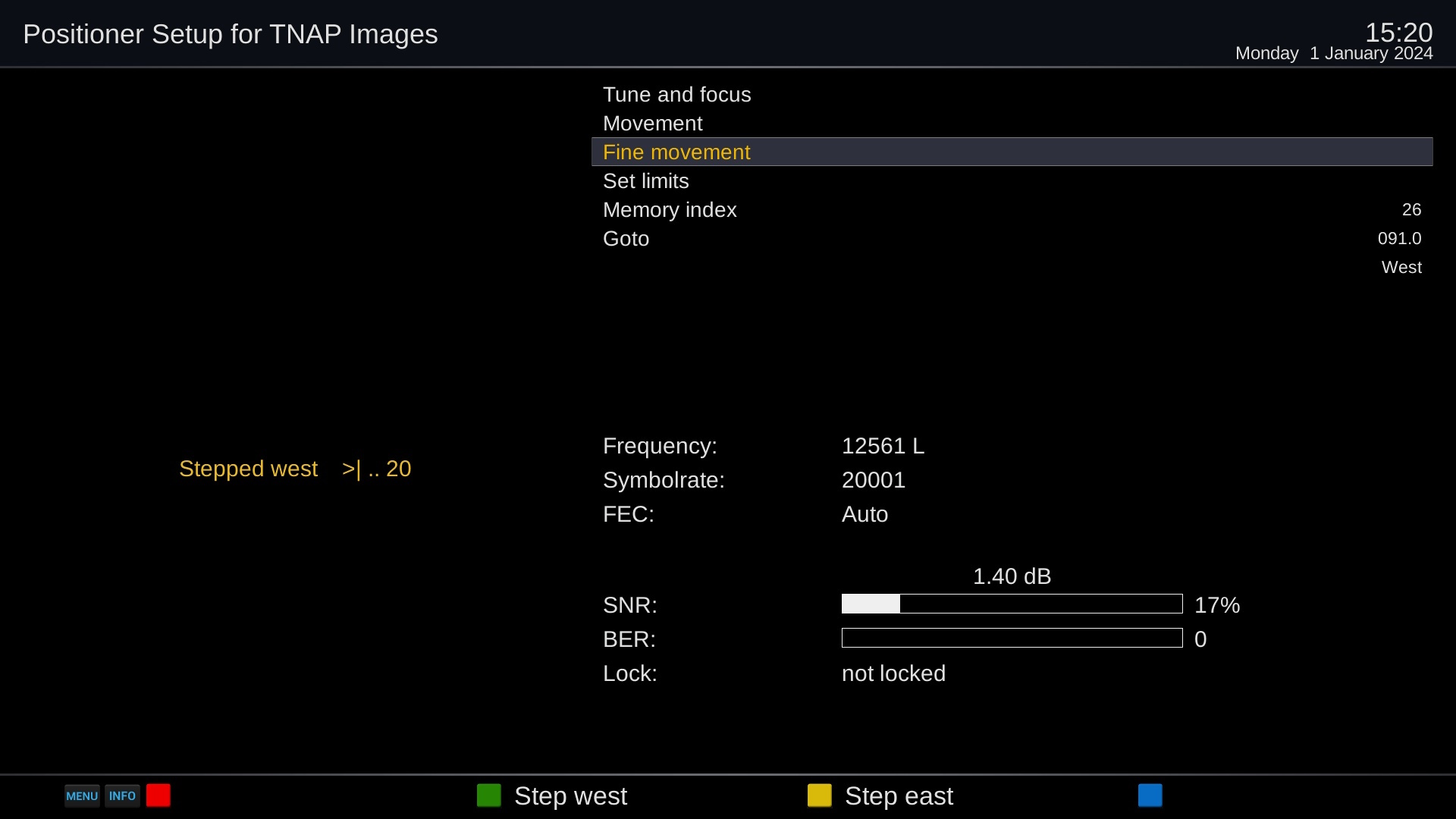

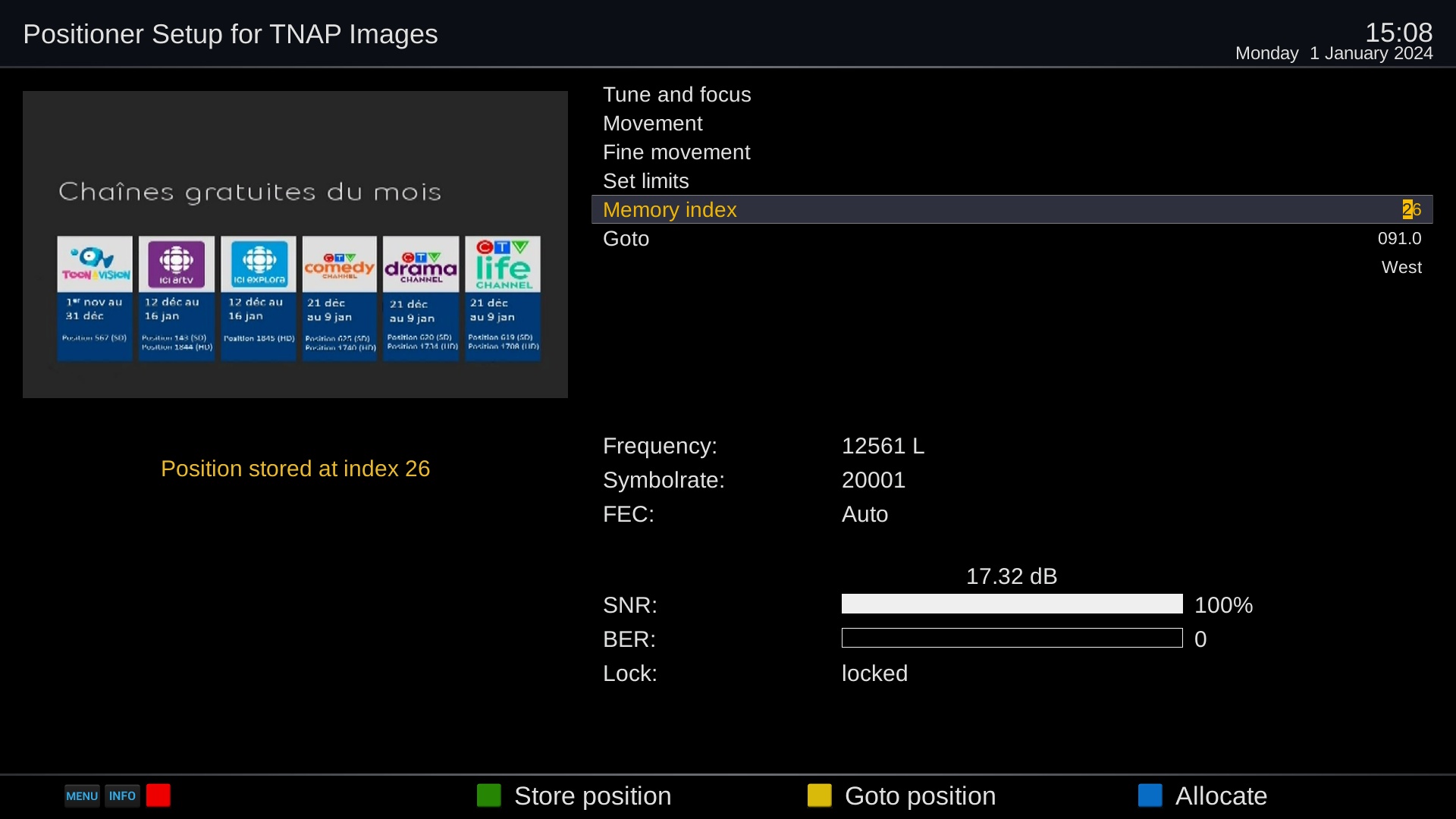

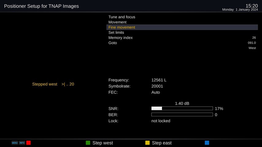

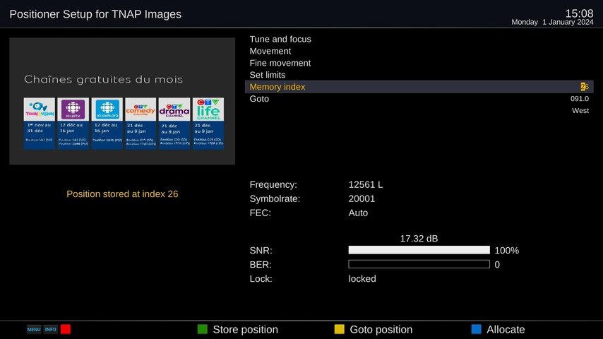

See images below. First image shows using Positioner Setup with a locked SNR of 17.32 dB. Note the two decimal places. Second image shows same transponder with the dish not precisely aimed showing a non-locked SNR of 1.40 dB. This is a nice new feature for hobbyists trying to find weak transponders.
Locked Transponder:
Unlocked Transponder:
