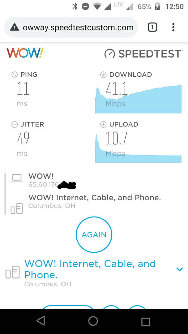

I was wrong I have 200 down and 10 up..I don't complain since I pay $34.99 month and cable works as long as your tv or converter box has a QAM tuner.. here's today's speed
I guess when you say you "have 200 down" you mean the service provides "up to" that speed, right? Because the image you posted says 41.1 down unless I'm having trouble discerning digits.
Anyway, nothing wrong with $34.99 for decent internet, that's for sure.
