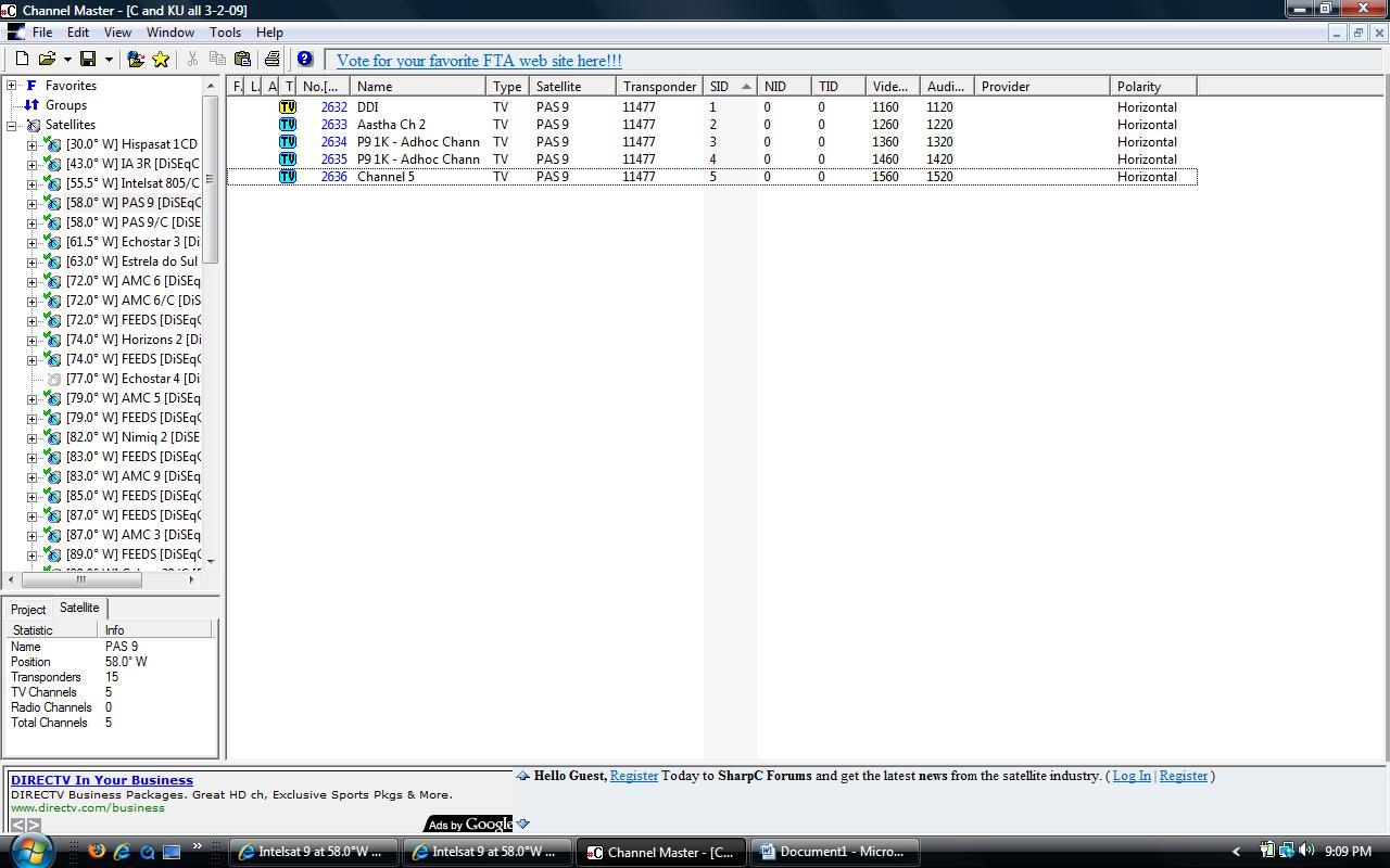

I am using a 76cm dish and a BSC621-2 Universal KU LNB aimed at 58W PAS 9. I am picking up 5 TV channels from that bird all on transponder 11477H. Attached is a screen shot from Channel Master of my saved channel list for those channels. My location is 40 miles west of Omaha NE.
Click on the thumnail then click enlarge when file opens, you should be able to make out all the channel information.
Walrus,
I hate to be a pain. Did any thing on there look British as far as programming goes?
Aastha is from India.
