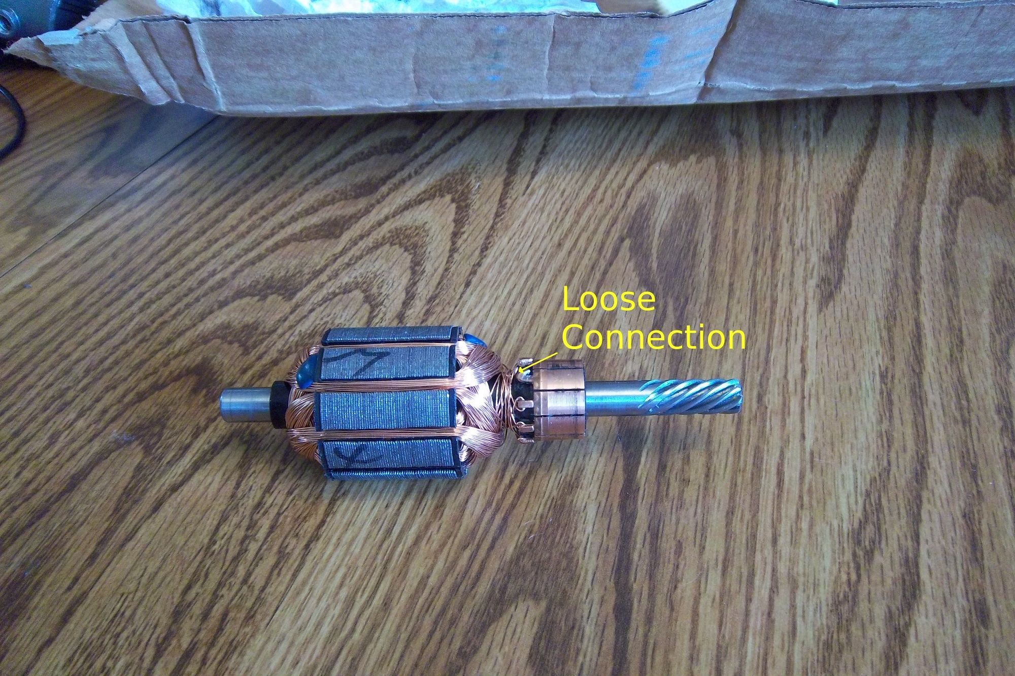

Well, I found out what the problem is. A wire is not connected in the windings of the armature. Sure looked alright until I did a really close inspection. Brushes travel over it but no electricity flows. If it happens to stop there - dead motor. Then when you undo the two motor case screws and jiggle everything it works again until it one of the brushes happens to stop there again.
Took the motor off the HARL-3618 (that was a bear - really on there tight) and replaced it with the one on the HARL-3612 (came off easy). After I got everything back together it seems to be running fine. Gonna put it on the dish and try it out. Will post the results. Wish me luck!

So far so good! The actuator has been working fine all night. :yessign: Thanks for all the great suggestions from everyone! :hatsoff:
