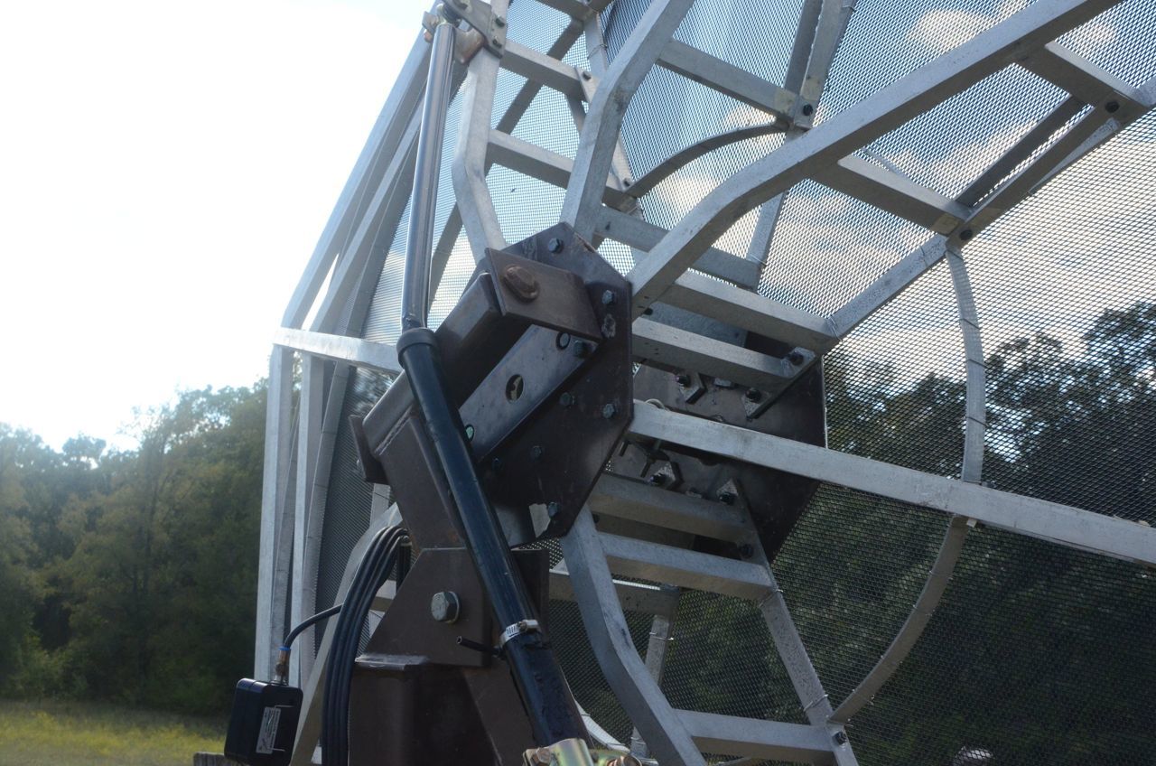

I can attest to the fact that the Made in China Ebay actuator is a short lived spare (They use only 1.5 inch tubes and advertise as heavy duty). Mine lasted only until the first good breeze folded it over. Hunted up my old 24 inch Thomson
Saginaw Ball Screw Actuator which uses a heavy duty 2 inch tube and it has been running every since! It is a ball screw actuator instead of an acme screw and can lift twice the antenna for the same electrical current.
The clamp is one of the major problems for this or any other actuator used on a heavy antenna. I could not clamp the 1.5 inch tube with the furnished clamp and I tried rubber liner as well as hose clamps to keep it from sliding, but ultimately it was the actuator sliding in the clamp that allowed it to extend until the antenna could flop over and destroy the actuator.
The 2 inch Ball Screw actuators are build heavy enough that this same slippage would not have bent the actuator and the Sagninaw (Michigan) people knew to include a heavy duty clamp that could hold the tremendous force this actuator is capable of pushing.

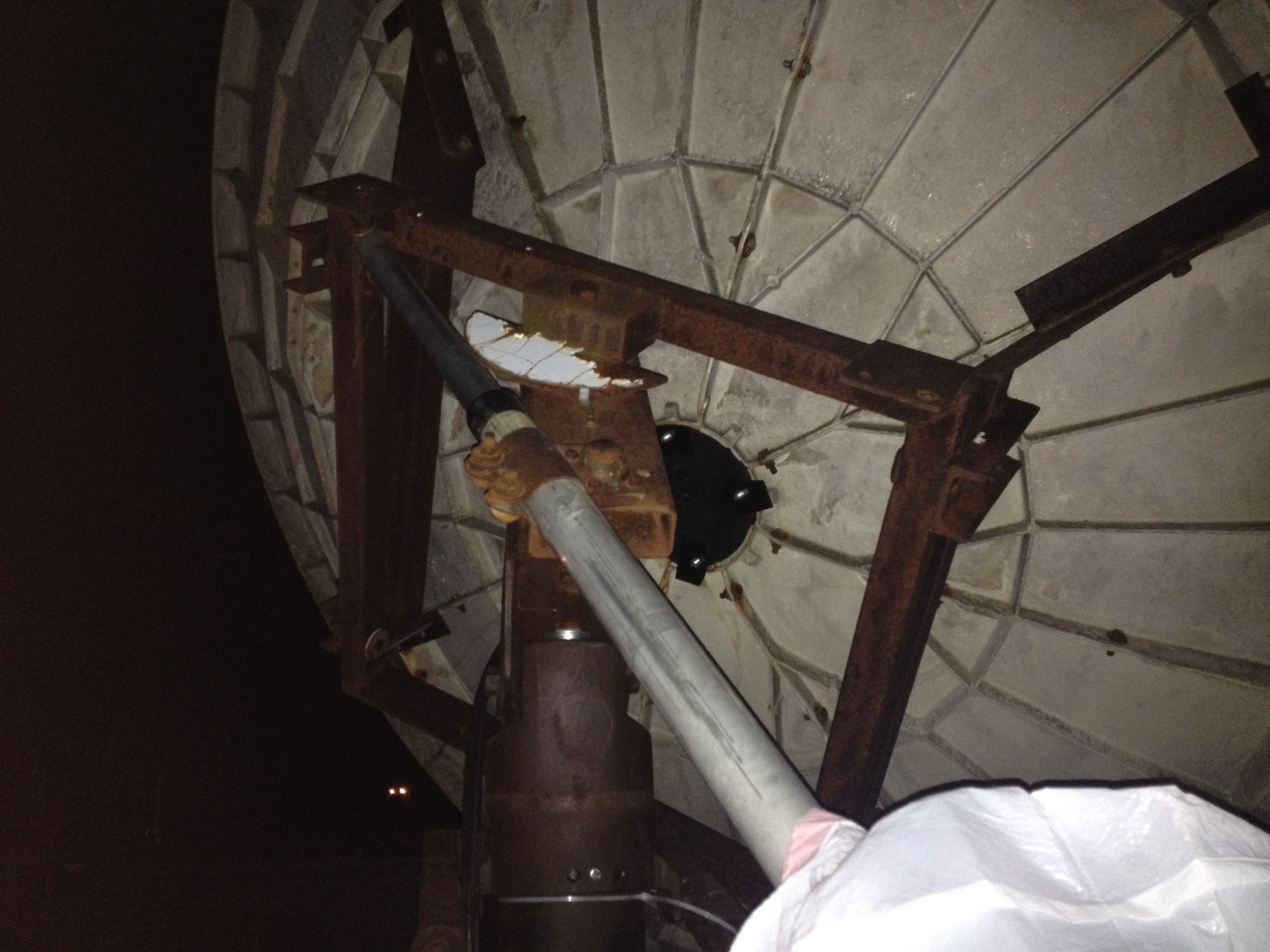

I was wrong, the farthest I can get with a 50/50 chance of having to help it is on 121W. I had a plan in mind to fabricate a counter balance which would be a piece of angle iron with 4 1/2 to 5' pole welded to it for the weights. It would bolt to the top rung but there's a few problems, the pole would hit the actuator and it will hit the main pivot bolt in the polar mount. Any ideas?121.JPG
A weight lifted off the ground as the dish is at, or near, an extreme. Would be attached to the side of the dish that is highest when at that extreme. Hope that made sense. I kinda don't like that option as it's attached to the dish so there's a chance of deformation. Maybe a heavier weight, but to that side of the dish framework????
I have an idea of what your saying. I have a hunk of steel around 100lbs I'll hang on the framework on the side of the actuator.
