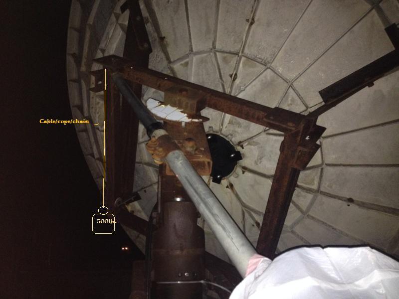

Now, it would be lying on the ground 'most of the time' and lifted into the air only when the dish is far enough 'over' to be potentially problematic. So a cable to it from the top of the square frame holding the dish.

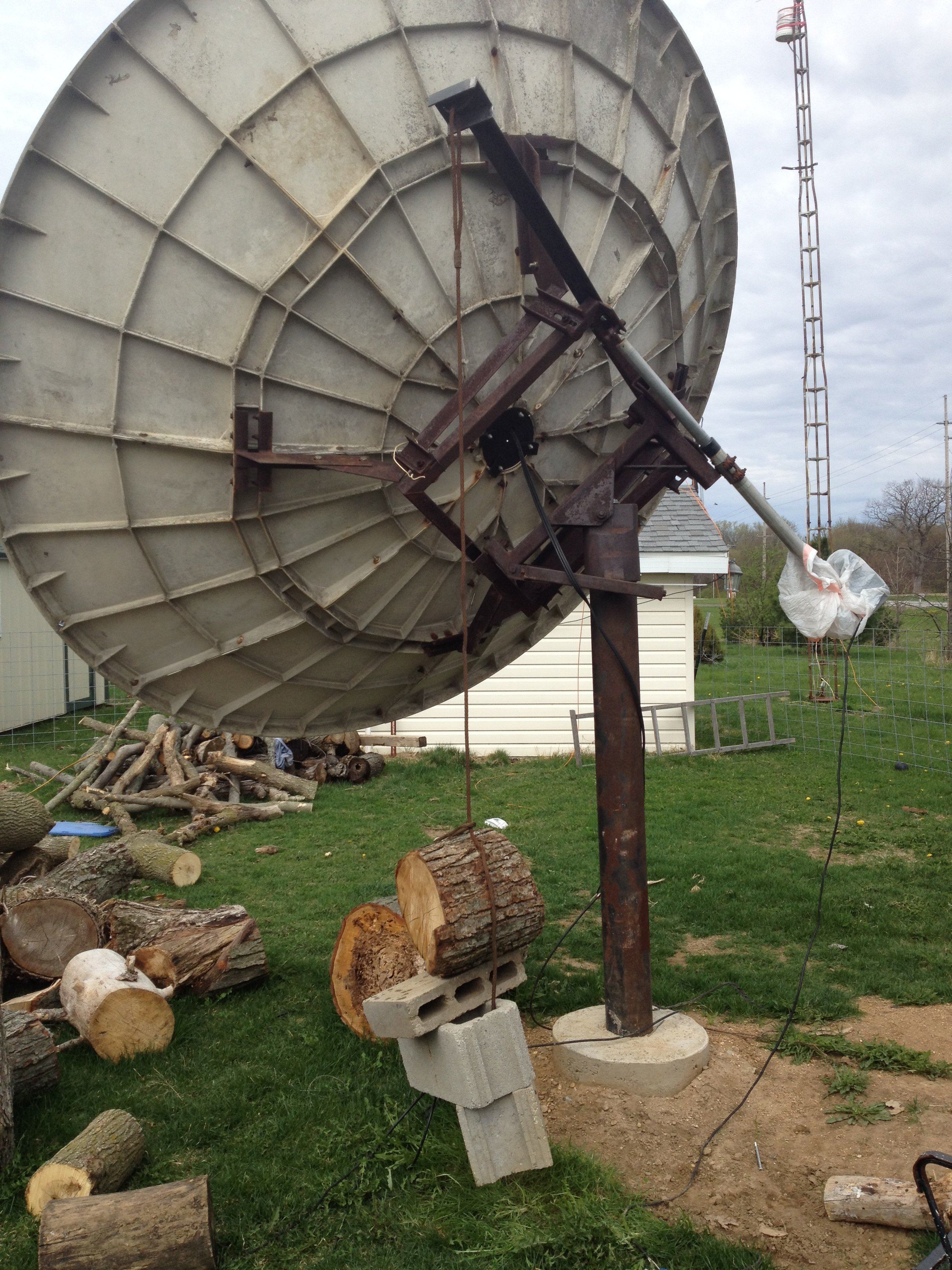

Sorry it took so long but heres a pic. I can get it to 123W without any problems now, need a few more blocks so It will come back from 125W. Thats the end of the actuator. I'm going to run some fence posts through the blocks so with wind won't blow them against the pole.

I've been trying to go farther west. I got a few more inches out of the actuator and I upped the weight to 240 lbs. I can barely pull it back east from 125W with that much weight. I want to keep adding weights but how much weight is too much?
Instead of more weight, extend the 'arm'. Right now you're weight is only like a foot from the pivot. Moving it out another foot doubles the 'effective' weight.
Another question: have you checked the current draw of the actuator motor. Especially around your southern satellites. It's sounding like the actuator is 'weak' requiring that much 'help'.

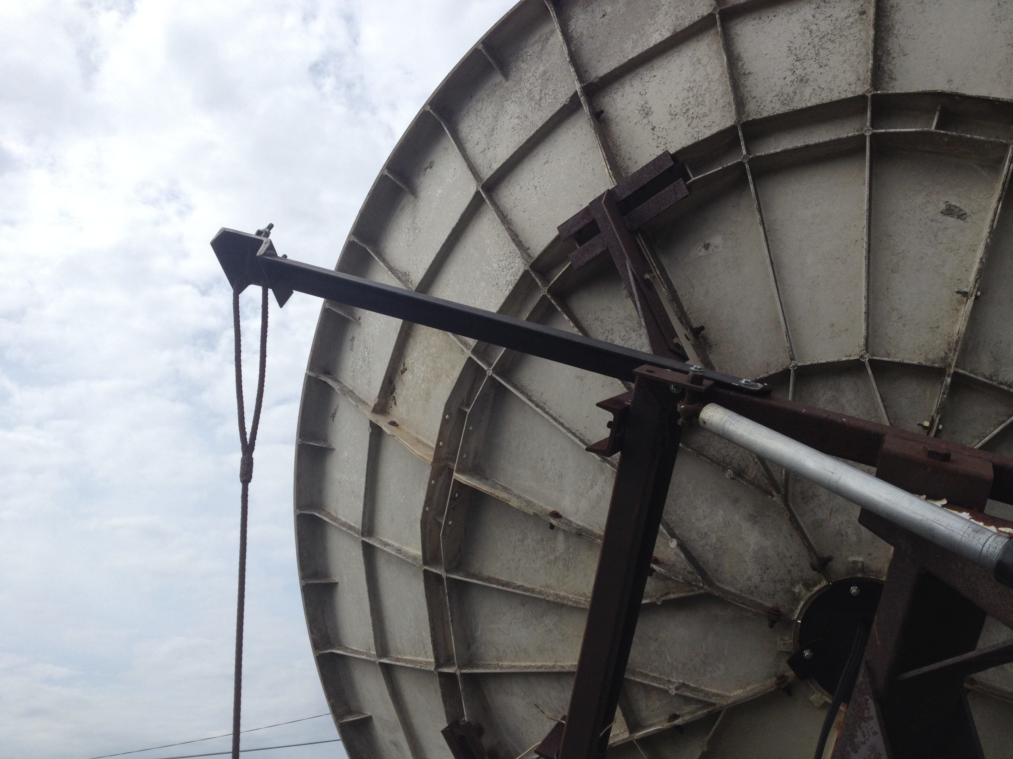

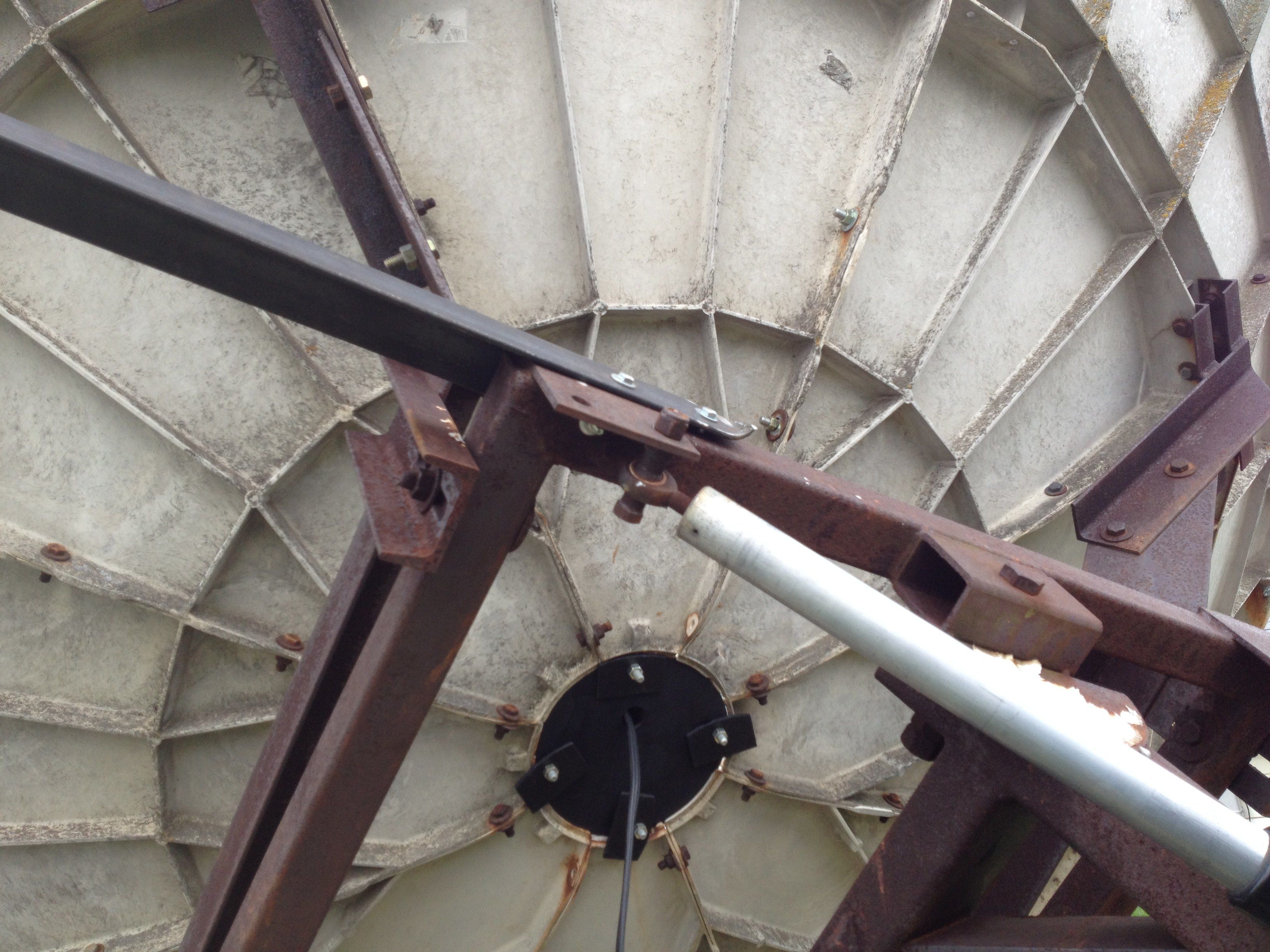

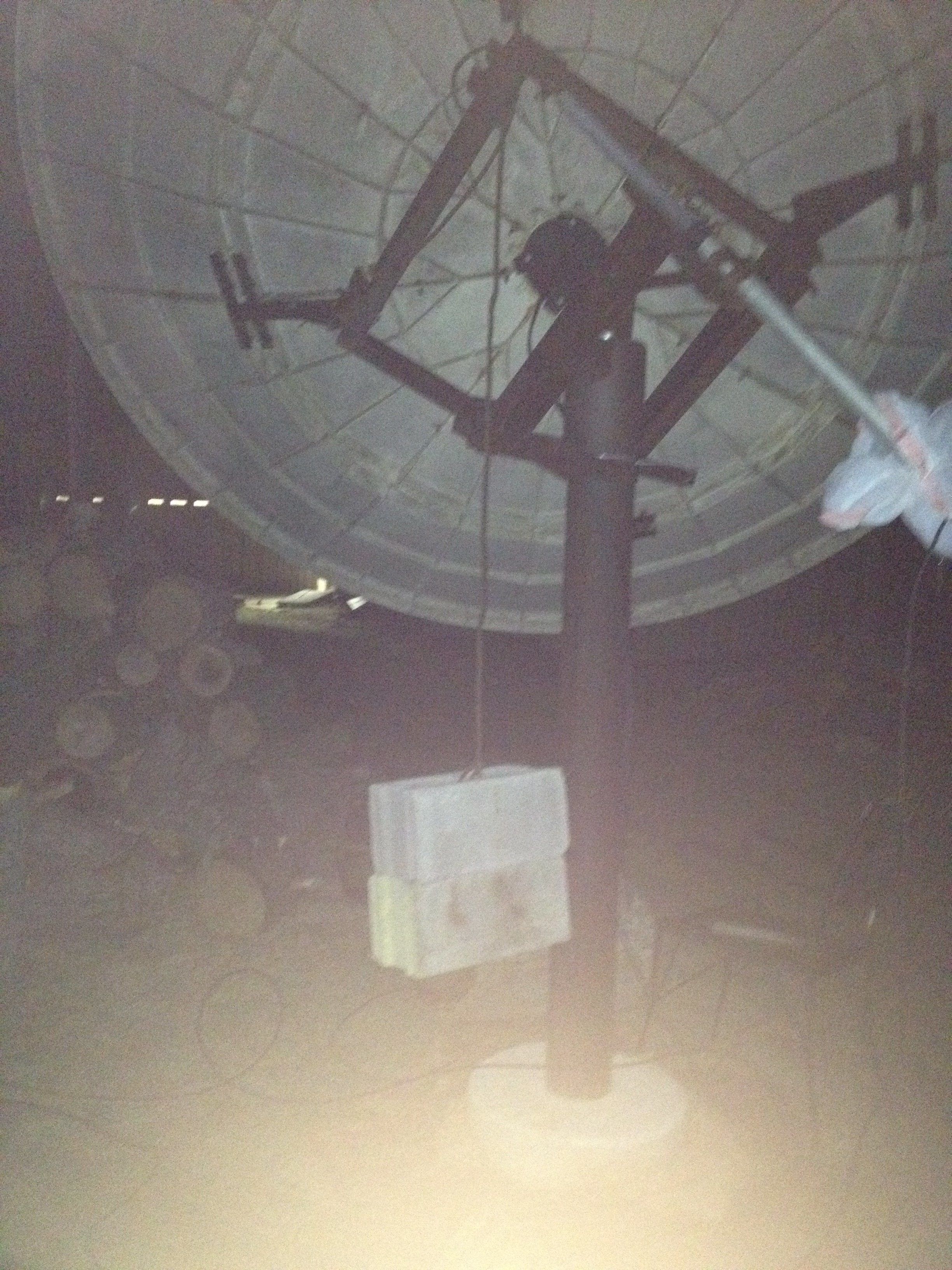

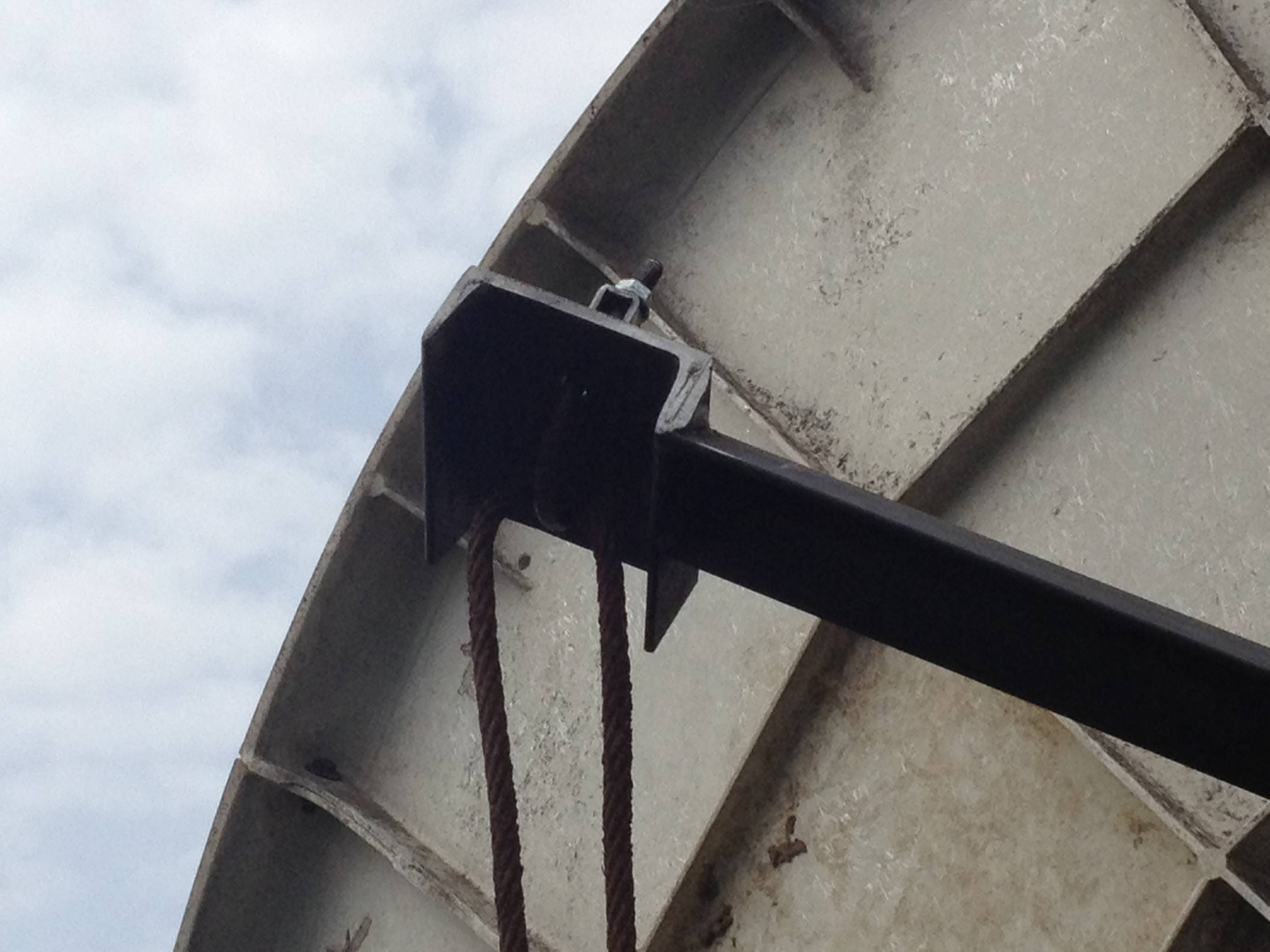

Made an arm last night. I'm getting two more bricks next time I'm at Lowes. I'm tracking 40.5 - 127, I'm thinking about moving the actuator where it tracks 53 - 139.

Not bad for a worn out actuator motor.
Might want to pick up a can of Kroil or PBBlaster to clean/lube the rod end of the actuator. Looks like it may be close to 'locking up' Then after a few applications and it's loosened up a coat of some aerosol grease. I also coat the tube itself with it. Couple times a year. Lubes the seal so it keeps water out.
