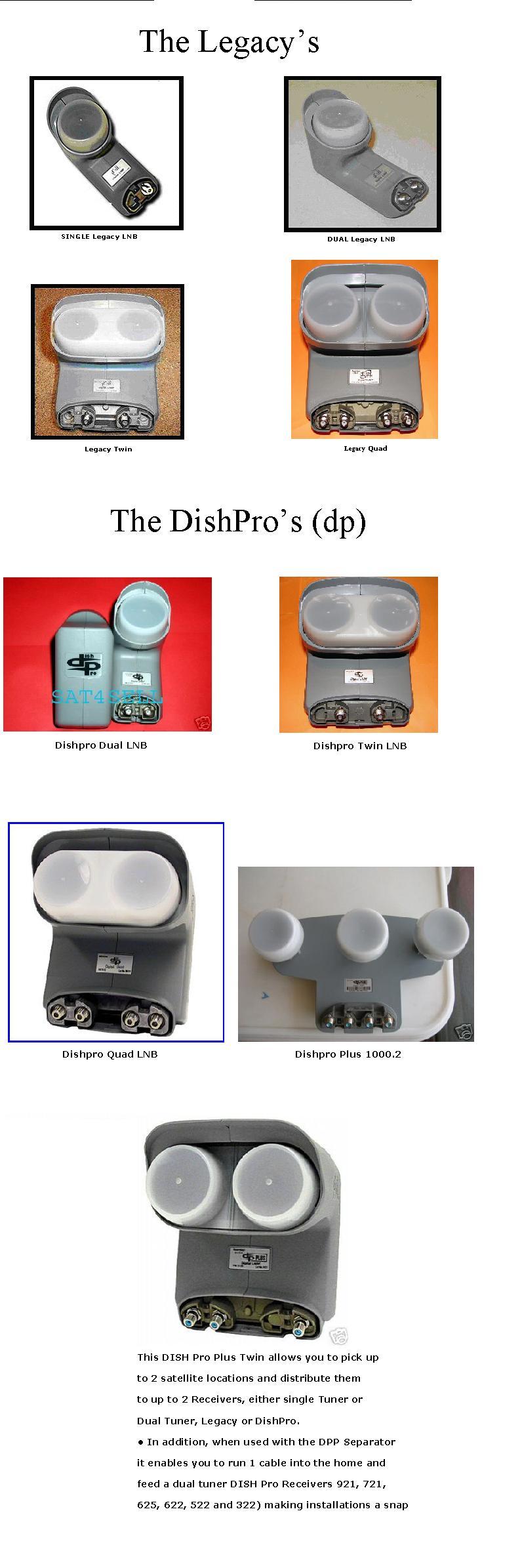

Does the LNBF on the D300 have the DP logo on it?
If yes, then stacked with an LO of 11250/14380
if not then you might want to try setting the LO to Standard/Single and 11250

It's the first lbn in the picture legacy single output. I knew I was on the right sat the dn stb's know the difference between satellites. If I was on 110 it would have had signal but it would say wrong sat 110w or something like that.
