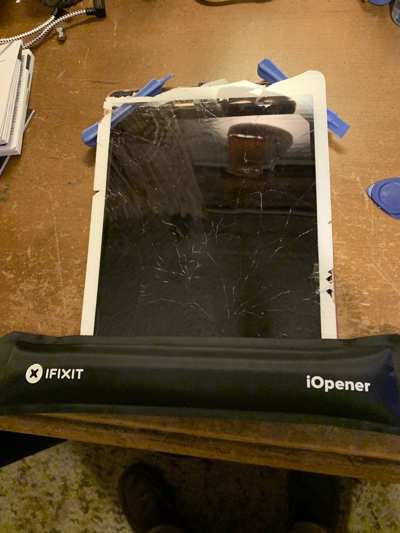

Well my youngest grandson age 7 just dropped his new ipad we got him for Christmas. It still works but I don't think it is safe to use with all the cracks in the glass. I see Amazon has replacement front glass for the ipad 6 Gen for $26.99. I'm sure I can repair it as I've done iphones and an Apple watch battery replacement. My daughter said she has a friend who owns an Apple and Samsung repair business and will check with them first.
Uh, make sure you read the iFixit tear-down on the iPad, Don. iPads are not designed to be fixed.

Last week I went intop the Apple store and just happened to see their tech guy walk out from the back room so I approached him and asked. He said thyey do iphone repair because the screen is not glued in but easily removed with 2 screws. Then he said I am not allowed to tell you that I can replace the ipad screen with special procedure independently. He than said if you are willing to try it yourself you can buy the parts online but trust me it is not easy.
Then he showed me their replacement cost for the Gen 6 which is $259. I can but a new one for $249 from Amazon and get my Amazon discount.
My daughter has a friend who runs an Apple repair business and he said he does screen replacements for $50. I found front glass and digitizer and home button kits for $31.

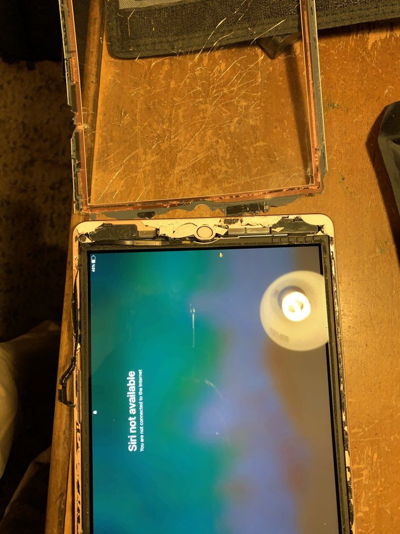

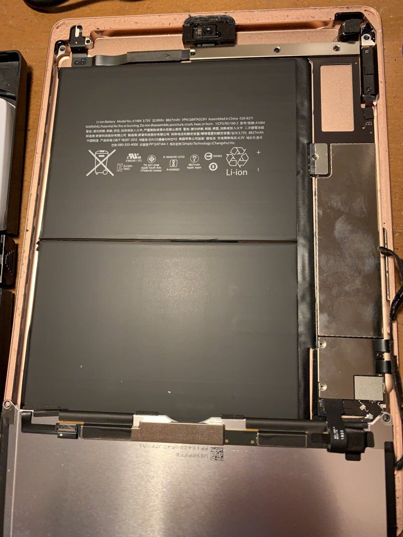

Last night I spent 2 hours removing the shards of glass from the frame by melting the glue with the ifixit iopener and razor blades. I have the ifixit deluxe Apple repair kit. In the process I discovered the ribbon cable on the digitizer was ruined, as well as the home button. The LCD screen is good. These can also be bought for ~$50 from a variety of sources.

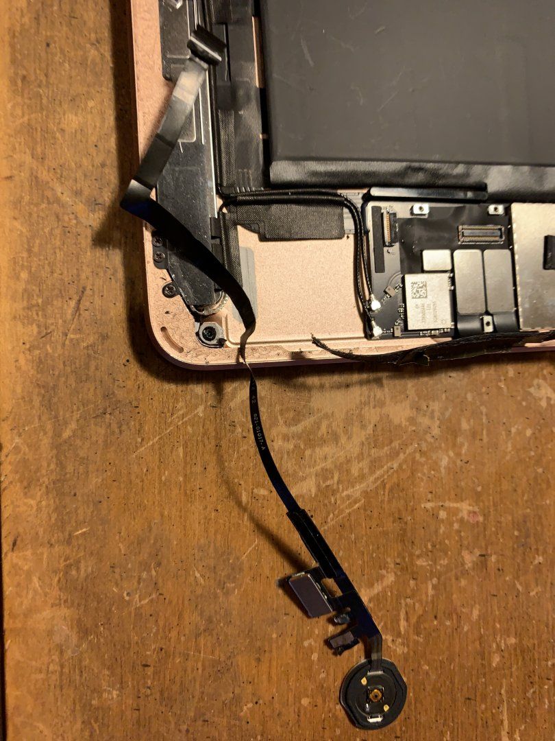

One YT video claimed the Home button ribbon is soldered to the main board which is false. There is a micro multipin connector with a tiny locking lever. It is easily accessed under the LCD and Digitizer cover plate.
Ordered replacement parts now. so waiting for then to arrive.
This is definitely more difficult than replacing a battery or screen in an iphone.

That looks worse then my Father-in-Law's iPod Air 2 that he dropped on the power button corner. He's been looking at the sale prices waiting for something in the $250 range for WiFi only and 16-32 GB of flash. As you observed, while it is possible to get the screen, glass, digitizer, etc. separated, it's a mess to do so. A broken screen/surface glass is the only reason I would, since those components are the most likely to be damaged in the removal process. I have not added the iOpenner to my iFixit toolkit which also means I'm unlikely to try repairing my FiL's iPad. Since his case is mangled around the power button as well (it's wedged into the case) replacement of the entire iPad is his best option.
We used clear packing tape to keep the missing shards of glass from slicing up his fingers. The iPad's camera is clearly exposed so it's a good thing he doesn't want to take any pictures with his tablet. But it still works well enough for most of the things that he wants to do; as a result there isn't much impetus to replace it.

I ended up ordering a new glass with digitizer attached including the Home button. Used acetone to clean off all the old adhesive. The original home button has a chip along side that is some sort of Identifier that matches the CPU so when the Home button is replaced it prevents future use of the finger print reader, now requiring the number code all the time. The original Home button was damaged so it's the best I could do.
