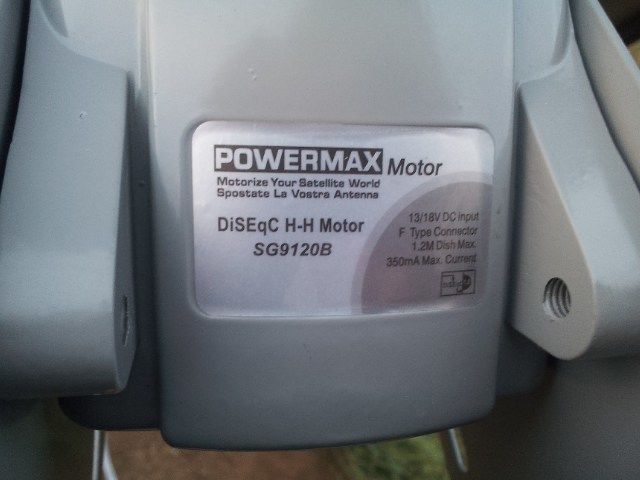

The backlash on my motor is practically nonadjustable. It is a Powermax SG9120B by sticker but is essentially junk from an engineering or manufacturing perspective. Is this a bootleg knockoff of a proper motor? The gear train has some eccentric component somewhere so that it will not power through the bind. Someone mentioned that the shaft support bushing has slop in it, which is true with this one. The combination of sloppy bushing tolerances and the inability to adjust the gear lash out make this very undesirable for a good performing positioner. I'm starting to think it'd be better to put up 4 dishes with switches and get perfect aiming all around instead of living with 1/4+" of rim movement on a 90cm dish and spotty performance on the troublesome TPs.

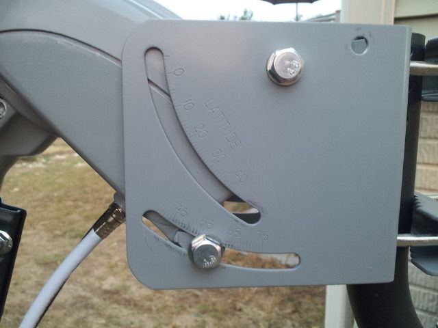

More on this motor... It has dual slots for the elevation adjustment, one for the upper and one for the lower portion of the range. The scale for Latitude is just wrong, off by 5 or 10 degrees. I attached photos of the motor set for my LAT of 40.6N. The instructions say use 40 degrees for calculating the dish elevation, the forum here mentioned it's wrong and to use 30 degrees. It's somewhere closer to 35 degrees. My pole is perfectly plumb (insert joke here), but the motor when mounted is off by about 1/8 bubble on my level. Garbage, I say. But it moves and was able to get me strong TPs from 72W to 125W. That's not good enough for dependable LPBS and OETA, transient sports feeds and 97W 12152 on a regular basis. My next step is to remove the motor and measure the actual tube angle and compensate the pole for the motor mound bracket. But the slop of the tube movement is going to be hard to fix.

I've got the same motor, and had a terrible time of getting it set up properly because of the scale being off. I finally did it by using my inclinometer, on the bottom of the motor and went by elevation. Once I did that, I still had to change my USALS setting UP by 1 degree for my Longitude (85*.** instead of 84*.**) on my MicroHD . Now all the sats are dead-on, and they are staying dead on. I used 30 degrees for calculating the tube rather than 40 degrees, and that allowed me to get my dish set closer on the proper declination per it's scale.
I have two 9120Bs, and have found them to be reliable motors. I never looked at the instruction booklet (always throw those away, most FTA equipment manuals are worthless), but the motor was easy to set up.
As far as slack or backlash, all H-H DiSEqC motors I've used (including the SG-2100) have this problem from the start. The SG-9120 (A and B) are easier to adjust for backlash than the SG-2100. You have to remove the single sticker that says "Warranty void if removed". Behind that sticker is a single hex bolt that will allow slack adjustment. There is a sweet spot between where the bolt is too tight (motor whines and strains) and where it is too loose (shaft has slack). Once that adjustment is correctly made (its a very small range, so you'll have to play with it a bit) and the tube is tight on the shaft (large hex bolt that goes through it), the motor should work well.
