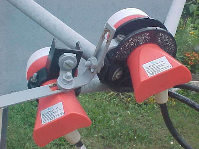

You don't mention the size of your Channel Master dish. Size matters. Then you mention that your dish is a Globecast dish, which I'm not familiar with. If you indeed have a Channel Master dish [gray composite construction with 2 side and 1 bottom lnb support, there is the difficulty of those side supportsgetting in the way, but that can be worked around. Here is a sample of a workaround for 2 lnb's which can be expanded to the 4 you need. MacGuyver has excellent skills in hangling lnb's on dishes not designed for this. Check out some of his work.
