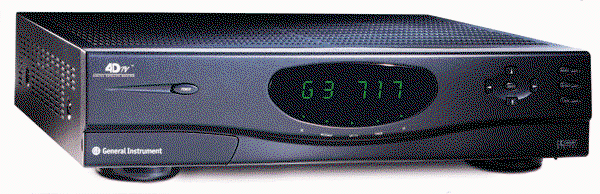

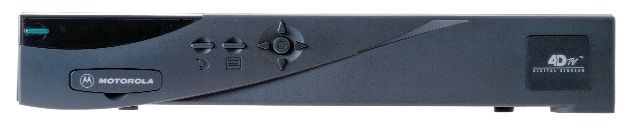

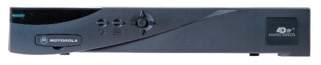

There are really only 3 receivers out there for 4DTV and all are made by Motorola. The 905, 920, & 922. So if you have one, you can get American Life TV (sort of). Here is where it gets goofy
DVB is pretty simple...its free or its subscription. 4DTV likes to add another version. I think they call it "fixed key" but I like to call it a "throw it in channel" which means to get American Life TV you have to subscribe to SOMETHING..ANYTHING. As long as the box knows there is a subscription then its included. There are some C-Band channels like that. Right now I have a 905 and I get the music channels and BlackBelt TV on G4/G16 since I do not subscribe to anything.
Here are a couple pictures of the receivers...hope it helps :)
