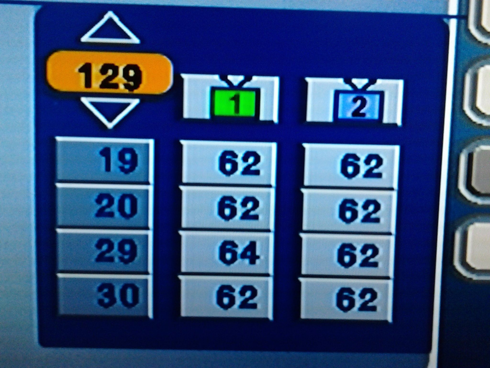

The signals are sometimes higher on that dish, but as a previous poster mentioned, usually only a few points. However, sometimes it is as much as 10 points. After peaking dishes for a few years now it's interesting how what you're looking at makes a difference. For example; If I find a narrow line of sight for any dish where it's clear by maybe only 3 degrees I can get the signals peaked in completely above limit scans, passing for Dish Network standards, however if I put a dish where there's nothing close to the line of sight with 15, 20 degrees or more I can get the signals noticeably higher. It's as if you get a little 'bonus signal strength' or the outer fringes of the line of sight.

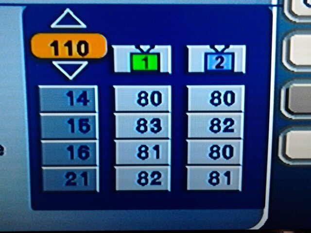

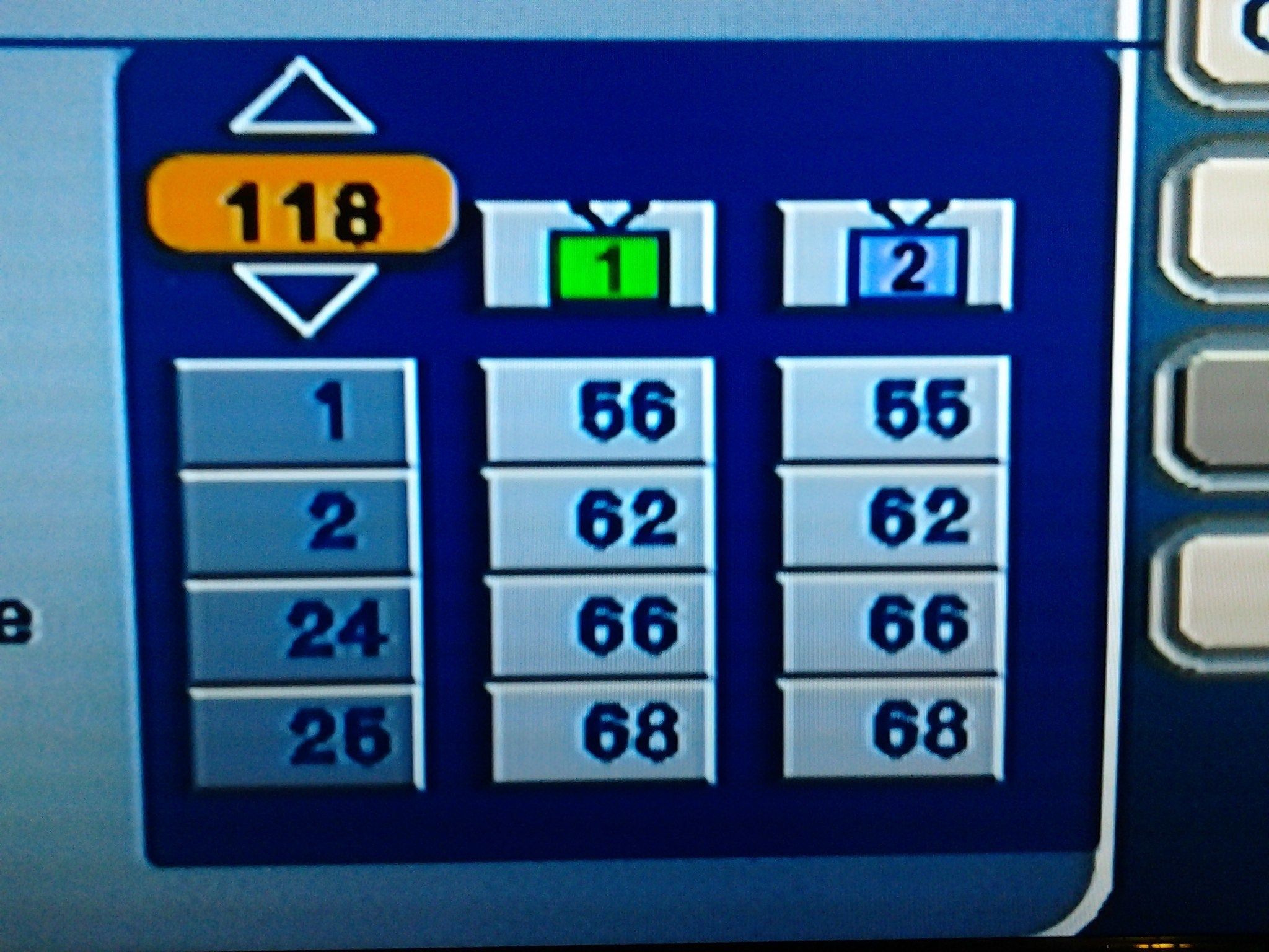

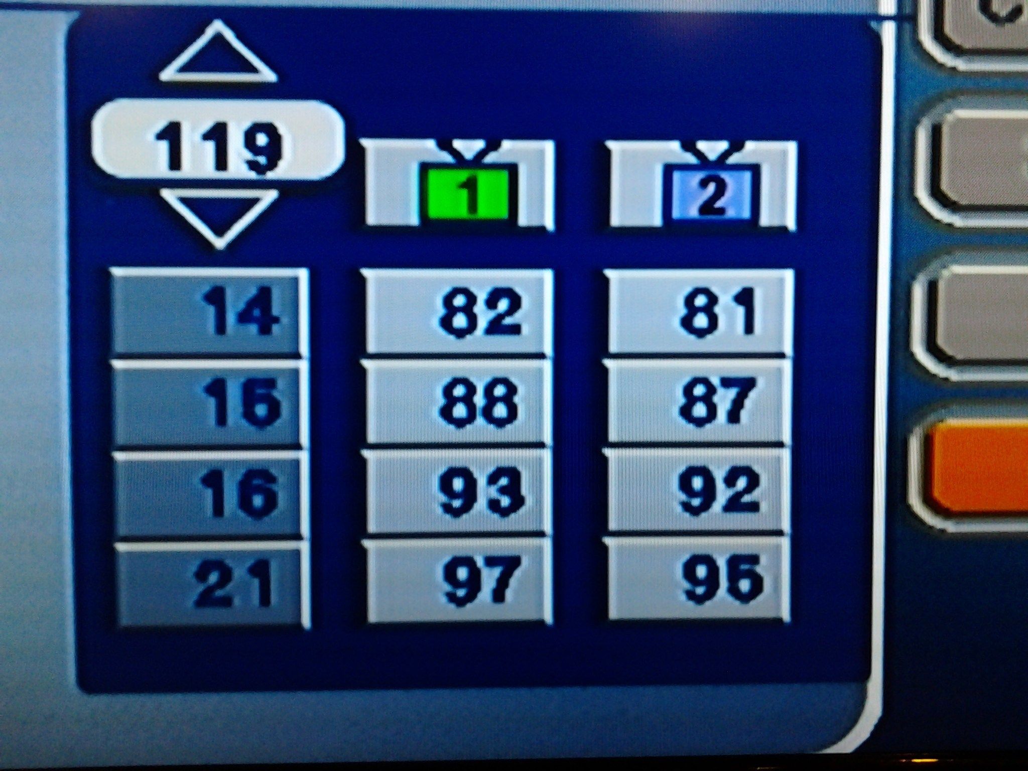

Here are signals from a customer I installed.
119.jpg129.jpg118.jpg110.jpgd
