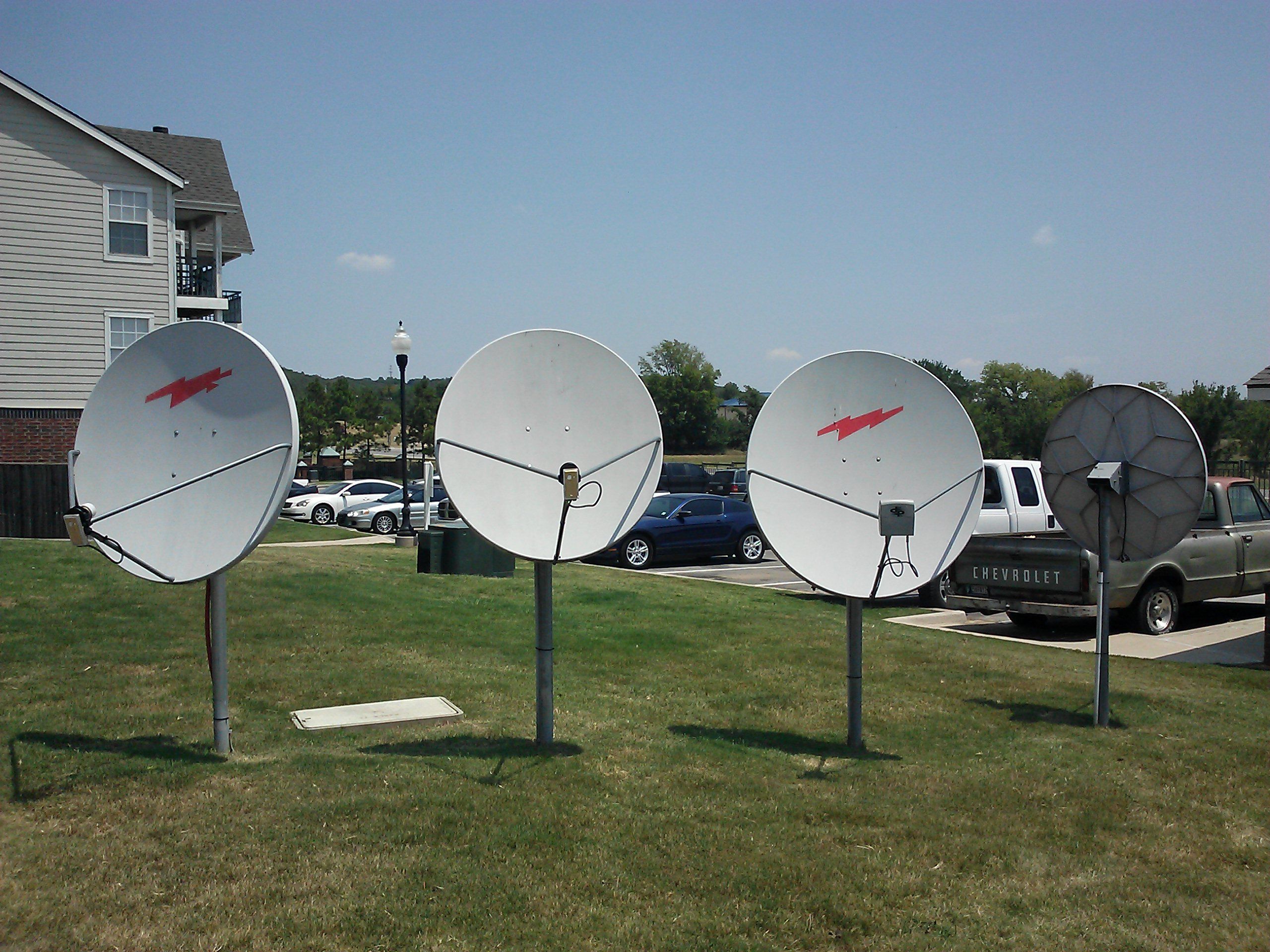

It is possible to get over 100 these days....With Quam dishes haha. I took this picture at a QUAM job in Tulsa, OK.
110,119/118, 129, 61.5
