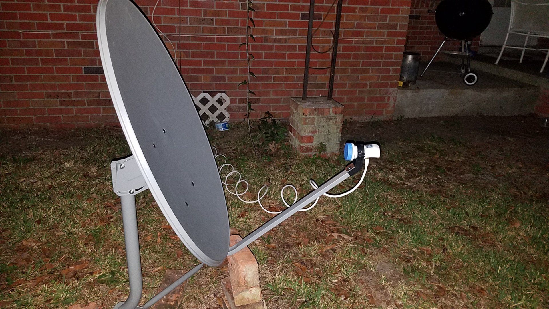

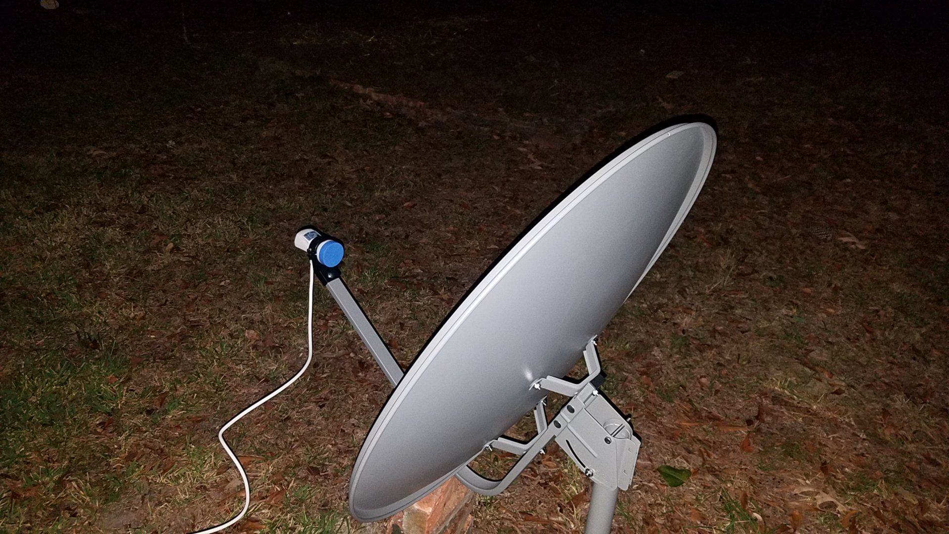

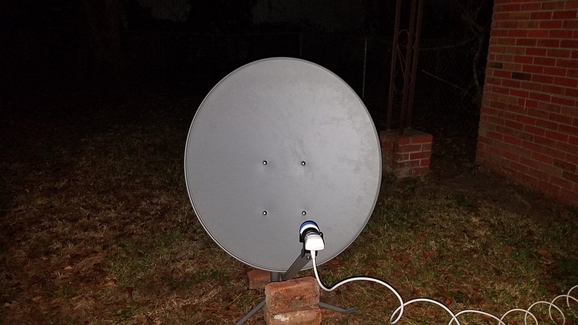

I'm trying to pull in Galaxy 19, my mount is level according to a bubble level, and I used the dishpointer app to align my dish to G19; however, I cannot pull in any signal. Could my LNB be mounted wrong? What should I do?
Thanks a ton. Also, apologies for the trash in the first shot, didn't notice it. The active wildlife in the area probably perused the trash again.
The LNBF looks like it is properly mounted. But, depending on where you live, you may need to skew it (it depends on what your longitude is).
If you give me your longitude and latitude I can tell you which direction to rotate it and how far.
What is your city and state?
The dish appears to be aimed very high. Are you using the elevation scale on the dish mount or measuring the elevation angle a different way?
What is the LNBF type? Standard LO 10750 or Universal 9750/10600? Is the receiver's install menu LNB LO set to this corresponding setting?

Standing in front of dish and looking at it, rotate LNB counterclockwise 15 degrees from 0. Then from behind the dish, fine tune the dish very slowly back and forth, up and down. You'll find the signal, quality will jump up and video will become visible on your TV.
Sent from my SM-G950W using the SatelliteGuys app!
Standing in front of dish and looking at it, rotate LNB clockwise 15 degrees from 0.
My calculator says for 30.44N, 89W and satellite 97W: 13.3 degrees counterclockwise (looking into the dish).
Positive skew numbers in calculators conventionally are clockwise, when standing behind the dish; so counterclockwise when looking into the dish.
