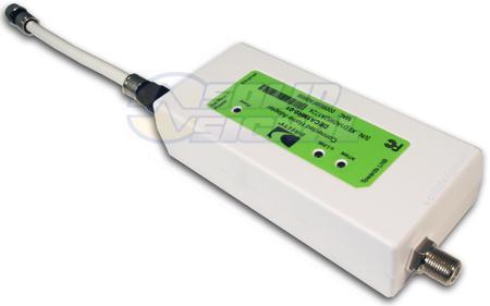

All MRV compatible receivers other then the 24's need receiver DECA's for MRV to work.
They look like this

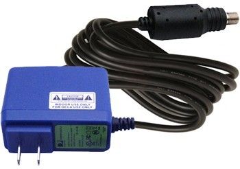

A receiver DECA can also be used as a Broad Band DECA if you have a separate DECA power supply like this
This is a Broad Band DECA
It comes with its own power supply.

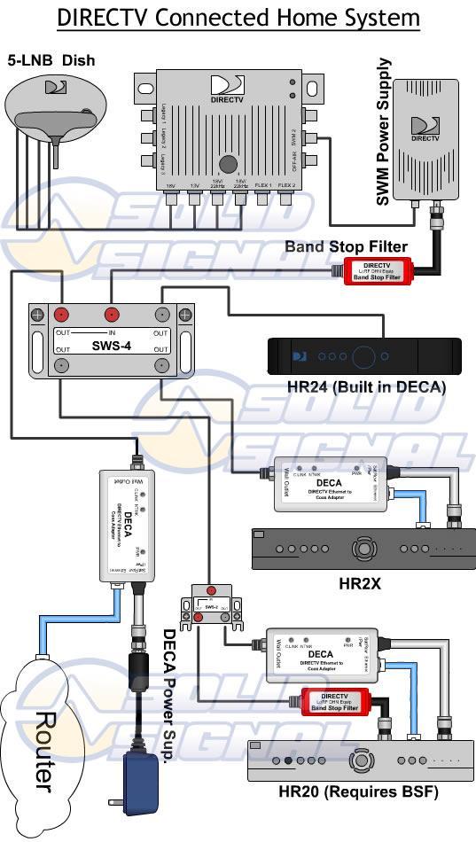

Here is an example wiring diagram
If you have a SWM LNB, you will eliminate the SWM Multiswitch.
There are multiple ways this system can be wired in, including using additional splitters. (i.e. line coming in to the receiver in the same room as the router can be split running one to the receiver and one to the Broad Band DECA instead of running a separate line all the way to the first splitter.)
Also, you can wire the 23 directly in to the router using the second ethernet port on the receiver (also with the HR21, HR22, R22) but most will recommend not to and to just get the separate Broad Band DECA.

A broad band deca connected to your router with cat5 and to the swm splitter with coax.
If you follow read the post above yours and follow the diagram, it will show you how.
