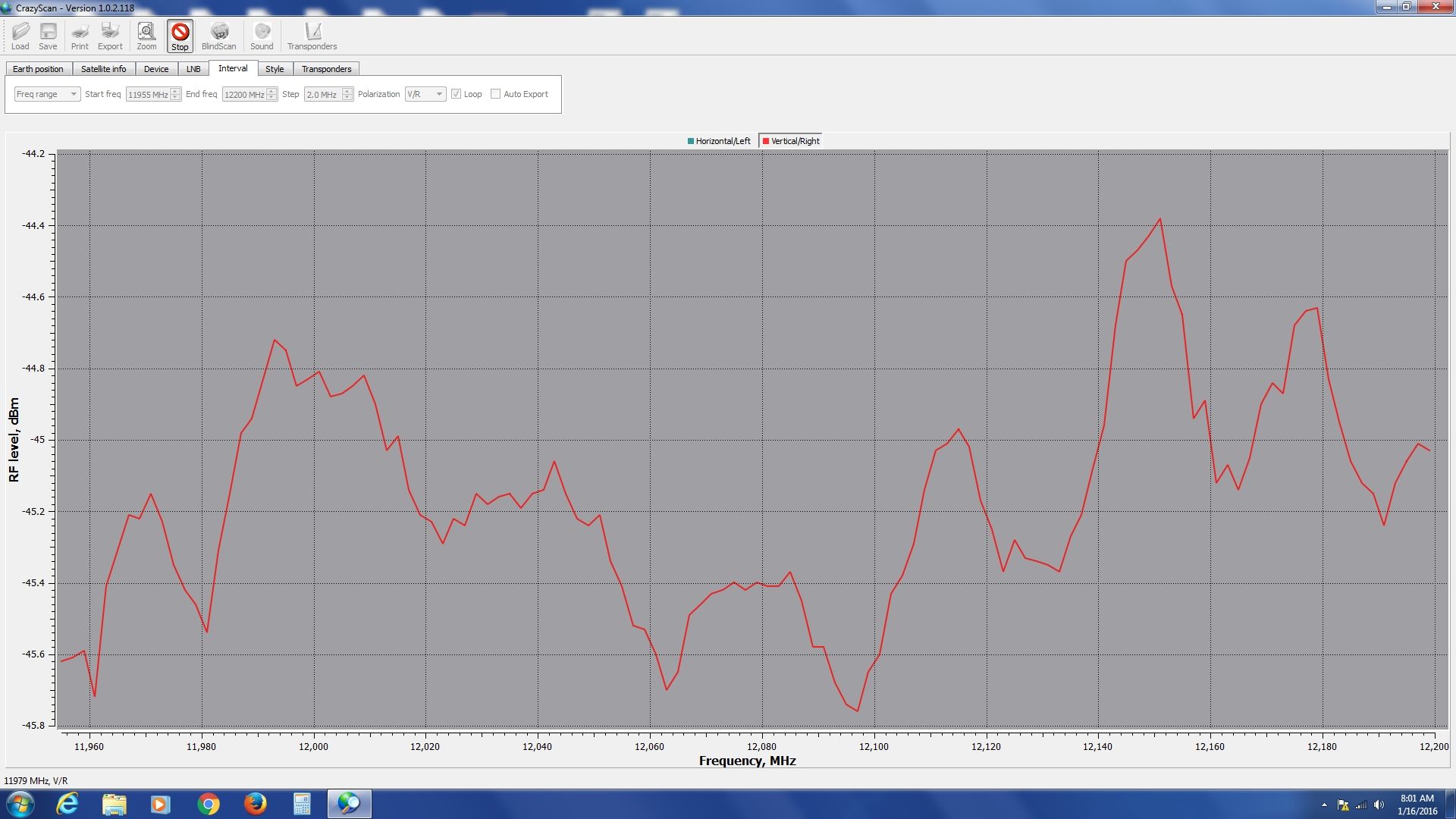

I wonder if someone with a clear shot at this bird and who has the use of Crazyscan can check this for me please. Pretty sure I'm on 67°W but there's no decent source of full transponder info this far west AFAIK. The most comprehensive site, Flysat which lists all the data and higher order transponders doesn't go this far west so I'm not able to compare my signals with any lists. It doesn't match Lyngsat but that's not up to date and it doesn't list data etc.

Unfortunately nothing that far west has European beams, 61 and 63W both have strong data transponders into Eu but what I'm seeing here on 67W aren't much more than bumps in the noise and don't produce any form of SNR or even show a constellation.
As you can see there's no sign on 12162V so I presume these are on the other American beam although that's confusing itself as 12162V is listed on the N America beam that doesn't cover Colombia particularly well, I'd expect that to be on the South American beam.

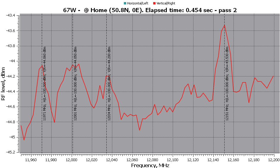

Not sure what you are seeing. Here is what I see at 67°W in North America. I also looked at the satellites I can see on either side of 67°W (63°W and 70°W) and didn't see anything that looked like what you are picking up. Maybe something getting into a side lobe as Fat Air suggest?
There's very little out to the west and I have to get to 30W to find one transmitting above 10.7GHz so I doubt it's a sidelobe but I hadn't thought of direct pickup off the back side although with a few exceptions we don't tend use your FSS band over here so it shouldn't take long to check. Some of our strongest sats can be picked up using 30cm dishes, in fact we had a D-MAC service called BSB running in the late 80s that used 30cm Channel Master dishes. Thanks for the plot, I think if you were to scan from 11950 up in vertical only so CS autoscales it you have the same signals but at similarly weak levels.
I'll do that in the next day or two and post the results

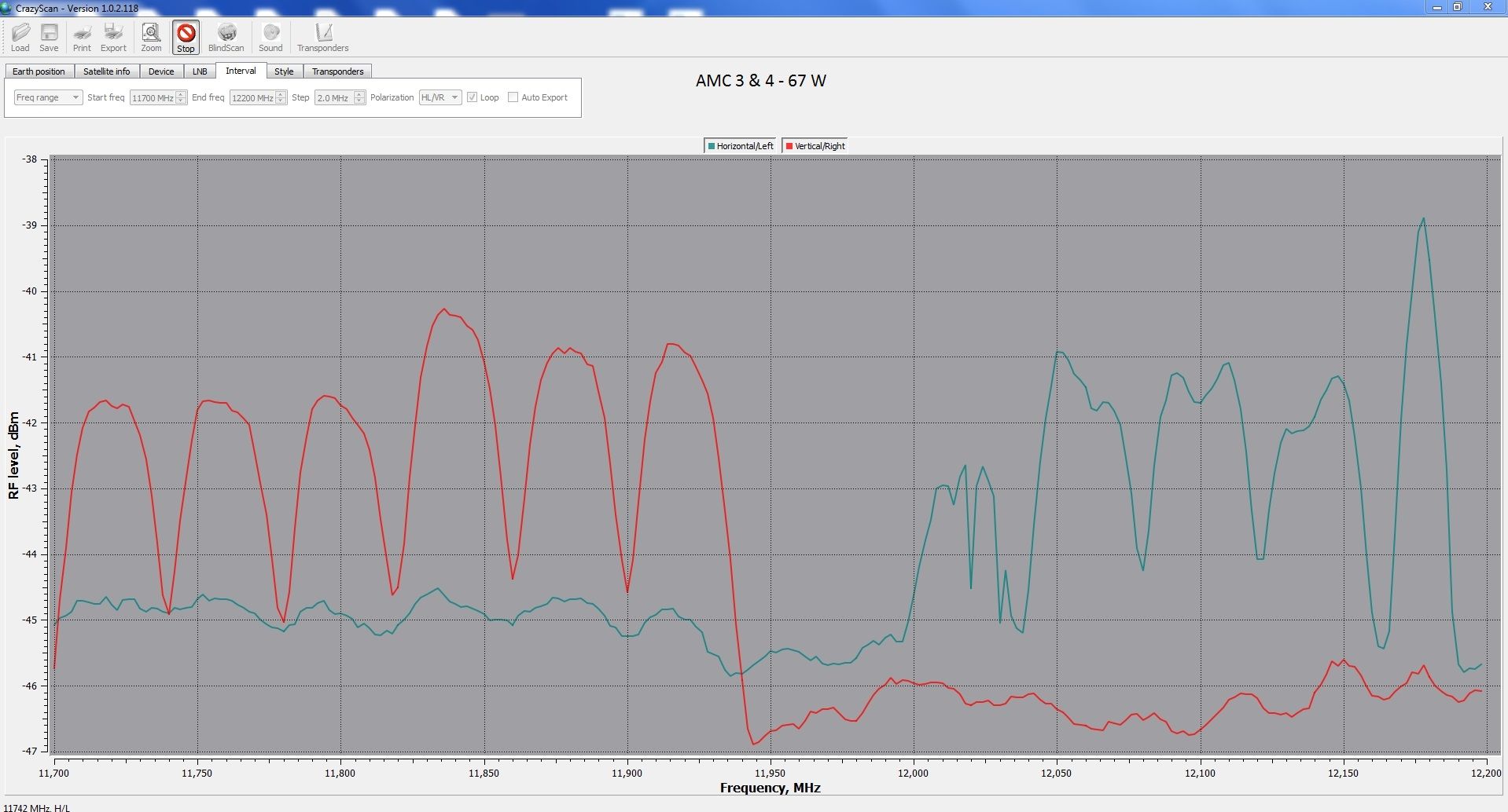

Here is what I see from 67°W. If this is from AMC 4, it must be on the Southern American beam.
Thanks for doing that, they're definitely the same peaks so at least we know I'm on the right satellite, it'll serve as a useful marker even if there's no hope of locking anything. Now if only there was someone in South America actively 'DXing' on satellite.
