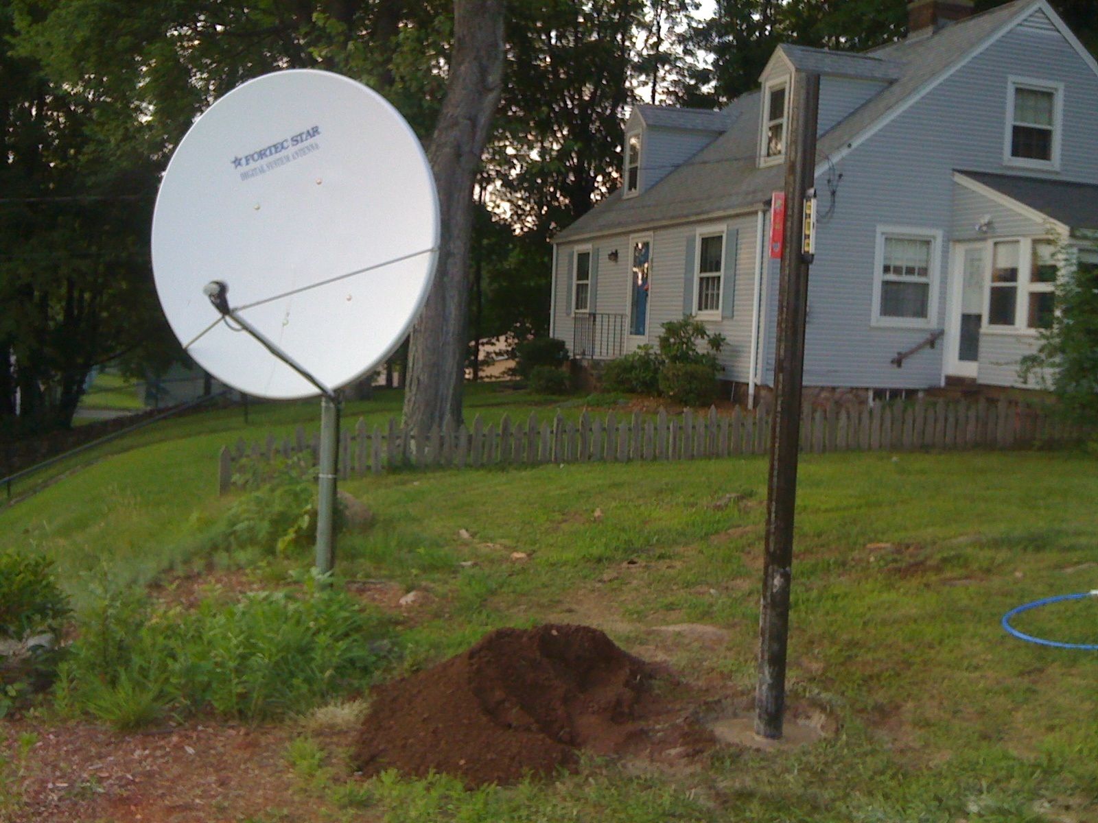

I got home from work tonight and got the shovel and started digging. I got down to about 4 and a half feet. The shovel wouldnt go down any more. The top of the shovel was at the top of the hole.

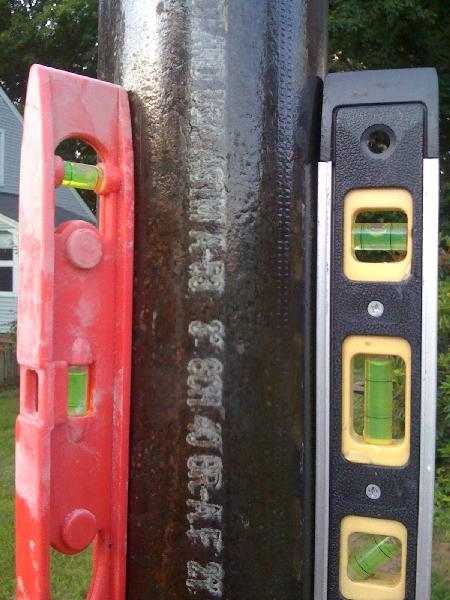

Dropped the pole in the hole, mixed the cement and poured the cement. Looking at the levels this thing is perfect.
After an hour of setting the pole is SOLID, and again the levels are perfect. :)
Now to let it dry the rest of the way... tomorrow night when I ge home from work its supposed to rain a bit so I wont plan on assembling the dish until the weekend.

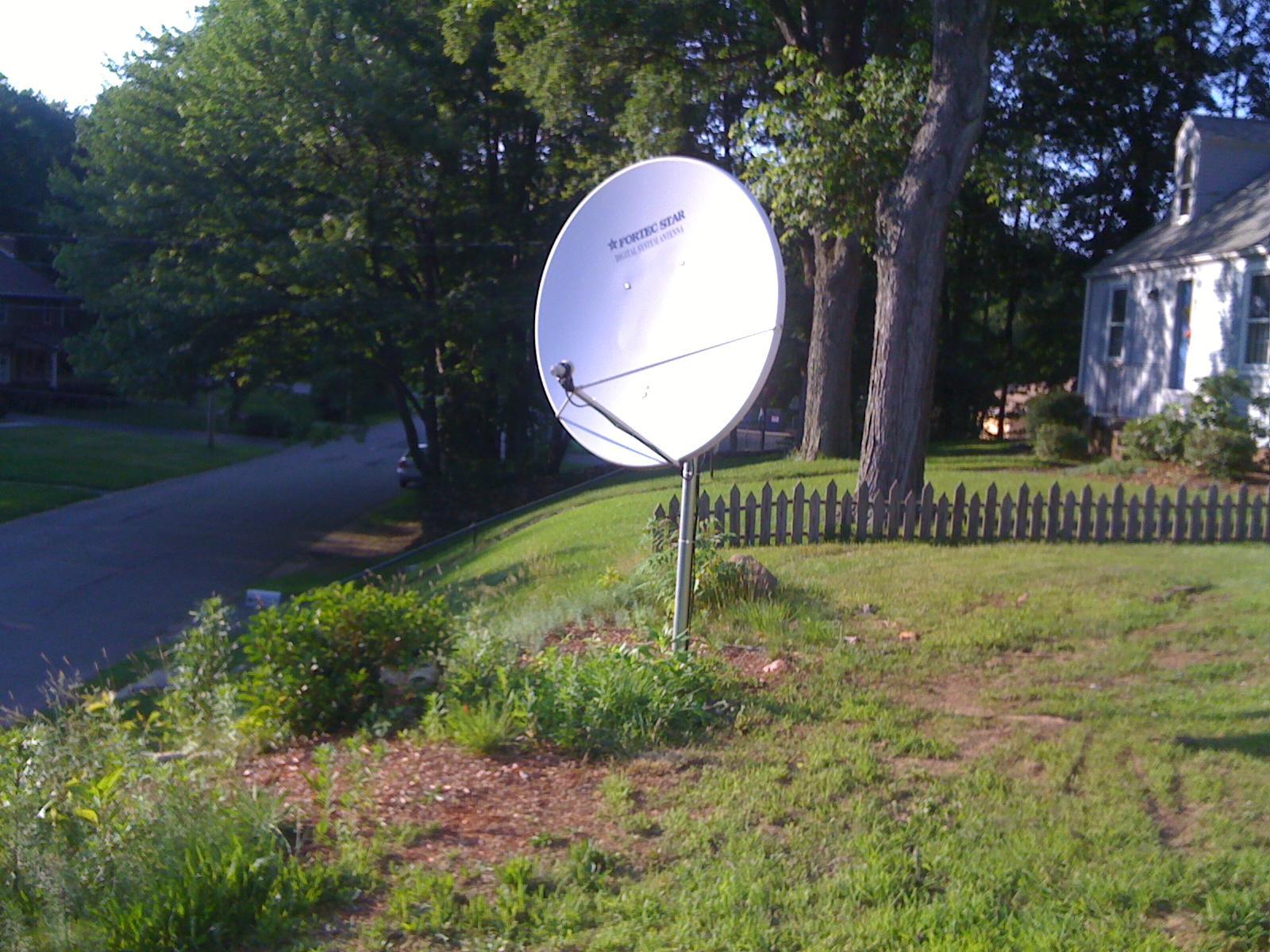

And here are some pictures. (BTW the Dish that is in the picture is a 1.2 meter Dish that my wife is making me taking down in exchange for the 8 footer. (2.4 meter) I will bw giving awat the 1.2 meter dish and motor later on this month as I will be having a SatelliteGuys movie night at the end of the month. :)

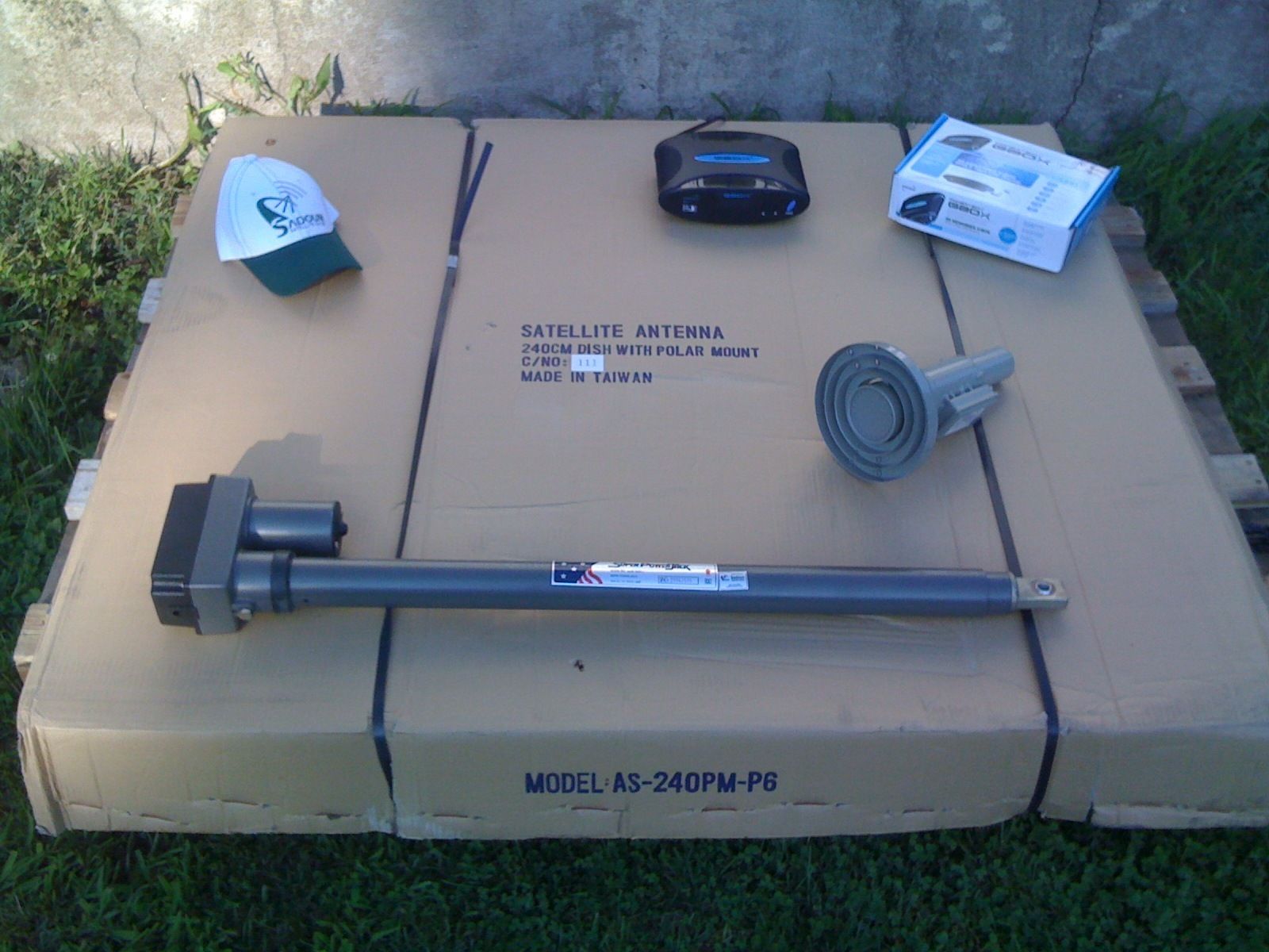

The Dish is the GeoSatPro 2.4 Meter Dish from SatelliteGuys Sponsor SatelliteAV. I have read a lot of great things about this dish
All the rest of the hardware is from Sadoun Satellite Sales, the equipment includes
VBOX
24 Inch Heavy Duty Actuator
BSC621 C/KU LNB
I was very happy that I was able to get this stuff fromtwo of our great sponsors. Judging by the posts lately, I have a feeling C Band systems are going to pick up. :)
BTW for the receiver I have an AZBOX and a Fortec mercury II unit. I would like to use only the AZBOX, but it does not have blind scan yet and I also dont know how the VBOX will work with the AZBOX.

Looks good. Now if you can just get that dirt fairy to come by for that extra pile of soil you have.
Hey didn't we used to have one of them around here?
been there; done that:
. . . got the shovel and started digging.
I put in a 40 foot phone pole some years back.
Ran out of shovel the very same way.
My local utility (electric power) guys loaned me a "spoon" shovel, with an 8 or 10 foot handle.
The business end was more perpendicular to the handle, something like a hoe.
I got to eight feet, and hit shale.
For then current satellite poles, I got a post hole digger with a compound clam.
It closes more for a little movement of the handles, than a regular digger.
But it sounds like you did fine with your shovel.
Looking forward to more pictures and war stories!
Keep up the good work! - :up
The dirt fairy will come tomorrow and cover in on top of the cement. I left about 4 inches there. I will probably get some conduit and put it going up the dish from the ground to make it look nicer. :)

Checked the pole this morning and all is great. The concrete is setting fine and the pole is still perfect on the levels. :)
I will give it a few more days to cure before going forward (mostly because the weather is not going to be that great the next few days) and I also have stuff to do after work. :)
