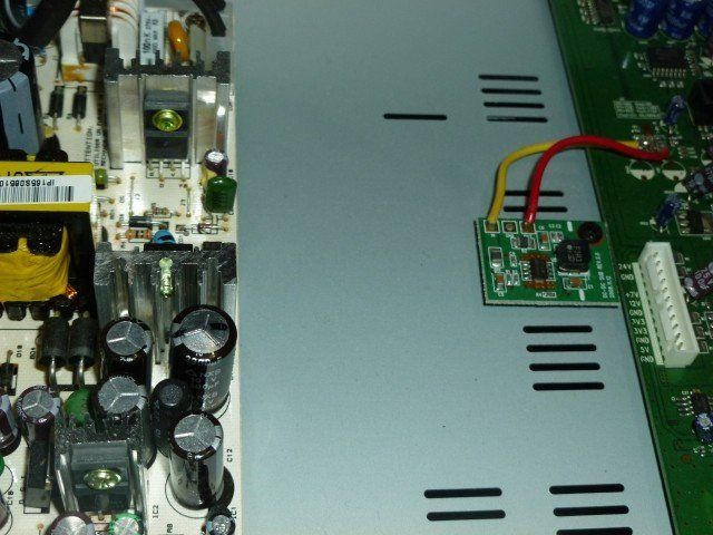

That capacitor may have been installed backwards at the factory for it to have failed so soon. Try to determine the polarity of the circuit before you solder in a new one.
It wasn't the JynxBox that has the bad capacitor but the old EBox receiver that failed. It was running 24x7 for who know how long but after turning it off, it won't come back on again. The capacitor with the black marker line on top next to the heatsink is the one with the bulging top. Hopefully replacing it will fix the problem. To the right there is a small board that looks like a DC-DC converter daughter board that is suppose to mount on top of the main board but had to be moved because some components is in the way. The strange thing is that the input and output wires is connected but the ground in between is not. I hope they are not using the case as ground.

Sorry if I was unclear. It is the EBox, the old receiver, that has the bulging capacitor. This problem is far from uncommon.
