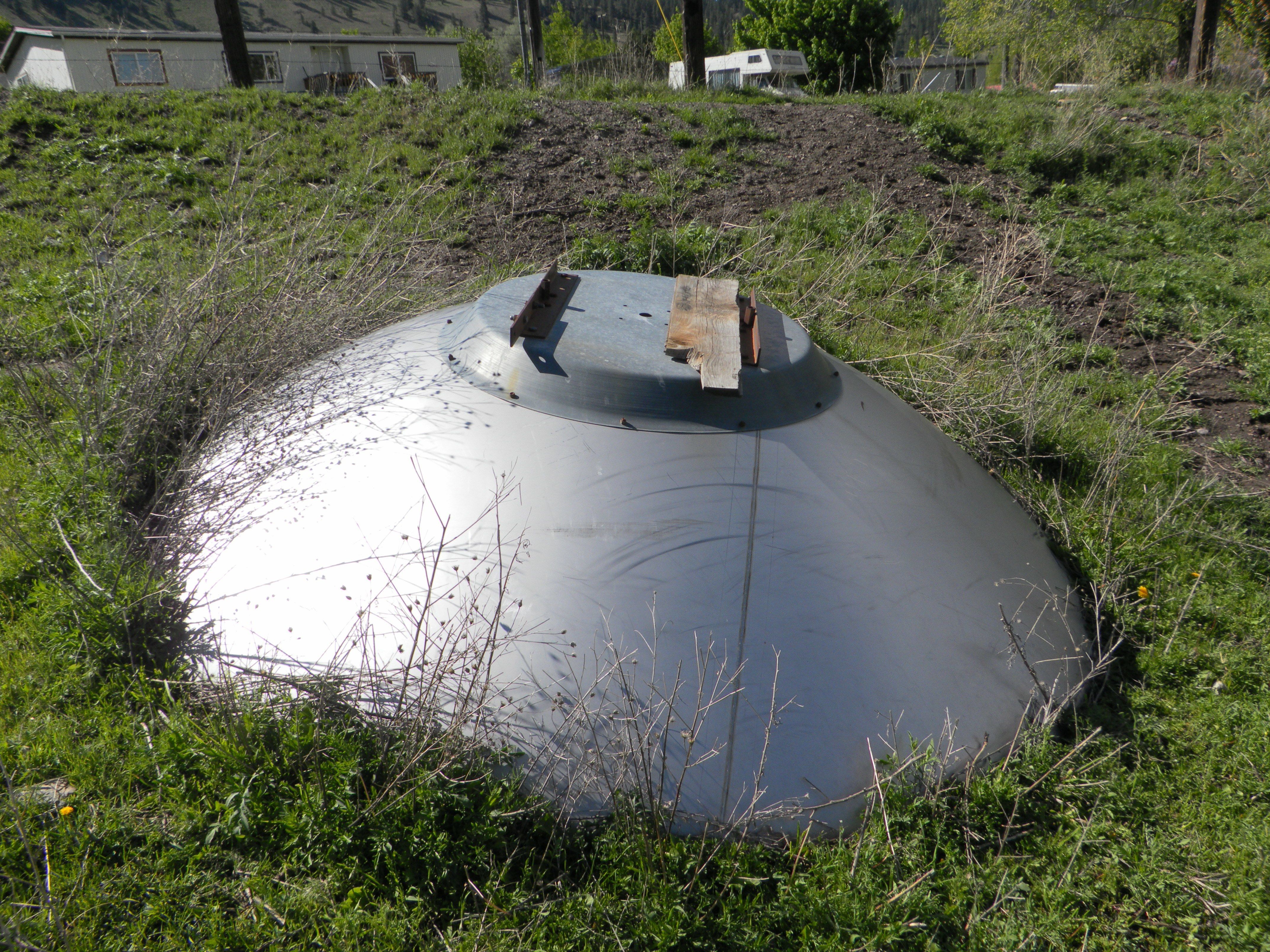

Here's one that wish it had a home. 300lb dish. Very deep dish too.

@ Magic Static - That it... If you can get it I would do whatever you had to do to get it home and set it up.

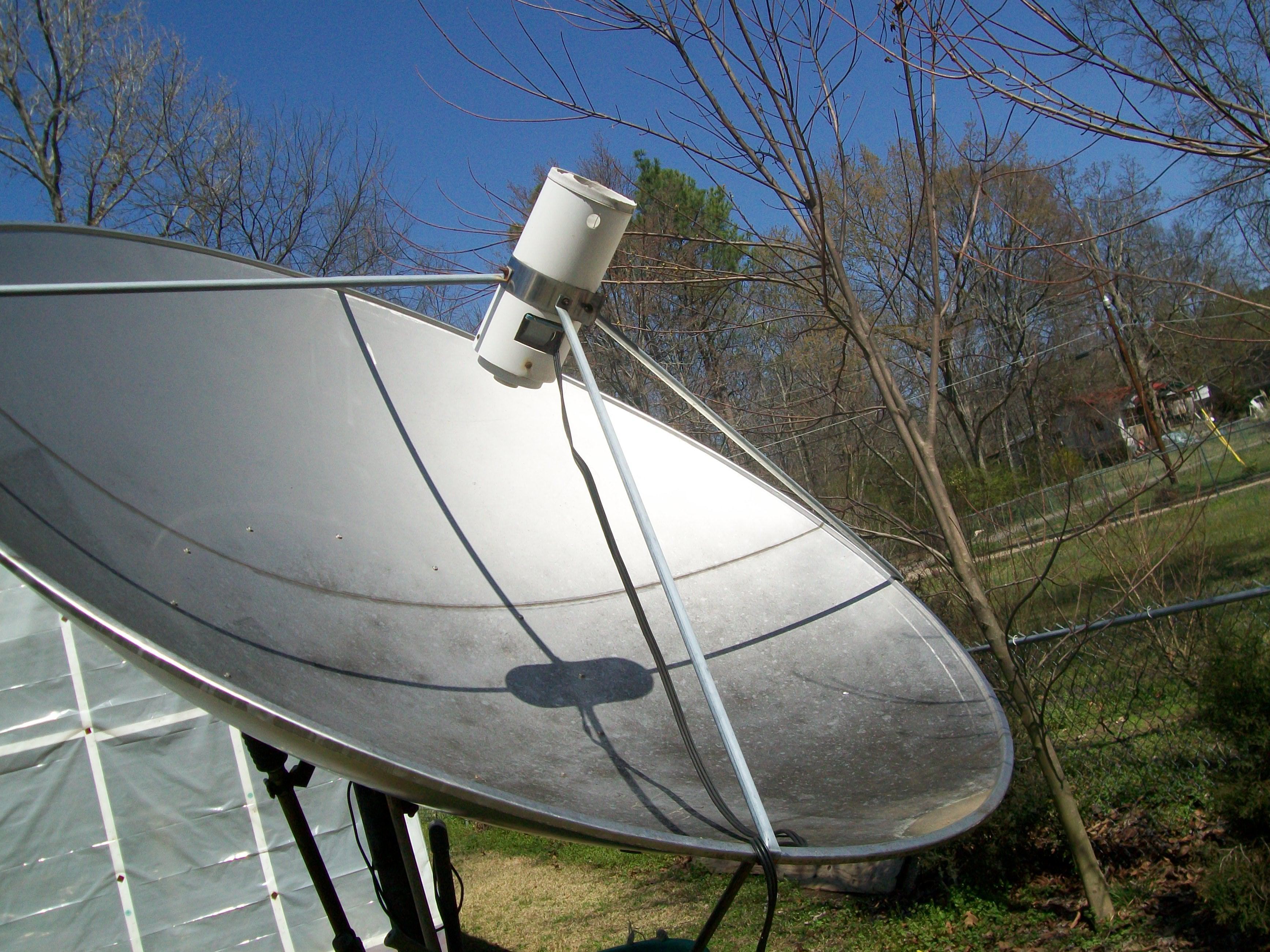

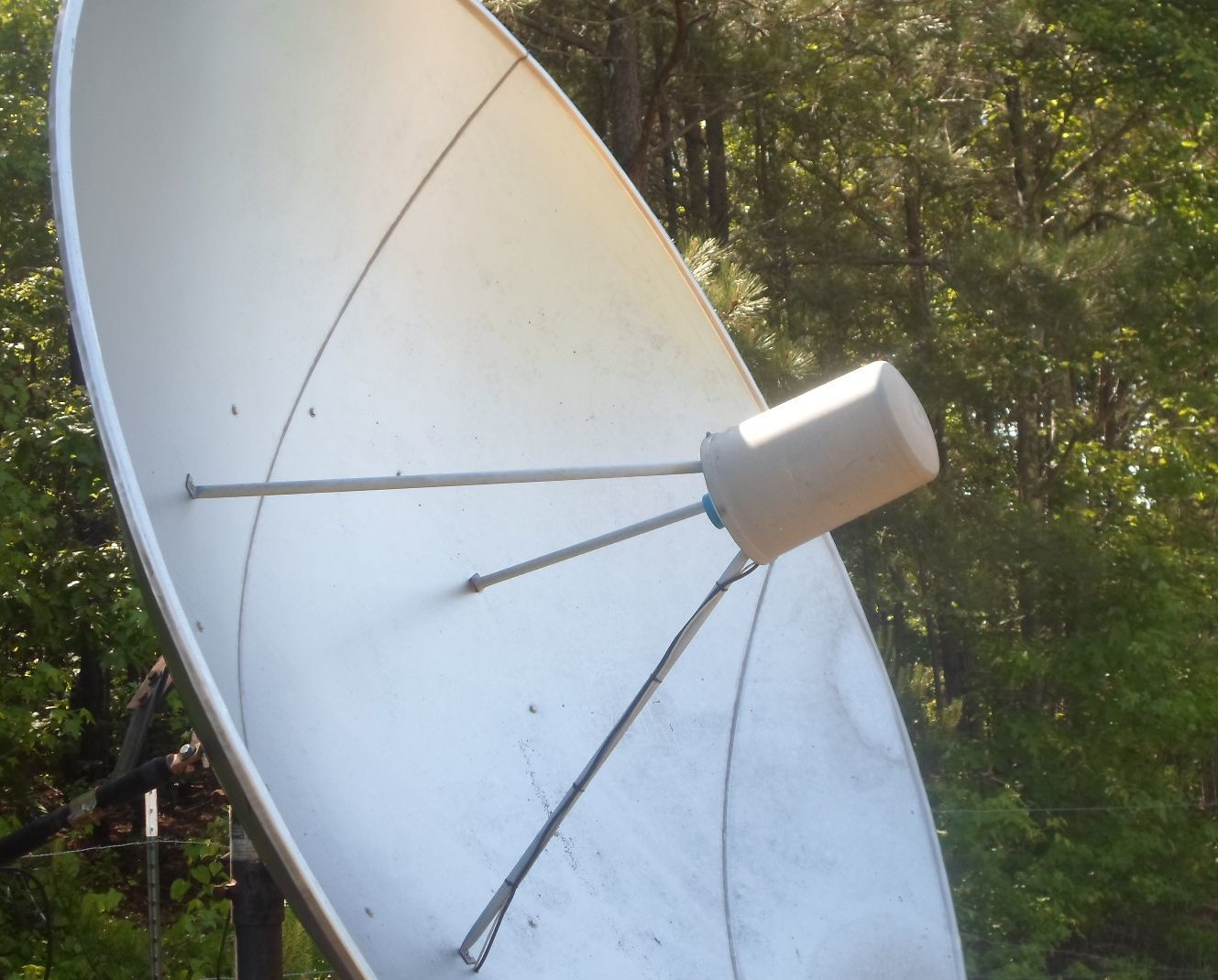

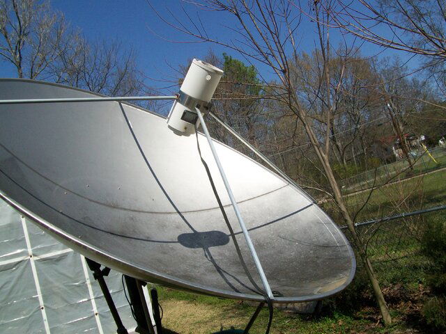

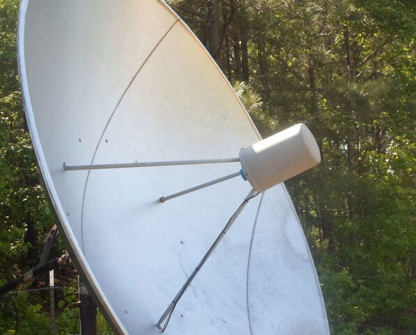

The SS120 is 120 inches (10 foot) funny thing it is actually 9.5 foot. I found mine two years ago. bought it for $50 - the guy honestly did not know what he had. There also a cool video on youtube showing how they made the dishes. search for Kaultronics and you'll find it.
The original design used the large support poles to support the LNB I modified it with the shorter version. much more stable..

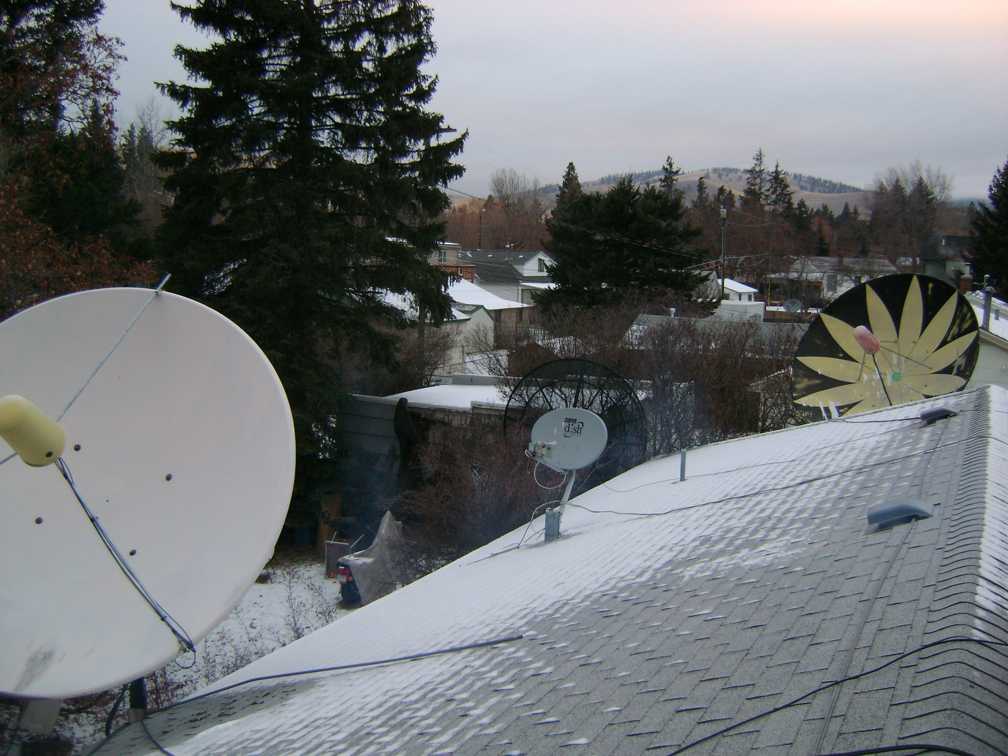

Here is one with a strut conversion and a little "Flower Power" ;)
The dish in the back.
And that SuperDish has been well converted, too. :up
As for the feedhorn support conversion, if the original had been sturdy, I doubt it'd have been a problem.
But I have no quarrel with the modification.
Probably reused the same tubing, and didn't have to buy any. ;)
Edit much later:
I see now how the modified struts go to existing bolts on the dish.
Bolts that hold the dish to that backing disc. Great idea.
If anyone is thinking about making this mod, heed these words.
The original Birdview struts are too short by several inches.
So it would be worth verifying the focal length of this dish before blindly cutting new support rods.
If calculations don't agree with whatever documentation you find, there is a way to make the focus adjustable.
Bend the ends of three (or four) existing struts/rods/tubes to mount to the existing bolt heads inside the dish.
Cut the tubes 4-6 inches longer than needed, and do NOT flatten.
Attach small metal brackets to the scalar, spaced to match your struts and sticking out from the scalar edge.
(tap my avatar, then zoom in on picture of dish)
Drill the brackets to take large conduit locking clamps, as shown.
Now, you can freely slide the scalar around, peaking it at the focal point.
We have much better bracket pictures than mine, somewhere on the forum, should ya need them.
