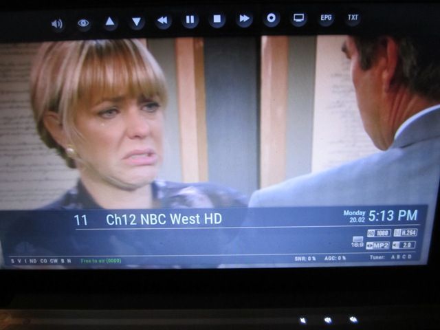

Was reading the 4K receiver thread and got inspired by Schicks4 and Mr3p. Decided to try streaming from my azbox to Kodi on my I5 laptop. Not that familiar with my way around Kodi, but managed to install the Vue/enigma2 PVR.
I was surprised how well Cozi and NBC West played in Kodi, pretty much flawless. Had a bit of stuttering with RT and NHK for some reason, mostly at first after zapping channels.
Screenshots: azboxkodi 002.JPG

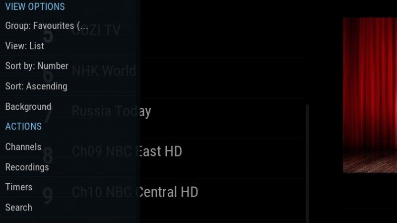

Easier for me to use the plugin. The pvr plugins are already in Kodi; just click enable, then configure. Put in Ip address of box then root/dreambox for user/pass and then name of bouquet which is Tv (Favourites). That's it. It scans the channels I have in favourites.
I realize your Azbox is not enigma system.
