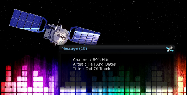

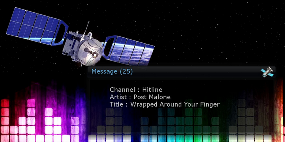

Well, since all the programming was 99% there, i added yet a new feature. This one detects when i turn to one of the Muzak channels and then automatically displays the Current Song Playing. When i stay on the channel, it will refresh every 30 seconds, and if the song title changes, will then display the next song information. The only modification i had to add to my program was instead of just being able to display a file, i made it so it can pull in a HTTP and decipher the XML headers to get the song information. (Functions that already existed from other programs i wrote) Took me less than 30 minutes to add-in , and now, i don't have to ask "What song is that?"

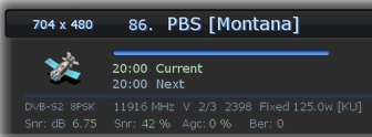

PBS Montana as an example : Even though i have EPG data for PBS montana, that signal sends a junk epg information referring to whats on now/next. It overrides my EPG data in the info bar and shows Current and Next. But, i was able to modify the python script within the system files of the satellite receiver watching for junk data. As you can see in the second image, it now shows my EPG data instead of the junk data that is within the satellite stream data.

This isn't a waste thou, due to the fact i have fixed the DummyEventName/Current/Next issue - so ill no longer see those silly junk text any more instead of the intended EPG. It is a fairly easy fix, and if interested, ill tell you how to modify the python script to resolve that. - You will want to save the modified python script as a backup somewhere , as if you ever update images, that file might get overwritten, in which case you re-add the patch.

However, i have left my tuner tuned to 80's channel for hours, and its nice to see the message box popup at every new song. -- But, its all done OUTSIDE enigma2.

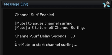

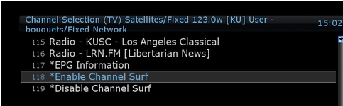

I added another feature to my program. I just added channel surfing. If i tune to a specific channel that i named "*Channel Surf", it then mutes the volume and enabled channel surf. As an example, i can then jump to 97w KU, and tune to the first channel. I then un-mute and the STB will cycle through all the channels. If i hit the mute button, the channel surfing will PAUSE. When i un-mute, the channel surfing will resume.
If i cycle the mute on/off 3 times, it will disable the channel surf with a screen notification. It can be re-enabled within 30 minutes without having to tune to the *ChannelSurf channel by cycling the mute on/off 3 additional times. - I thought that feature was pretty slick.
It is time delayed between channel changes at 10 seconds, although it is a configuration option to change that.

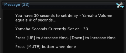

Update... I made a few tweaks here and there. - Just because i could, when you turn to the channel that turns on channel surfing, it MUTES the Satellite Receiver, and UN-MUTES the AVreceiver. It then sets the VOLUME of the receiver (remember STB is muted - messing with the av VOLUME wont blow the ears.) to match the SECONDS delay, It then sends a message to the satellite receiver telling me i have 30 seconds to set the volume of the receiver to match the # of seconds i want the channel delay to be. So, i then set the volume of the AV receiver to, for example, 30, and then i hit the mute button to let it know I'm done. It then sets the channel change delay to 30 seconds, and then resets the volume of the AV receiver to what it was before and then un-mutes the satellite receiver. - It then saves that channel delay for next time, so that if i don't want to actively change the delay seconds, i just hit the MUTE button and it defaults to the last set delay.
If i just want to pause the channel change because of a bath room break, i just hit the mute button. It will pause as long as it's muted. But, if i want to actually pause so i can watch the same channel for awhile with sound, i then toggle the mute 3 times within 10 seconds, That will disable/enable channel surfing. I can leave it paused for up to 30 minutes before having to re-enable by going to the *Enable Channel Surf Channel.

When i get the last message, i then close out that message and go to the channel list i want, example 97w KU, and click on the 1st channel. I then click to un-mute the sound, and in 30 seconds and there after, it advances to the next channel. When its reached the last channel in that list (ie boutique/favorites or particular satellite, or particular transponder) it jumps back to the first channel in that list and repeats until i stop it or we have a power failure. :)
