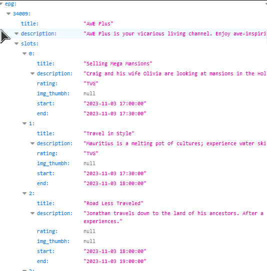

Regarding the AWE - A wealth of Entertainment channel on 117w KU. Has anyone found an EPG that actually matches whats on? Even the AWE website doesn't appear to match whats actually 'Live'. I just watched Dream Cruises, and now its Travel in style, and there is NO pairing in the EPG that shows dream cruises and then Travel in style, and even seeing those shows separated on the page aren't even the same episode to whats actually 'Live'....
Sources I've thus tried :
Is this because its reported as AWE Encore/Plus? Which might be different? But, EPGs i find for that appear to be the exact same line up so far...
I can't find a schedule that matches AWE Encore. We receive AWE on our Eastlink cable channel. Its schedule matches your International schedule. But it differs from AWE Encore. I suspect AWE Encore is a clever way the owners of AWE can sell the same product to distribution systems who offer AWE for free to viewers as they offer to pay TV systems.
And then...what is AWE Plus?
I never found a schedule for AWE Encore. Only thing I did find was that it seems it is basically a streaming channel. Could be that on some of those streaming systems there might be a schedule, but probably only accessible if you have that system.
AWE Plus is the same thing as AWE encore. I believe i found a EPG for it...
Selling mega mansions is on now, and if travel in style is next re Mauritius, ill have found it. If it checks out, ill program it into my EPG software and get it live on my Enigma2 STB. I found what appears to be a matching EPG via AWE Plus | DistroTV Live Channel .... and by studying the html, found where they get it from, and below is the result of that, i was able to specify the number of hours to fetch, such as 24 or 48 hours etc...
*Update - It is a match. If i don't have EPG, i almost never watch the channel, so this will give this channel a chance...

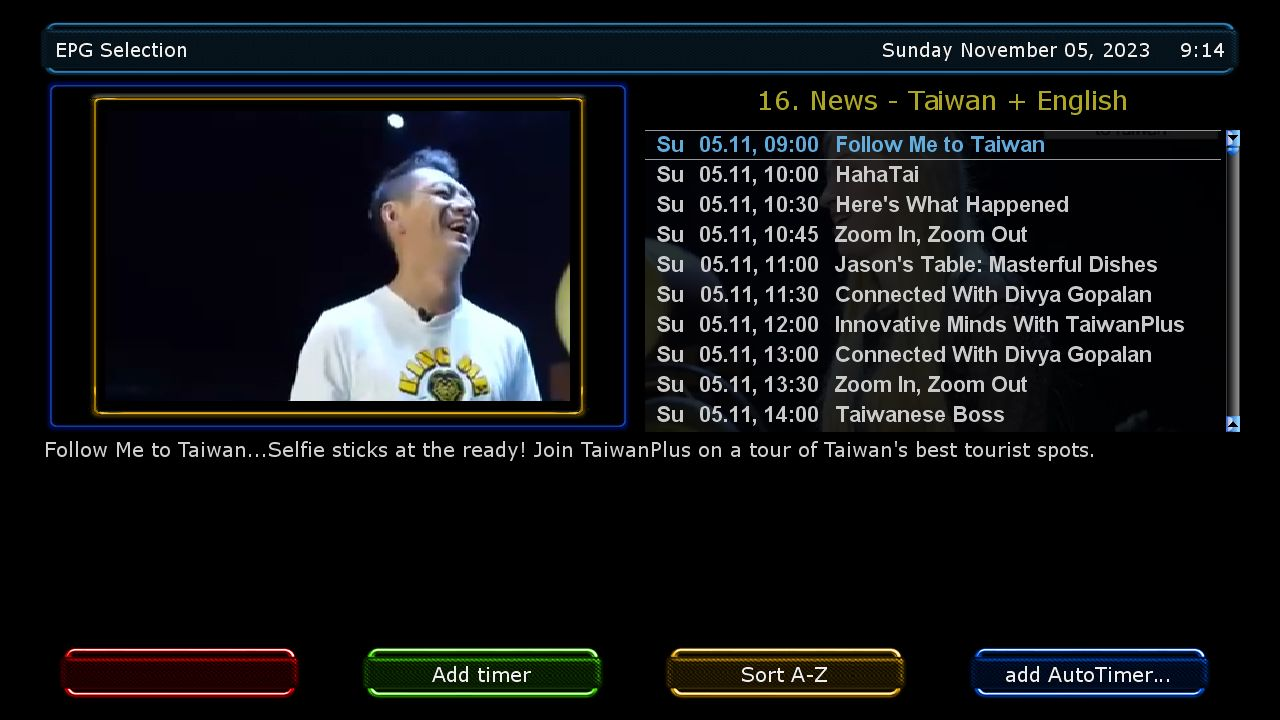

Darn, im getting quick with this.. Deciphering TawainPlus website for schedule data was easy as it was in json format, much like awe+. So, i just duplicated the AWE function i created , and made a few tweaks, and wala, I now have Taiwan +.
I now have full EPG again! Yea!!!

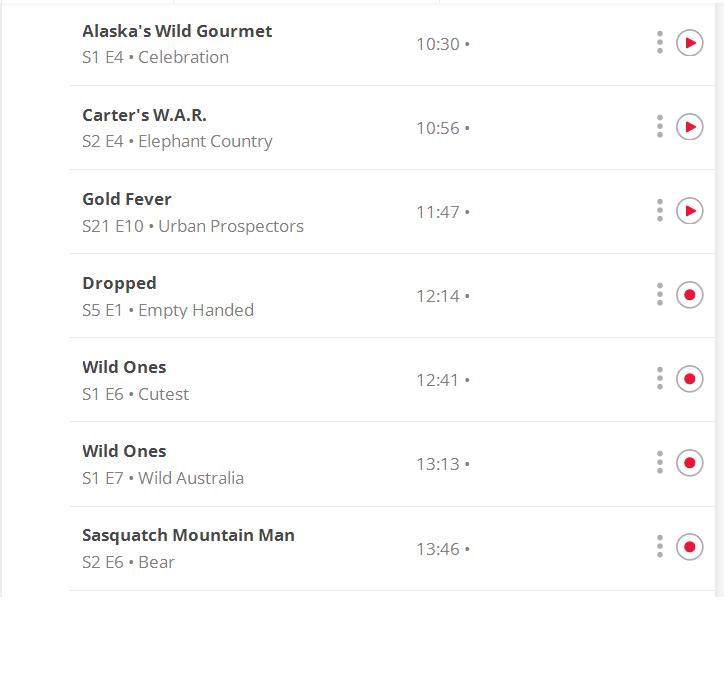

Teleboy.ch has the wrong TIMES! which was nicely formatted in JSON.
TV listings – Wedo Big Stories - Teleboy (Times mismatched)

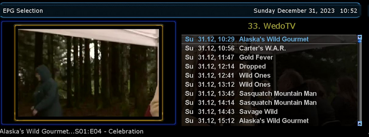

Had to get it directly from Wedo, but the nice thing - It supplies 5 days of EPG.
https://en-gb.wedotv.com/channels?program=wedobigdocs (Accurate)
I now have EPG data for Wedo Big Stories
The start times are bizarre (not aligned to top of hour) , so definitely need EPG data for this channel!
Interesting. For me, teleboy.ch times are accurate, and when I view the wedo site, I only get a screen with 2 hours of programming (could be my system/browser, who knows).
Glad you found something that works for you!
Are you sure the minutes are correct for you? - The correct shows, in the correct order, but if you look at the times, they are not correct for me. They are off by 20+ minutes of actual start/stop times.
Regarding wedo site, yes - your correct, the viewable website only shows 2 hours of programming, but the html code within contains 5 days of EPG...
Hmm, maybe i screwed something up in my URL call. I did try to omit as much as i could , so, maybe i took something out that i needed.. I'm not gonna bother with it unless i have issues with the current.
